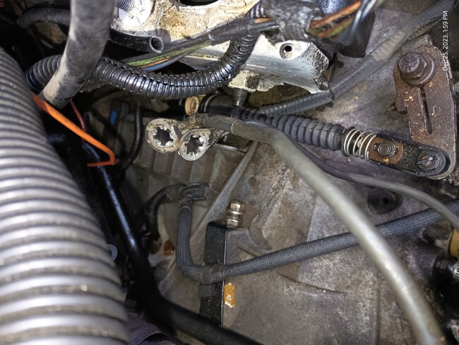

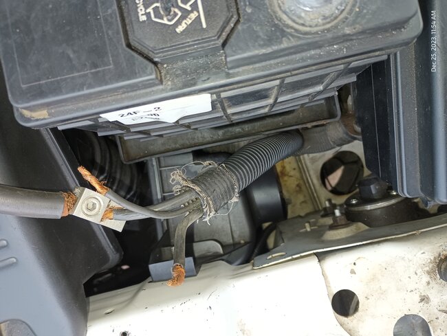

The photo shows what the alleged "professional mechanic" left me to cause major problems, disconnected engine main ground wires!! The car was in limp mode so weeks of searching for the cause, replacing an alternator that was blown out, and now getting a sparking upon connecting terminals to the battery i came to the conclusion that i have a shorted out hot wire grounded in my harnesses someplace.
How can i simply remove each individual section as a whole to check for the hot spot/fried wiring that's grounding? Can they be removed individually? I know on the driver side of the engine compartment several harnesses are connected by locking connectors.
I don't have detailed schematics to show me what harnesses go where or where the grounding points are (only that there are ground points). I only have the simplified schematics from a Haynes repair manual. That mechanic has cost me almost double what the transmission swap and labor combined did so i think I'll handle this myself locating/repairing the wiring short.
I already replaced the alternator, TCM, and won't be able to check for other damages this has done until i can hook up the battery without the shorting out problem. I'm assuming from experience the "no ground" caused the burning out of one "hot all the time" wire feeding power melting the insulation grounding it to either body work/frame/ground wire(s). I need help here.

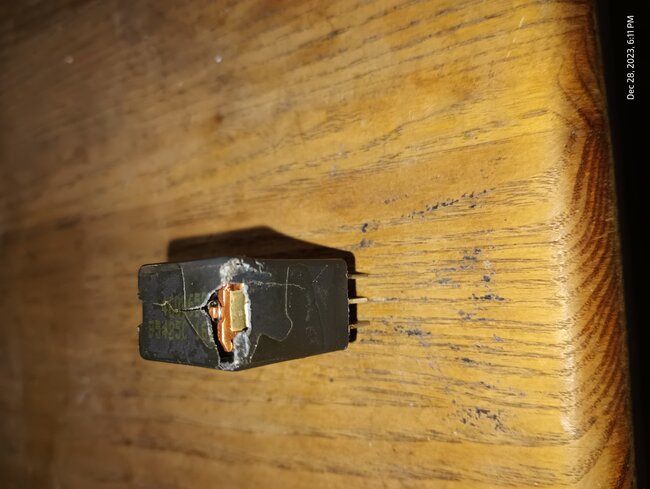

Rather than buying new relays, you can get dozens of them from any salvage yard. They have very low failure rates, but it's always one of the first things we say to swap or try because it's a quick and easy step. Some of the yards around me will fill coffee cans with fuses and relays from cars about to be crushed, and sell those for $10.00 to $15.00.
If you want to simplify this, remove the transmission relay and the automatic shutdown, (ASD) relay and set them aside. The transmission won't shift and the engine won't run. That lets us concentrate on just being able to connect the battery and get other circuits working, one at a time.

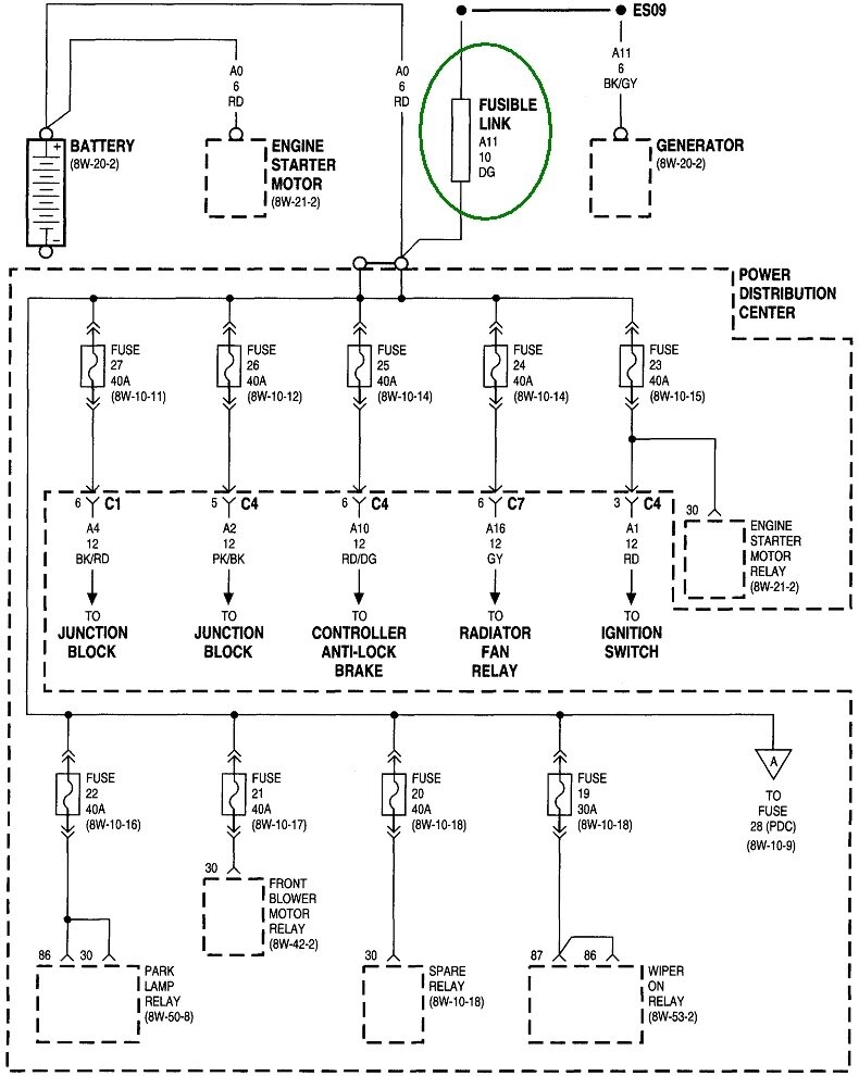

The only fuse link wire I can find in the diagrams is shown below. It will be a 10-gauge dull dark green wire spliced into the wire going to the output stud on the back of the alternator. All "AC generators", ("alternator" is technically a Chrysler term), have a minimum of six "diodes" in their output circuits. Diodes are one-way valves for electrical current flow. When the engine is off, those diodes are in the circuit backward, making them "reverse-biased" or turned off. Those are what stops the battery from seeing a dead short and discharging through the alternator. If the battery is connected backward, as we read here much too often, those diodes will be forward-biased and act like pieces of wire. The only thing limiting how fast the battery discharges is the diameter of the wires, and the fuse link section is the smallest of those, so it is going to get the hottest just before it burns open. You will get that shower of sparks you described when connecting the battery. If you put my light bulb between the battery post and its cable clamp, it will light up full brightness. It will dim if the fat wire is unbolted from the alternator. Rather than wasting time with those steps, it makes more sense to just connect the battery correctly.
To test a fuse link wire, tug gently on it. If it's burned open, it will stretch like a rubber band. If it's good, it will act like a wire. When one is burned open, if the two halves are long enough, you can splice the ends together. As long as any part of the wire is intact, the safety valve feature is still there. You can also buy new ones from any auto parts store. The color denotes its current rating. You'll get a piece about 12" long which is enough to cut into two or three pieces to make multiple repairs. Don't use regular wire. The insulation on fuse link wires will always be a dull color and is designed to not burn or melt. The length of the fuse link wire is not important. This is the weak-link-in-the-chain. A half inch of this wire will do the job, so a one-inch piece will be like having two weak links.
When the battery has been connected backward, expect to find a lot of blown fuses in the Power Distribution Center, (PDC / under-hood fuse box), and in the Junction Box, (JB / fuse box in front of the brake pedal). There's a lot of computer modules on this van that can't tolerate reverse voltage. To address that, they usually have more than one 12-volt feed wire and all will have a reverse-biased diode inside, between the 12-volt supply and ground. Those diodes do nothing in normal operation, but when the battery or jumper cables are reversed, those diodes become forward-biased, act like a dead short, and cause the appropriate fuse to blow, thereby protecting the computer. Most often simply correcting the reversed connection and replacing the fuses is all that's needed.

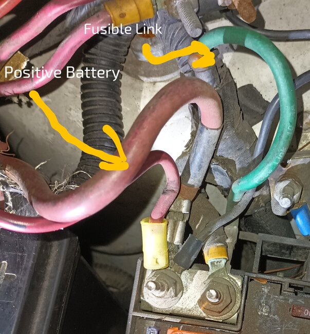

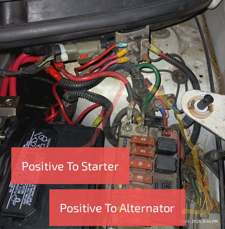

No, that fusible link (dark green) sits just above the PDC and is the only one in the system, connects to a multi-hookup in the PDC with the main battery power wire from the terminal. That's the one that got hot AFTER I got the engine grounds connected back up. Prior to that one of the ground wires (see photo) that tied into the extension wire from the Negative terminal completely fried off. In that photo is the Main terminal ground, a medium ground that has 2 smaller system grounds (blk/lt blue sensor grounds, blk/tan the PCM ground) linked to it to a ground point under the battery stand, and a smaller ground that is attached to the ground point too. I have a new single piece cable coming tomorrow too because I bought new terminals that don't connect like the old version do.

I think I'm getting a better picture of this.
"Connects to a multi-hookup in the PDC with the main battery power wire from the terminal"
I think you're describing the two wires tied to one point right under the green circle I put on the diagram, is that right?
"That's the one that got hot"
Clear this up. Was it the battery cable or the fuse link that got hot?
I completely overlooked the two splices right above my green circle, (ES09). Those indicate additional wires are spliced in there, but they aren't shown because they aren't considered relative to that part. I'll need some time to dig through the diagrams to figure out what is connected there.

The fusible link got hot nothing else. And the diagram didn't come through.

Big red is to battery, Fusible Link is fat dark green. This is a disability conversion van, so a lot of funky wiring tied into this area, but I've capped off most of all I've found because it'll be removed. Some wires go to toggle switches that some mechanic around here did long ago and messed it all up. None of those wires have been touched. None are hot because I wire nutted them off unless the tranny mechanics messed with this stuff too which wouldn't surprise me in the least.

I searched through all of the diagrams last night but couldn't find any second reference to splice ES09. As best I can tell, that is the splice for the fuse link wire. I know from previous experience that alternator output wire doesn't go anywhere else except back to the battery, or to there through the fuse box. My mind is telling me the same thing as before. If that green fuse link wire is getting hot, current has to be flowing through the alternator to ground, and that means at least two of its six diodes are shorted. Remove that wire from the back of the alternator, then see if you still get sparks or if the test light is still bright. If indications are the high current is gone, leave that wire off for now, then let's work on what it takes to get the engine running.

I am going to be tracing the alternator cable, but I would like to see if there's a diagram out there that shows where the harnesses are supposed to run inside the engine compartment. I suspect that the alternator cable as the schematics show runs directly to the fusible link (dark green spliced in the photo) that ties in at the PDC. I know that the harness from the PDC runs under the PDC, under the battery stand and tied into the main harness in front (already tore down and checked) then branches off towards the back of the car across the transmission, splits off again and then (guessing here) over to the alternator along the backside of the plenum held up by metal brackets. Given good weather I will be removing the windshield cowling to get access to the back of the plenum. I saw it was inside fire resistant sheathing everywhere I looked so far. It's still shorting and the fusible link is still getting hot, so I have no choice but to locate the break or weld to ground.
In the charging system schematic if you follow the connections, you'll see that fusible link also ties in the 6-gauge starter solenoid wiring, so I'll be looking at that after the alternator. This is taking a long time due to the weather and my having to do this outdoors by myself. I ran a continuity test on everything by the way and the most highest probability is that alternator cable.

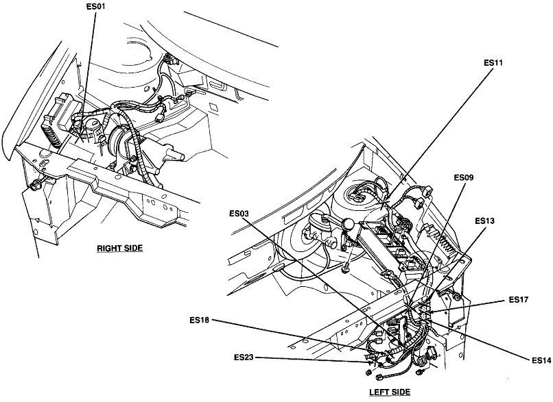

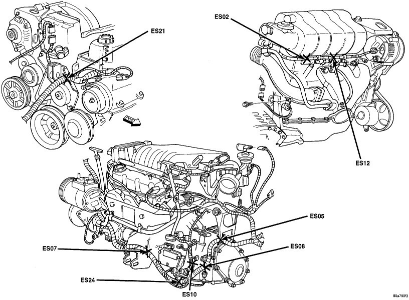

The alternator's output wire doesn't go to the starter solenoid. GM did that a lot to save wire. Chrysler never did, in part. I suspect, because the starter and alternator are on opposite sides of the engine.
There are drawings that show the wire harness routing. I found one for the engine and one for under hood. I don't normally use these, so you'll have to see for yourself if these will be of help. These are actually meant to show splice locations, not where each wire runs.
Feb 5, 2024 at 5:27 AM
SANDSTORM1958
  • 35 POSTS
That's what I needed. Particularly the top right and bottom right ones.

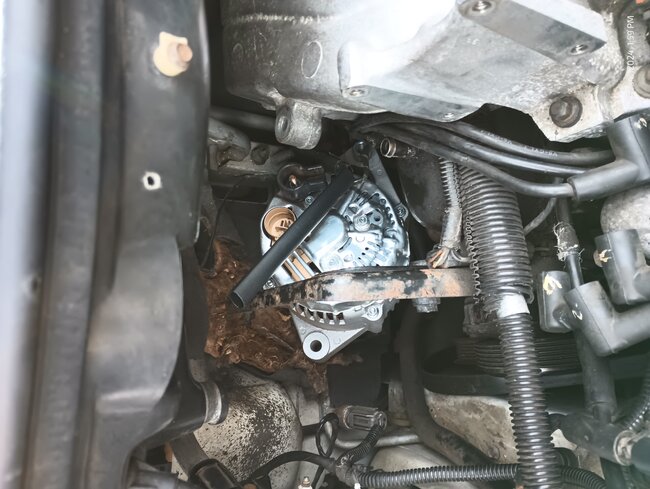

I undid the stud nut at the alternator and disconnected it as you said. Since one of our local "mechanics" ran that test I just skipped over that and went directly to connecting negative cable to battery. No Sparks, No Short Burning Wires At Top Of PDC. I removed the ASD Relay, and it cranked fine. Seems the only time all this shorting is going on is when this new alternator is fully installed. Defective diodes in the alternator maybe? I'll stop where I'm at searching for the shorted harness. I have had decent weather for a few days so will wait to see what you say. By the way, in this car you have to dismount the alternator, or you can't get to the wiring stud and connector plug because of the DIS, PLENUM AND ALTERNATOR HOLD BRACKET. See Pcture.
Feb 8, 2024 at 3:09 AM
CARADIODOC
  • 34,367 POSTS

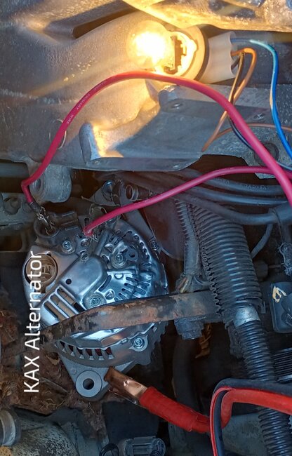

It does sound like there are shorted diodes in the alternator. I'd love to do an autopsy on it to see what happened. They are in two sets of three diodes. Any one in each set has to be shorted, (two in total), to have a dead short to ground. It seems like that is not the case because the fuse link wire would have burned open right away and that would have been the end of it. Instead, you have that fuse link wire getting warm which indicates current is flowing through it, so it can't be burned open.
If only one diode is shorted, which is not uncommon on any brand, you will lose one of the three output phases and two thirds of the units output current capacity, but the diodes in the other set will still prevent reverse current flow when the engine is not running. That means the fuse link wire would not get warm.
The only other thing I can think of is there is a small capacitor inside connected between ground and the output stud. It's identical to the condenser used a long time ago with breaker points. In the alternator, it's purpose is to reduce buzzing on AM radio. It's extremely uncommon for a capacitor to short, especially in this application, but we are looking for something unusual.
What I would do first is reinstall the ASD relay, then the engine should start and run. If it does, turn it off, then use my light bulb trick with the bulb between the alternator's output stud and the output wire. Use a small bulb, like a 3157 brake light bulb. It should be off completely; no faint glow or anything because the diodes are supposed to stop reverse current flow. If the bulb lights up, there is definitely something wrong inside the alternator.

I'll do your bulb stuff, but I'll try one better (my opinion) since I still have the alternator, I took out at the start of this. I'll put it back in and ground it to the mounting bracket then put the power cable back on the stud. Hook the negative cable back up to the battery and see if it does it like this alternator connection has or not. That overcharging alternator WAS NOT doing this stuff, it only started after I installed the new alternator. I found a weird thing out about 5 years ago on my '98 Grand Caravan Sport when my dash went buggers nuts then out. Searched top to bottom for loose connections and even resoldered the joints on the module board but nothing worked. Then I ran a test on the alternator, and it was bouncing around in voltage but never above 15 volts. Took the alternator out and replaced it with a junk yard one from another Chrysler we had the same year, model. Solved the problem. Turns out when the alternator began acting up the internal voltage regulator was in conflict with the voltage regulator chip in the PCM, so it put it in Safe Mode. Chrysler never knew about the conflict between the chips apparently because no dealer mechanics could tell me about it if it had been published. Anyway, I'll sway both tests and see what happens. By the way the fusible link got more than warmed. I saw today the outer insulation is spotting meaning the heat got pretty intense. I have new links of 10 gauge it calls for I just don't much feel like soldering the splice. I'll snip it far enough off the splice so I can strip and crimp together the new one that's already pre-ended with a loop for the stud on the "T" plate it connects to.

Got the electrical issue resolved. As you'll see the KAX alternator fired the light up big time. I got a brand new Gladiator alternator which arrived this morning, but before I installed it I recorded the testing of it to shove in the faces the people who sold me that junk KAX and won't honor their advertised warranty. Link to the video:
https://youtube.com/shorts/IsE7t7aoFFc?si=_PzIuN3MUKutjQim
Power is working fine but I think I'll change that fusible link later on just to be safe. It got hot too many times in my opinion to trust it. I don't care much for how Chrysler hooked it up to the PDC either all soldered onto the plate making replacing it difficult.
