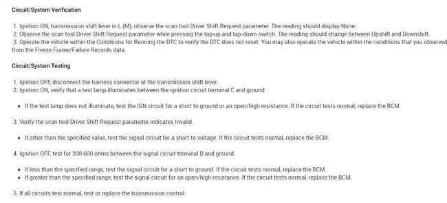

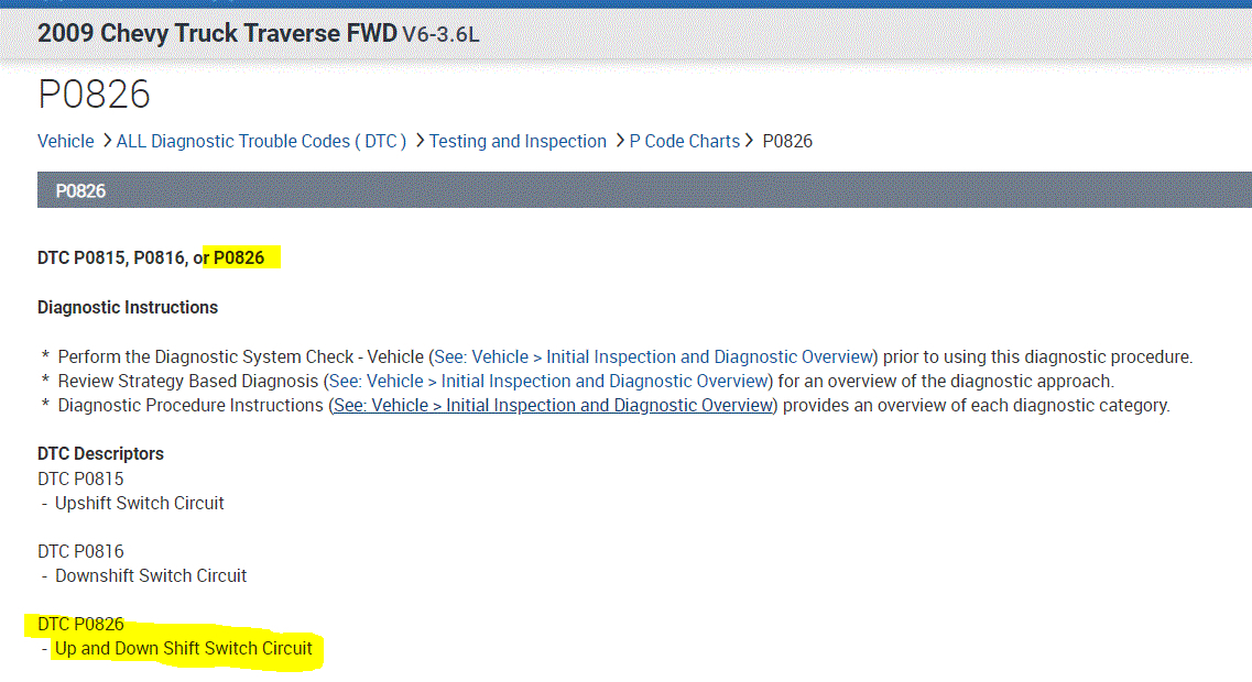

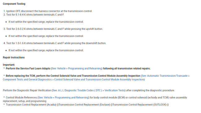

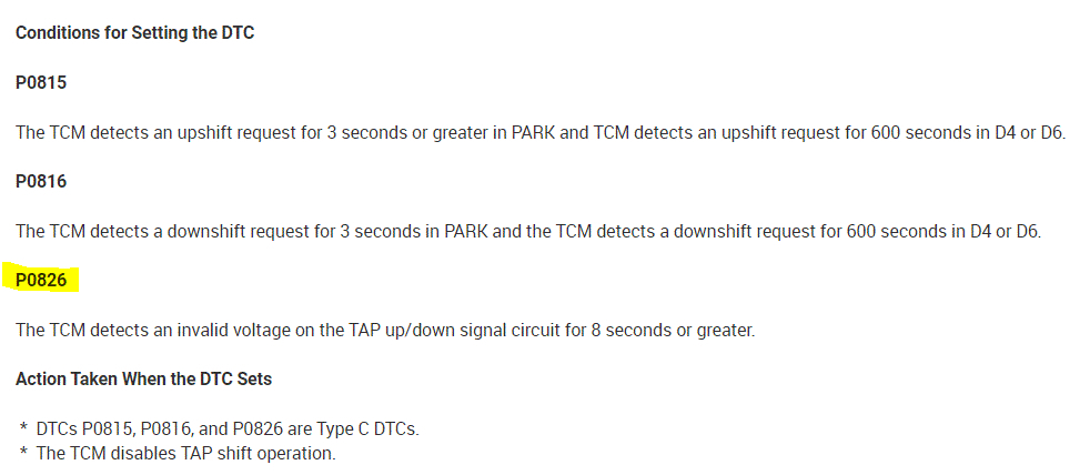

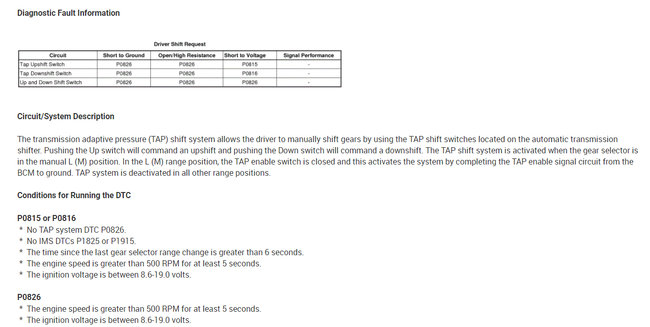

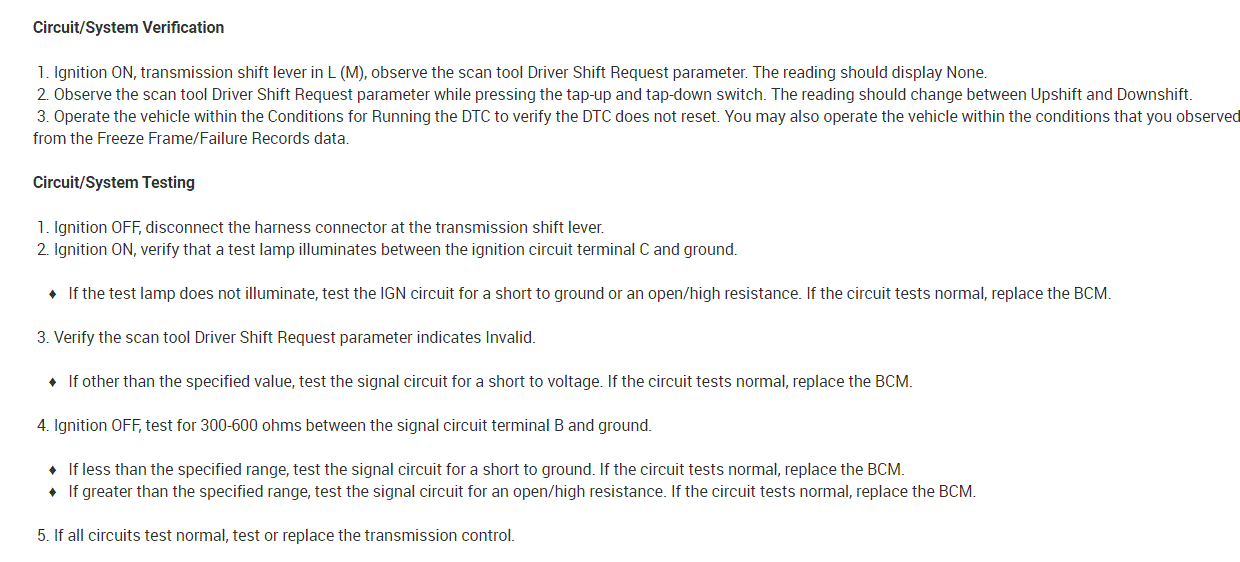

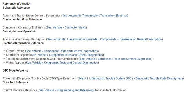

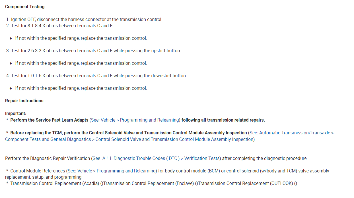

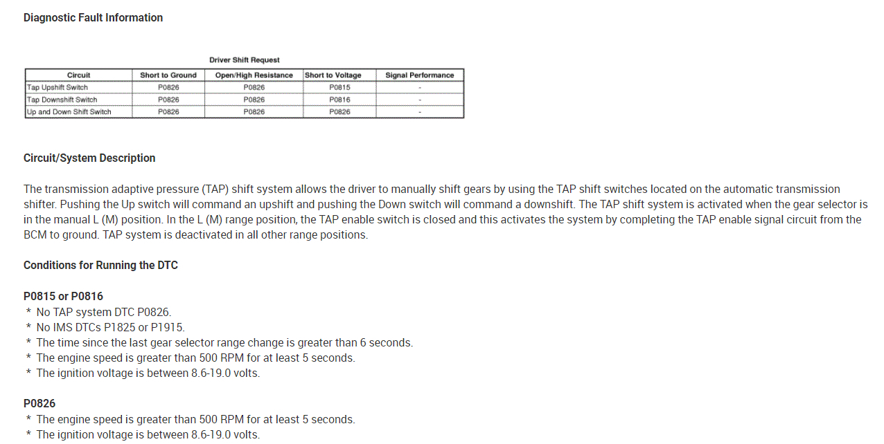

The B codes don't seem like they are a cause. The 1529-3 is for the steering wheel radio controls. 1395-3 is related to the instrument panel lighting/dimming (both low voltage from the BCM).
The P0826 is with the manual shift. I am going to let you look through the diagnostics related to that code because it is the only one that seems remotely relevant.
Take a look through the attachments below. Let me know if you are comfortable performing it.
Let me know if you have questions.

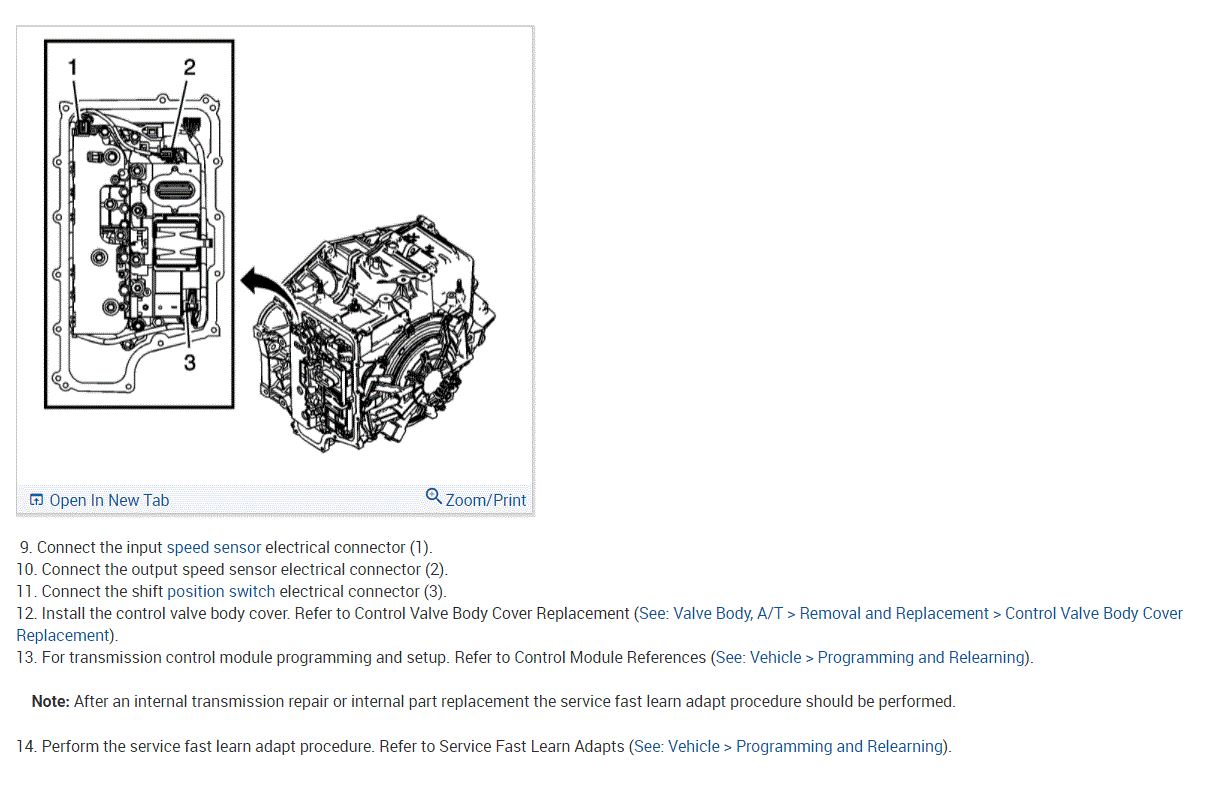

I'd like to try to get to the Shift Solenoid. Do you have any diagrams (or procedures) to assist me in getting there?
Dan
Wednesday, June 30th, 2021 AT 6:45 AM

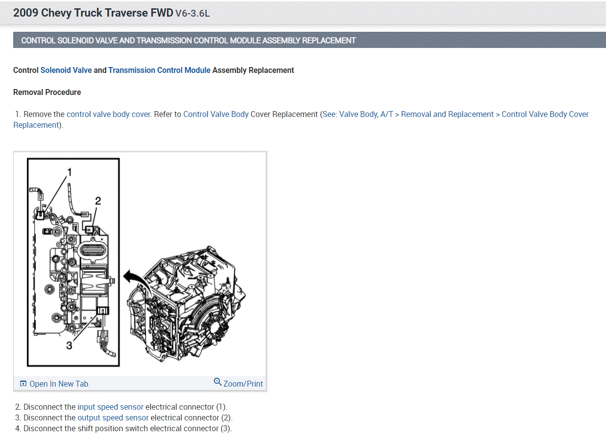

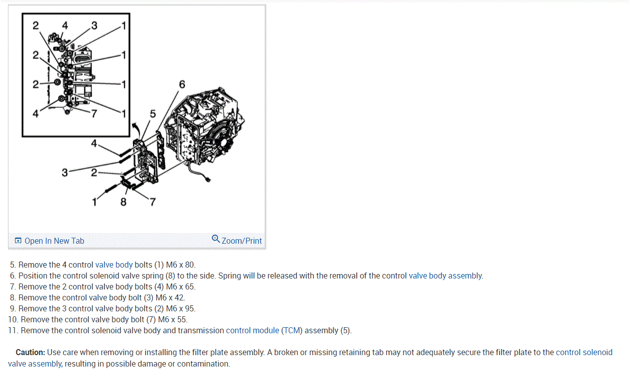

  • 109,747 POSTS

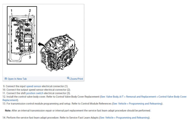

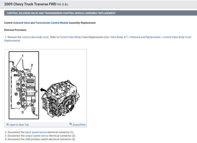

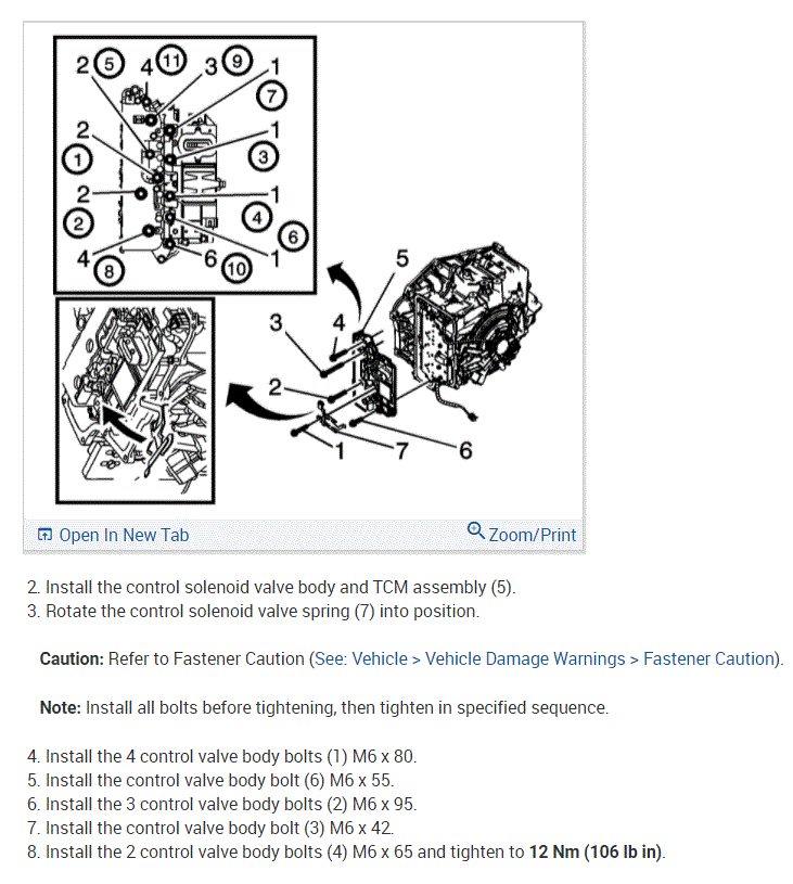

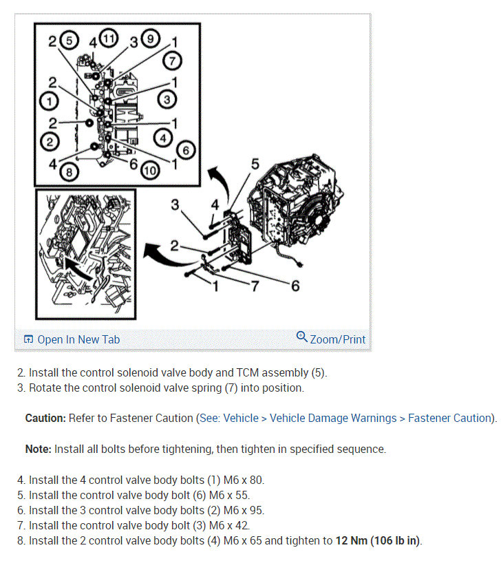

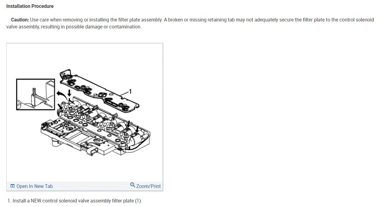

No problem. I attached the directions below for replacing the control solenoid valve in the transmission.
Let me know if this helps.
Wednesday, June 30th, 2021 AT 9:06 PM

I was referring to the Shift Interlock Solenoid. Here is Rock Auto's link to it:
https://www.rockauto.com/en/moreinfo.php?pk=2456696&cc=1444048&pt=16116&jsn=8&_nck=HllVxRCey1%2B2aVRDo41oQcMse1xIL9SL3KmW9dQXSf%2BAJlcOi2imTXTfOFLWd%2FZ7qi3oWcgQbtVtfiosB09jyUkNCc52VyjIycSOtQQibJSfVbfK5HMC7z15elRBhMX1tqxmeGuesF5DG4rkswUQTDqayIM4bRPkLDSMBJdcQkTMW11g7eXzpX4BqsxEDcQ8lSOLCofroOV8YT7LeM1Tht6DEa007%2B3xTpPeHm8P3iryjR6VO0%2Bdul1FKv%2FdMgbLLHrTgG181MPTOpVP9JKh3xz0fgmHXLqAZICc5tvu32nYgPMOKWGIUWSwxr%2F7eiTjB3FGaPMYHE19Z%2F4Nt39nNS2l34%2BzuTBw

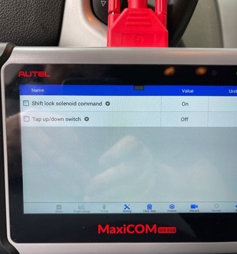

There are also YouTube video of others who are stuck in park and this $27 part was the cause for some. I'd be guessing if it were not for my new Autel scanner. I believe the solenoid is located, essentially, on or near the shifter column but I do not know how to get the center console out to get to it, or even how to pop 'anything' off to use a screwdriver (like others have) to manually test it, but I believe in my new tool, the Autel Mk808.
Here's one video: https://www.youtube.com/watch?v=F0zUYNcd_0k
Start at 4'48". This vehicle in the video indicates active/inactive. Mine indicates on/off, except mine says, "on" regardless if I'm depressing the brake peddle or not see attached picture). At least for getting the vehicle out of park, I now believe it's the Shift Interlock Solenoid.
Any guidance you can provide in getting the center console off and getting to the shift column would be appreciated.
