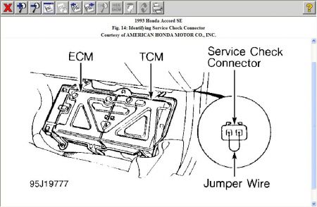

Hi erikekuehn, The D4 light would come on for 2 seconds at initial ignition On while the TCM is performing self tst. If any error is detected, the light would stay on and/or blink while the vehicle is running. Retrieve the trouble code by bridging the SCs connec tor and countting the blinking of the D4 light. If no trouble codes can be retrieved, there is a possibility the TCM is faulty.
https://images.2carpros.com/forum/automotive_pictures/192750_SCS93Accord_19.jpg
