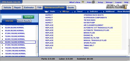

I purchased my 96 civic from a used car shop. No one knows its history. No owners manual. Worried to have a timing belt problem, I check the belt every 10,000 miles. After 40,000 miles on my use, I decided to change the belt so I wont worry getting a snapped belt. Now I made another 60,000 miles in 2 years. Up to how many miles can the original timing belt last. Tnx.

You got 30K's more to go to replace it and change it at every 90K's miles

Honda says to replace timing belt at 105,000 miles.

Notice there's no replacement of T/Belt @ 105K's miles-replace it now at that mileage of 300K's-overdue Good preventive maintenance
https://www.2carpros.com/forum/automotive_pictures/12900_tb1_4.jpg
https://www.2carpros.com/forum/automotive_pictures/12900_tb2_4.jpg
