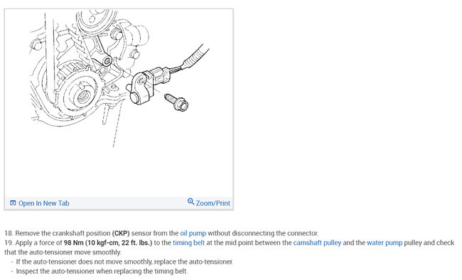

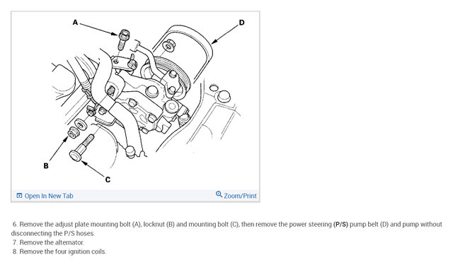

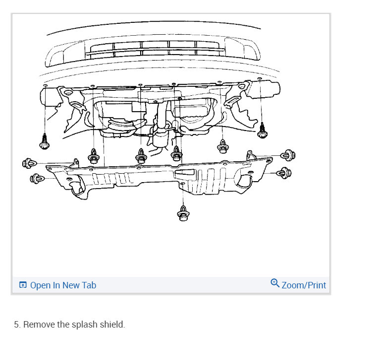

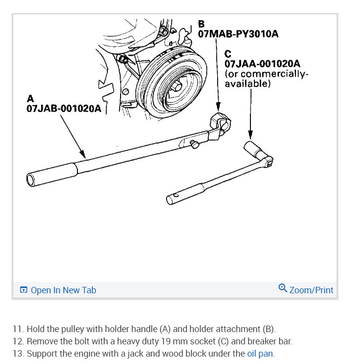

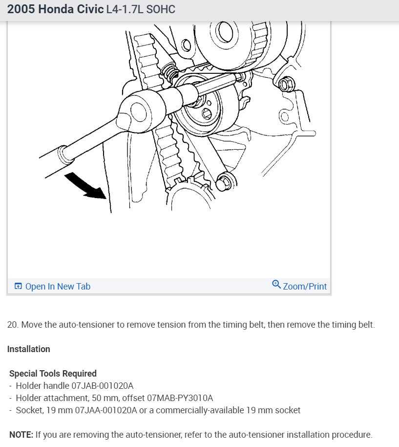

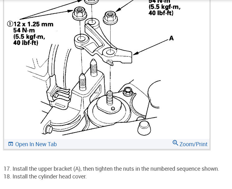

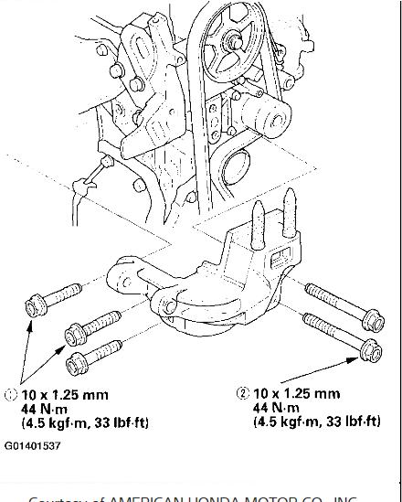

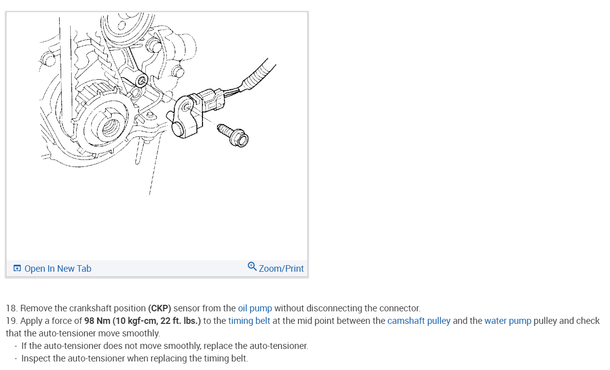

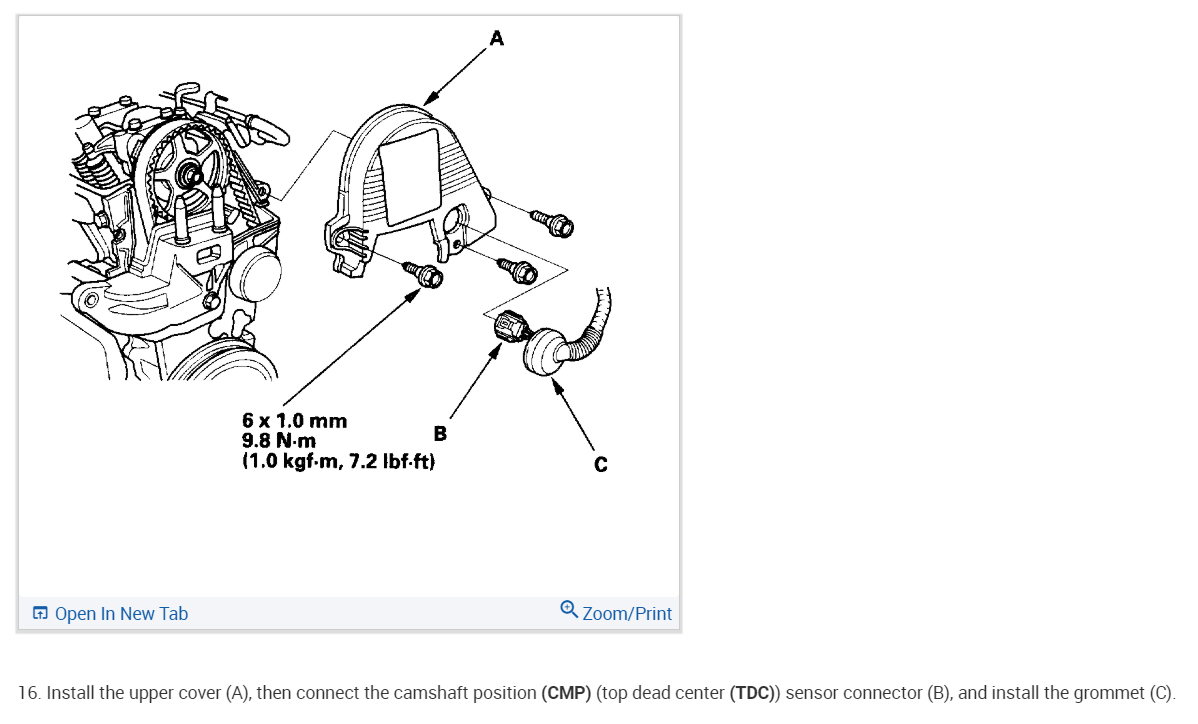

how to replace timing belt?
Oct 5, 2008 at 9:45 AM
BRUCE HUNT
  • 3,754 POSTS

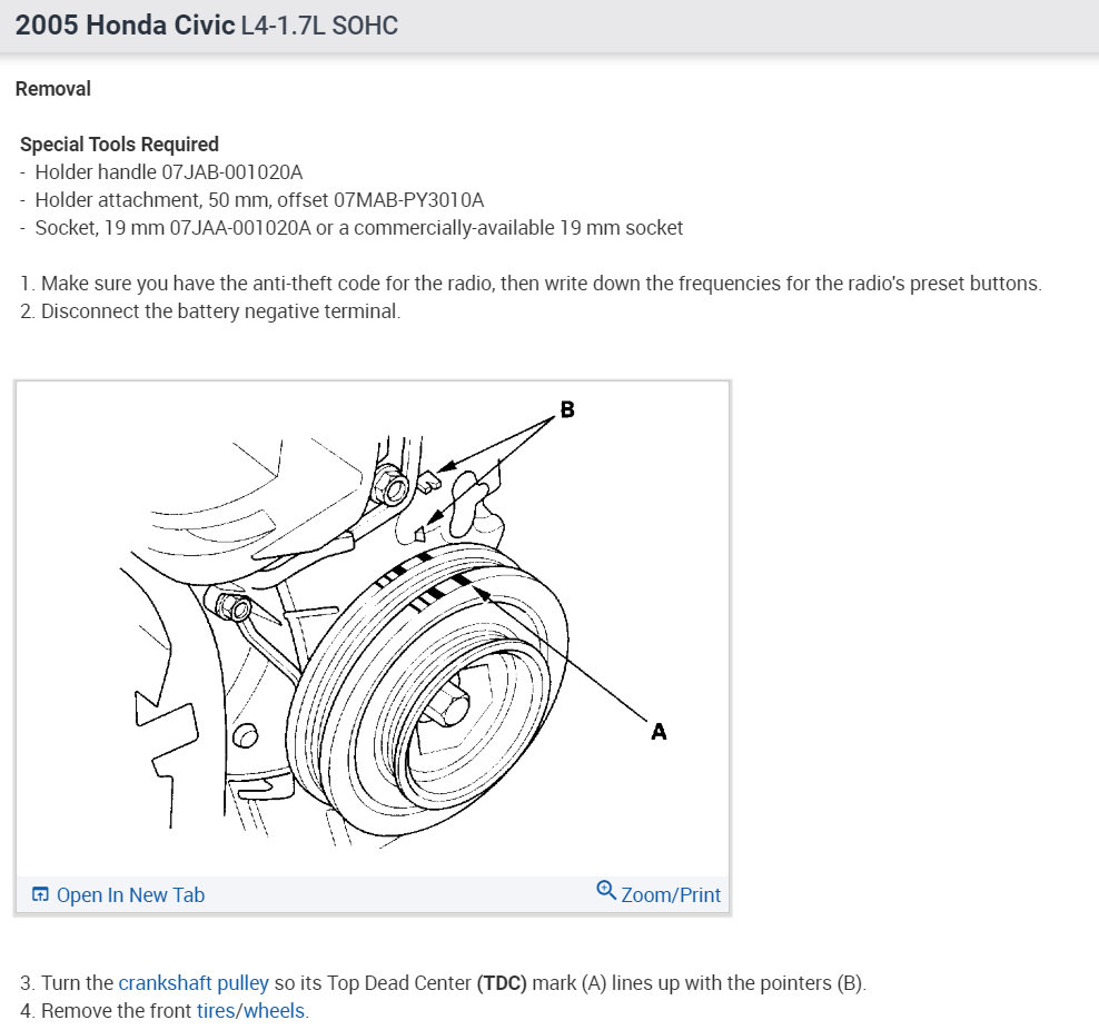

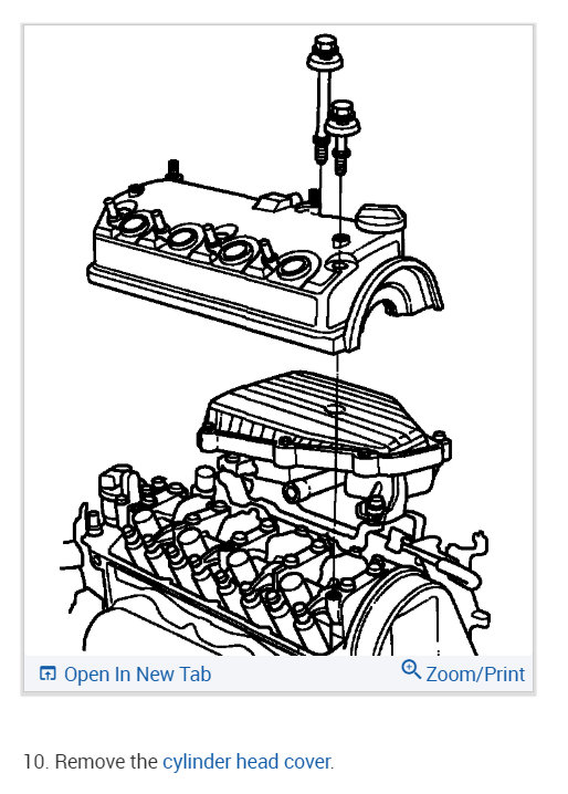

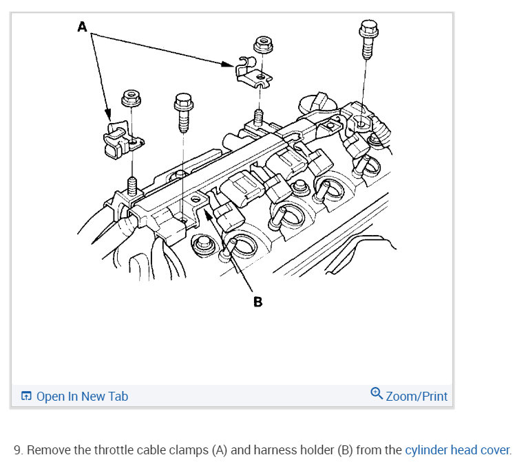

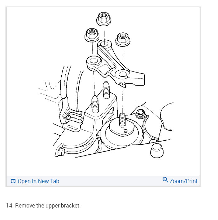

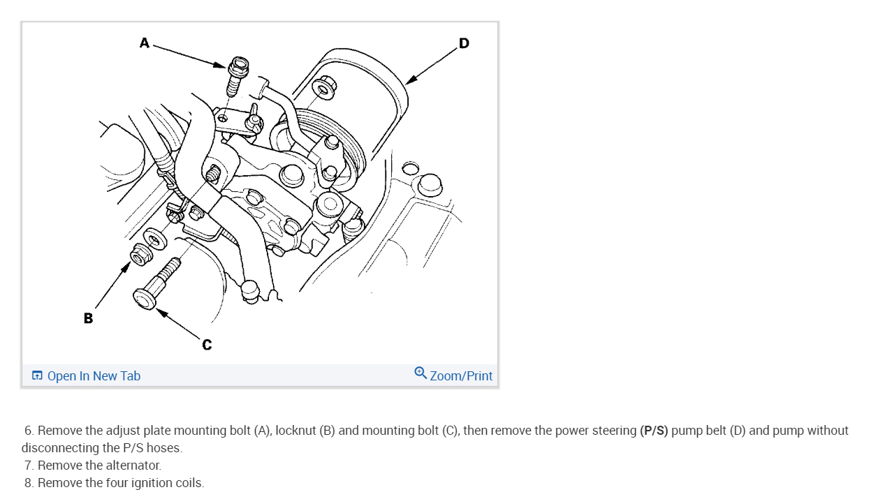

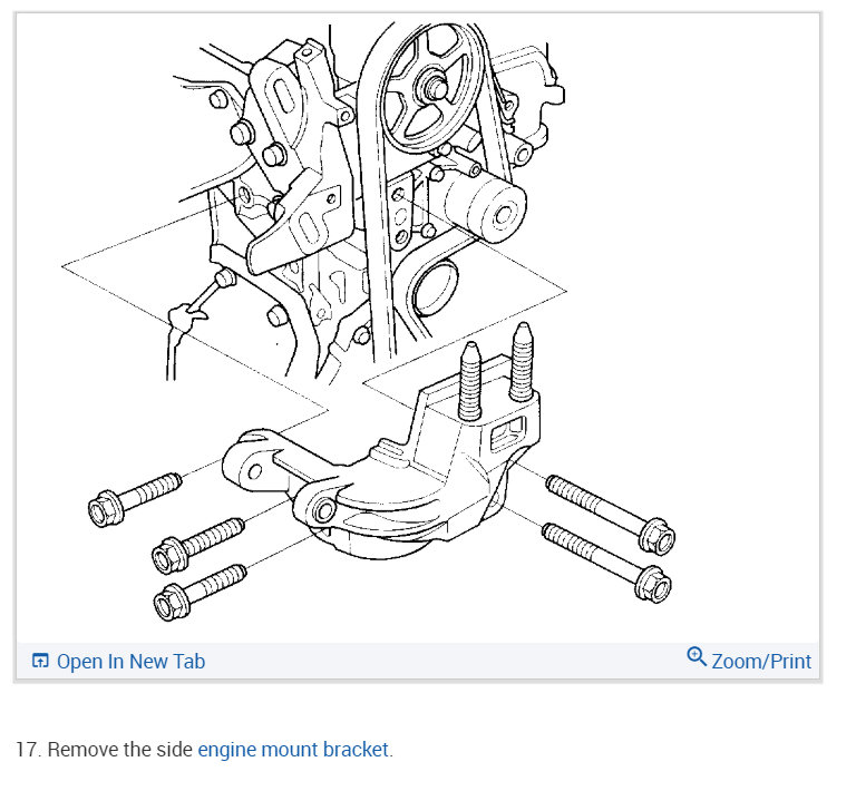

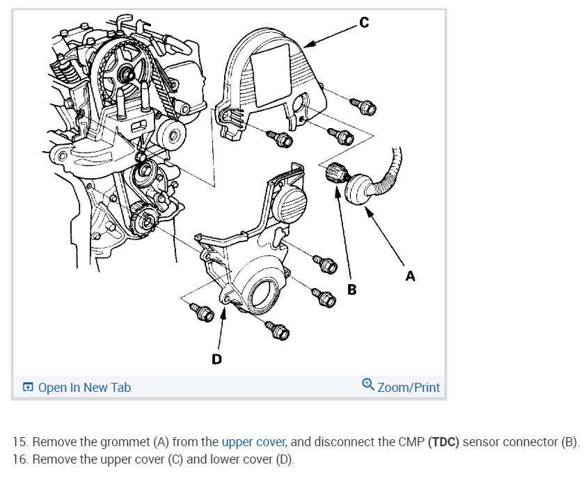

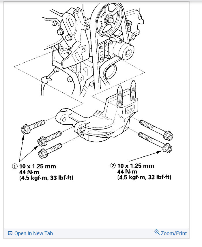

You must use a jack under he engine to hold it up, please disconnect the battery before you begin here are instructions of the timing belt replacement in the diagram below. Check out the diagrams (Below). Please let us know if you need anything else to get the problem fixed.

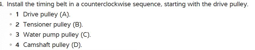

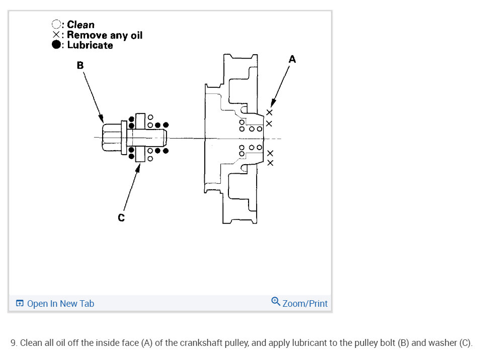

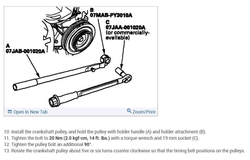

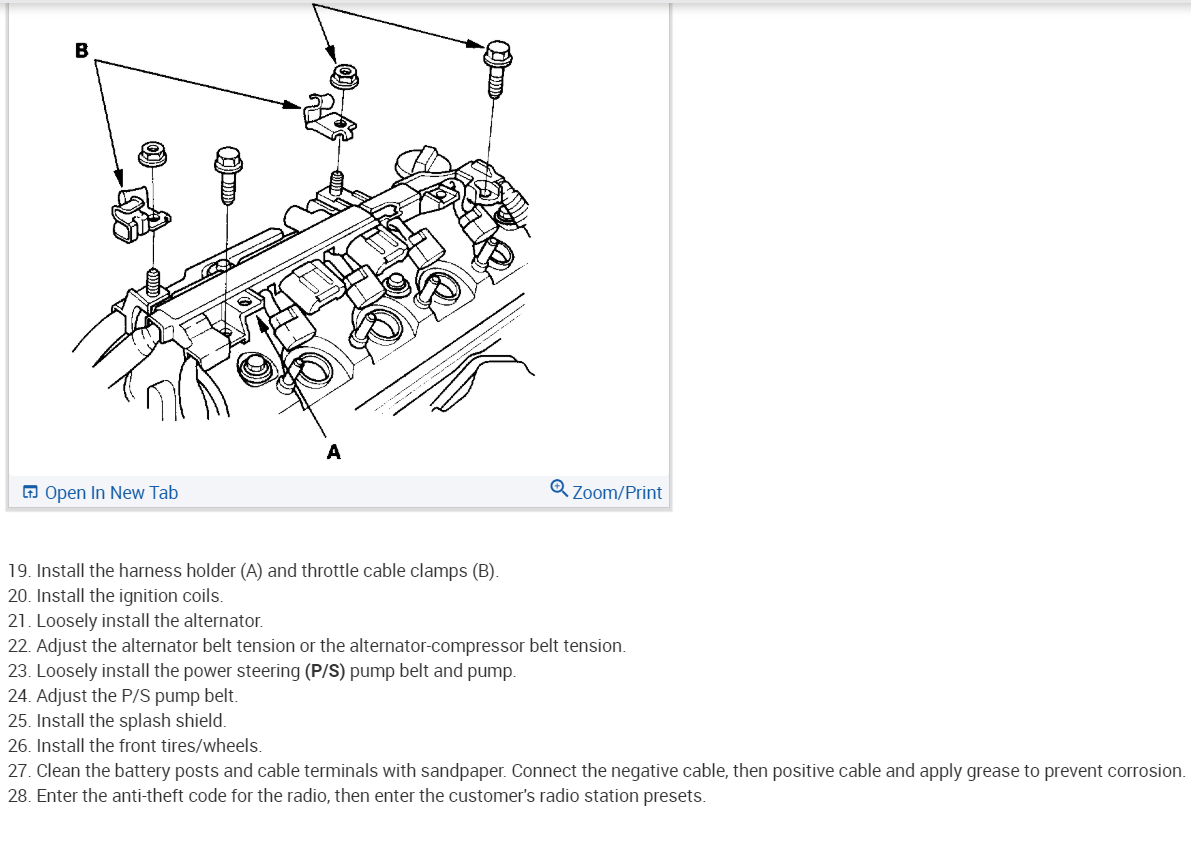

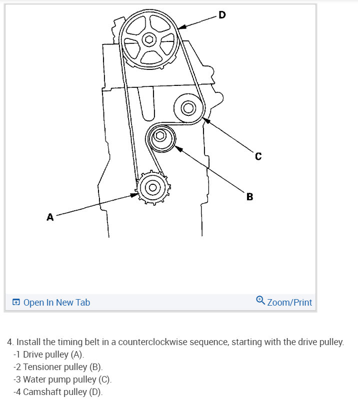

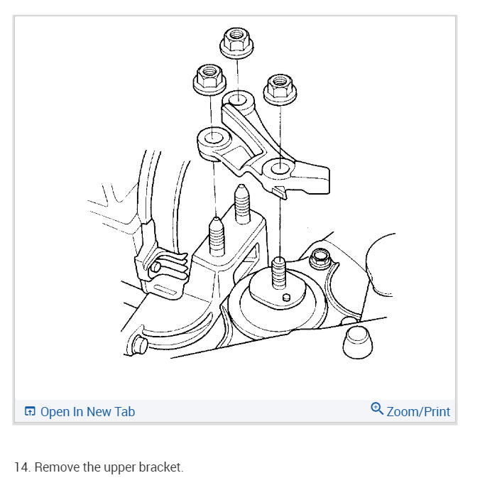

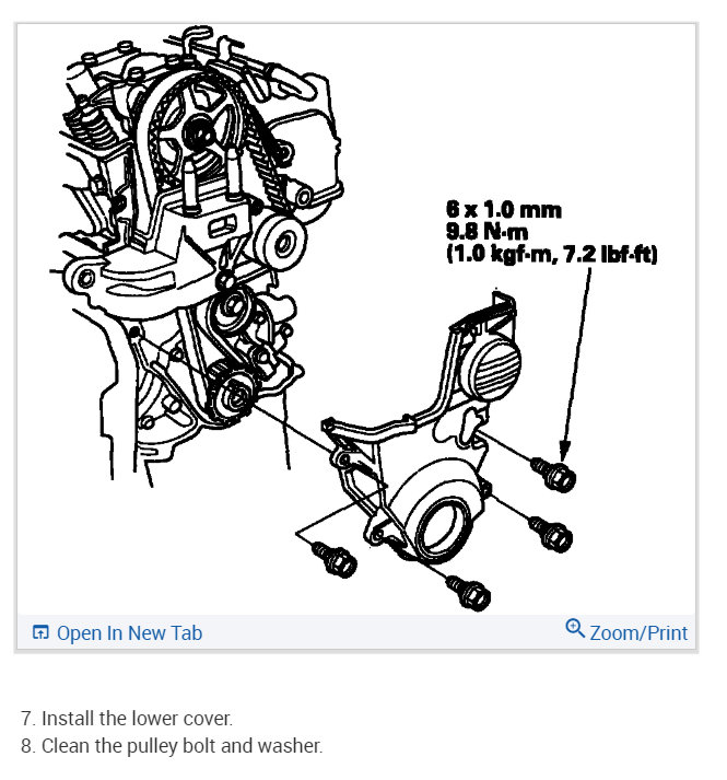

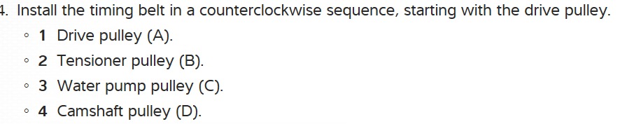

I am having trouble timing my Honda! we just replaced the head in it and now I have the new timing belt in but am stumped!
Jan 5, 2020 at 9:38 AM (Merged)
HMAC300
  • 48,601 POSTS
see pics also turn engine over after crank pulley installed 5/6 times then recheck cam pulley.
https://www.2carpros.com/diagrams/honda/civic/2004

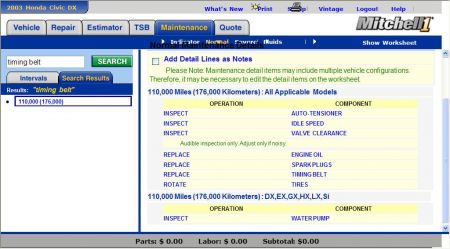

WRENCHTECH
  • 20,761 POSTS
It does have a timing belt. The recommended change interval for that engine is 110K under normal conditions.
The labor to replace the belt is 2.7 hours and maybe an extra hour for the water pump. The parts could run a couple hundred dollars.

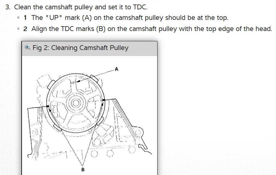

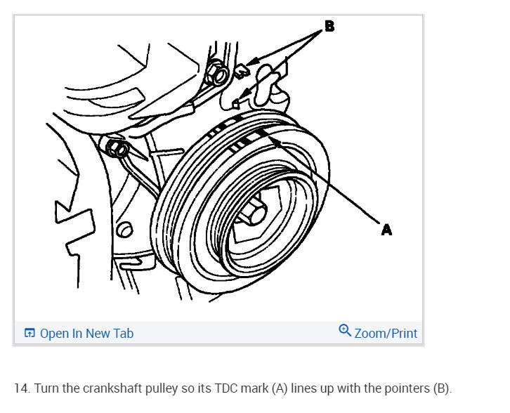

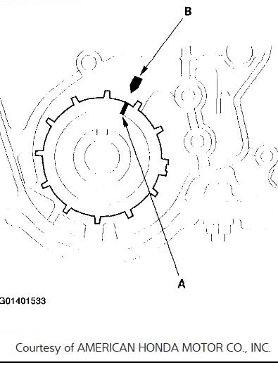

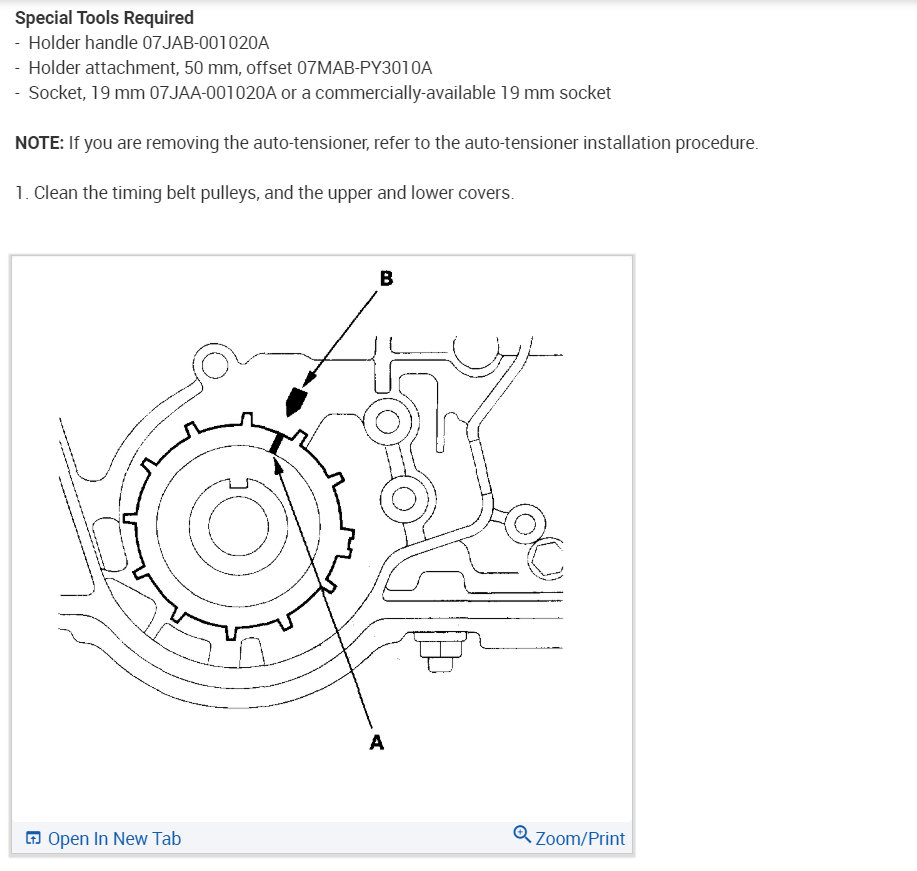

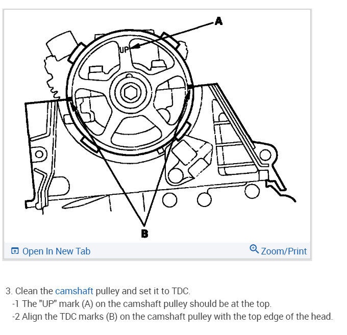

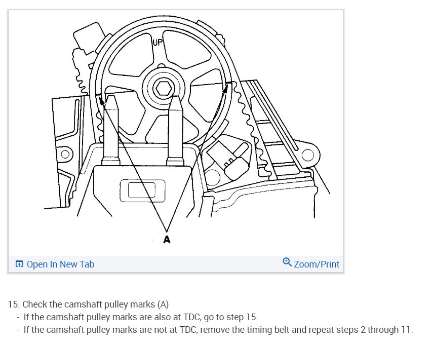

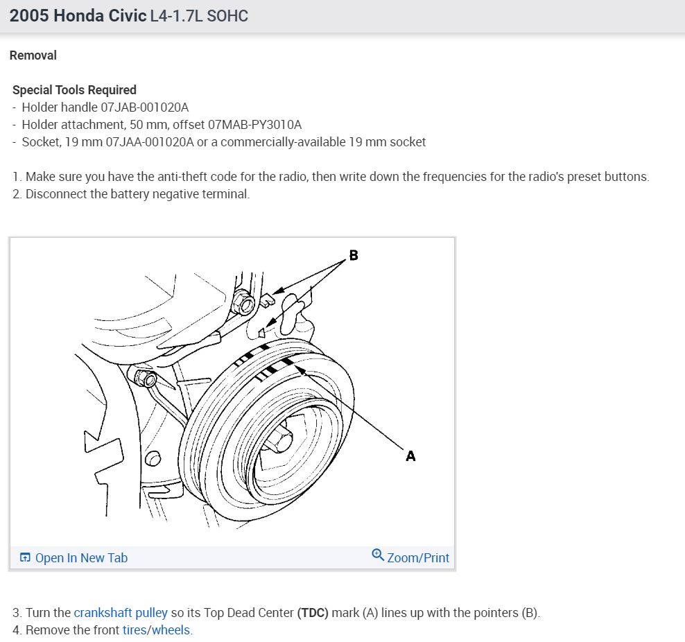

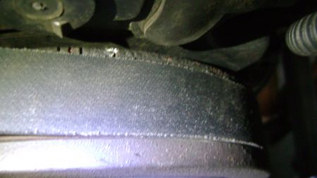

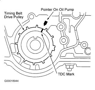

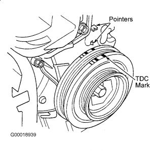

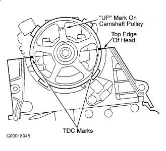

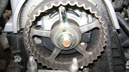

My camshaft pulley moved during belt installation. Now I'm trying to align the crankshaft pulley marks with the camshaft pulley notches. The Crankshaft pulley has 4 notches: 3 that are close together with a red mark in between the two. Then to the right of the 3 notches about a 1/4 inch away is one notch by itself. Which notch should I line up with the belt cover V notch to get the engine to TDC before removing the crankshaft pulley for a belt replacement? Isn't the red mark BTDC? Shouldn't I align with notch on the right for TDC? Also, what do I line up the Camshaft pulley sprocket arm labeled 'UP'? There a two notches 180 degrees apart. 90 degrees left and 90 degrees right from the UP label. Should these notches be parallel with the ground? Thanks in advance.
https://images.2carpros.com/forum/automotive_pictures/409740_DSC00394_1.jpg
https://images.2carpros.com/forum/automotive_pictures/409740_DSC00392_2.jpg
Jan 5, 2020 at 9:39 AM (Merged)
BMRFIXIT
  • 19,053 POSTS
hope this help let us know if need more or you have more questions
https://images.2carpros.com/forum/automotive_pictures/99387_Graphic1_507.jpg
https://images.2carpros.com/forum/automotive_pictures/99387_Graphic2_246.jpg
https://images.2carpros.com/forum/automotive_pictures/99387_Graphic3_112.jpg
HARDLYMOVING
I moved the crankshaft pulley to the rightmost mark which according to the diagram is TDC. After doing this, my right camshaft pulley mark IS aligned with the "Top Edge Of Head"... however, the left is noticeably lower if you look at my photo. But since the diagram's "UP" sprocket arm appears to be in center line with the camshaft pulley bearing cap behind the pulley and mine is not, i figure retarding the camshaft pulley one cog clockwise will center the pulley's UP arm and bring up the left side camshaft sprocket mark. This, unfortunately, will drop the right mark below the "Top Edge Of Head".
Any thoughts or suggestions?
BMRFIXIT
  • 19,053 POSTS
Sorry I’ve never ran to a problem like the one you having <
the only thing I can think of is that the head is a bit tilted and if you can jack it up so you can have a better look get a straight edge and place on the head touching the pulley to give you a better look as to where it is for real
good luck
HARDLYMOVING
The picture diagram is incorrect. The Camshaft marks are one cam gear tooth below the top of the head. No big deal ... got the engine timing down pat.
