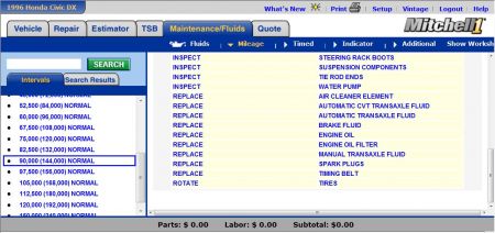

Timing belt
DJ3D
  • 1999 HONDA CIVIC
  • 4 CYL
  • 2WD
  • MANUAL
  • 115,727 MILES
I bought this car 4 years ago used from a friend I have kept up with all usual checkups and things except I just recently found out you are supposed to have a water pump and timing belt change. In the last two months I have started to hear some squealing every now and then. When will I know that my belts are on their last legs. I truly cant afford an $800.00 car repair at this moment. Also are there any other repairs that have to be done when those repairs are made.
Monday, April 21st, 2008 AT 8:28 PM
25 Replies
MHPAUTOS
  • 31,937 POSTS
Hi there
When the front covers are off to replace the engine timing belt, just check that the cam shaft and crank shaft oil seals are not leaking, if so replace as it will be cheaper to do it now than if they start leaking worse in a few months time.
Mark (mhpautos)
Tuesday, April 22nd, 2008 AT 5:46 AM

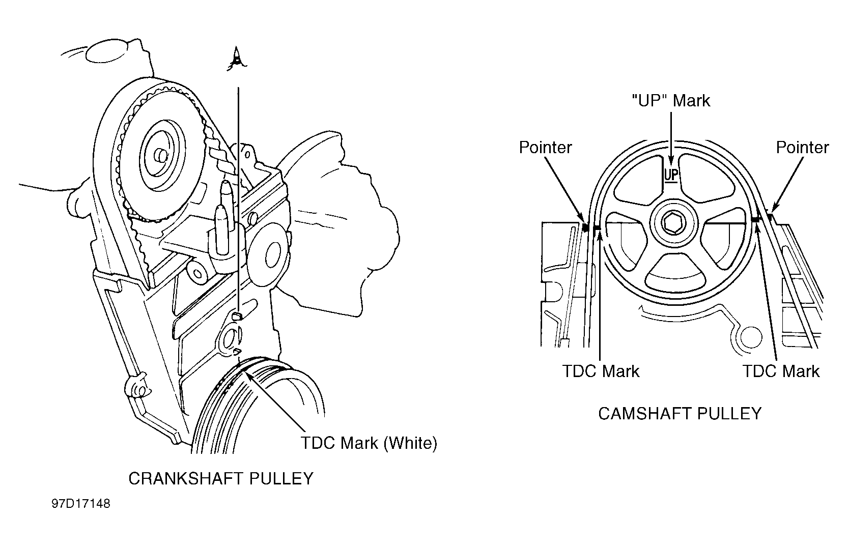

2CP-ARCHIVES
  • 4,540 POSTS
  • 1996 HONDA CIVIC
  • 90,000 MILES
I need diagram of timing marks for my 1.6 liter single over head cam engine.
Sunday, January 5th, 2020 AT 5:41 PM (Merged)
  • 75,992 POSTS
Here is a guide and diagrams below to show you where the camshaft timing marks are.
https://www.2carpros.com/diagrams/honda/civic/1996
Check out the diagrams (Below). Please let us know if you need anything else to get the problem fixed. Cheers
+5

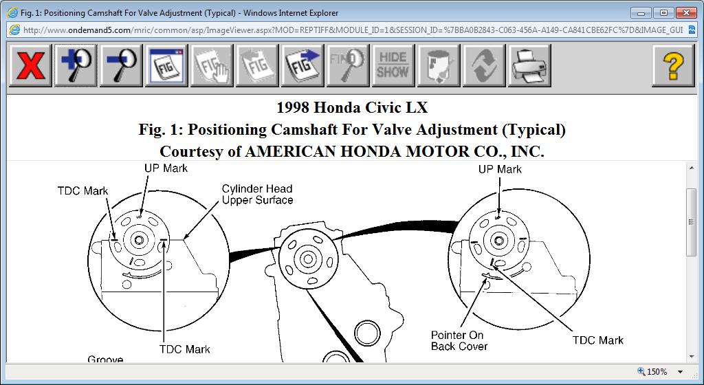

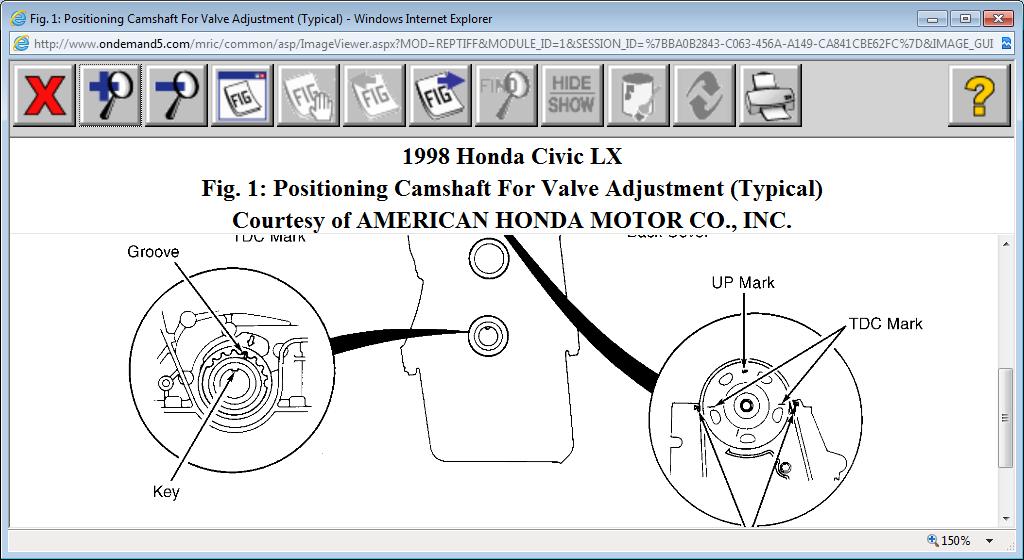

EDWINIE
  • 1998 HONDA CIVIC
  • 138,000 MILES

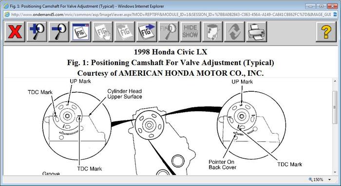

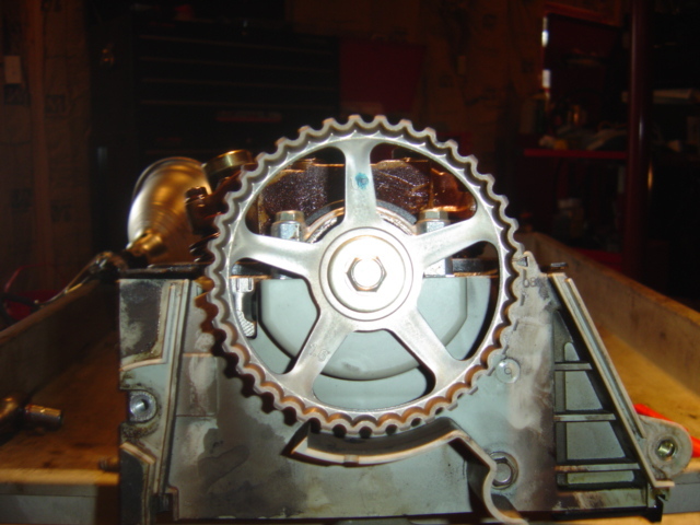

My car is the LX model, four door, engine 1.6 D16Y7. Replacing timing belt want to verify cam and crank timing marks. Cam cover does not match cam gear marks.
+1
SATURNTECH9
  • 30,869 POSTS
Here is a great page to show you the timing marks look toward the bottom of the page:
https://www.2carpros.com/diagrams/honda/civic/1998
Cheers
+10
SATURNTECH9
  • 30,869 POSTS
Here are marks for the dual cam just in case anyone needs it.
+7
EDWINIE
Here is a picture the same in the diagram. :)
+5
SATURNTECH9
  • 30,869 POSTS
It is the same set up they just show a different picture in the diagram for the cam sprocket. Yours even has the pointer timing mark in the bottom left like the diagram shows. I just did a head job on a 1997 Honda Civic same engine a couple of days ago and used this same diagram to set the time. Engine runs great.

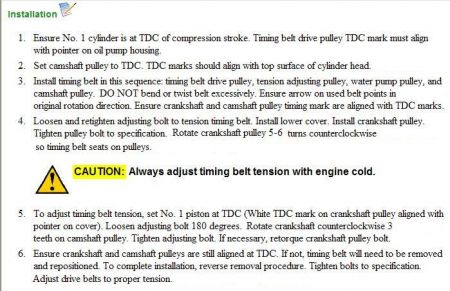

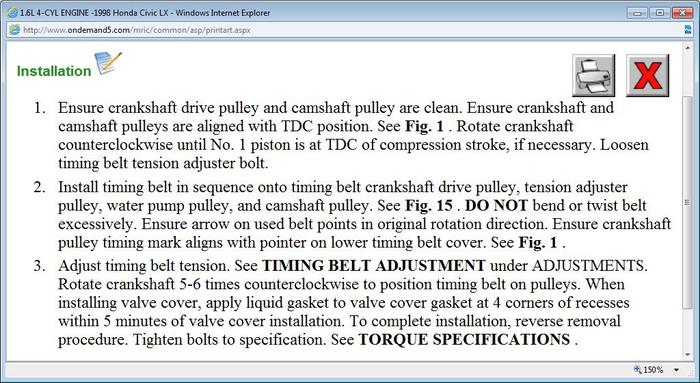

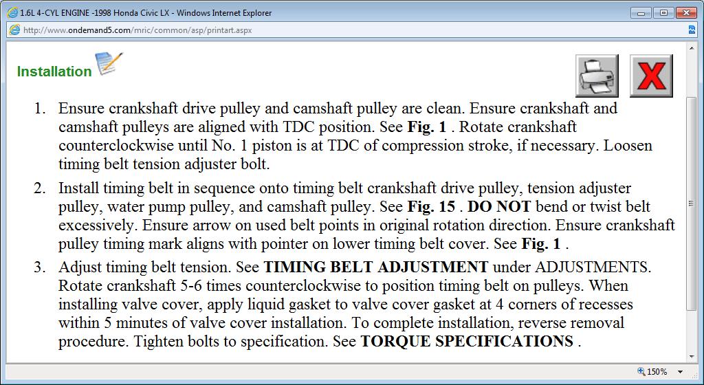

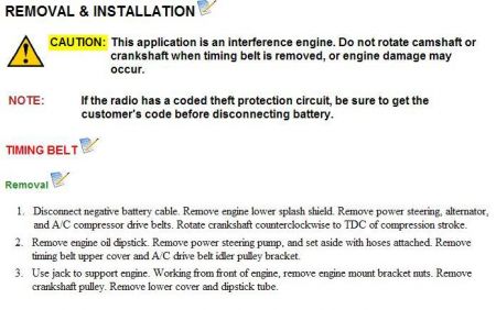

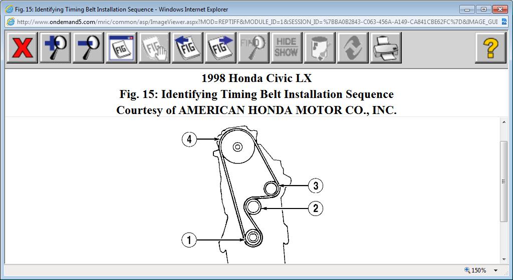

How to replace the timing belt, water pump, and the tensioner
Sunday, January 5th, 2020 AT 5:42 PM (Merged)
F4I_GUY
  • 3,302 POSTS
This is the closest write-up I could find.
This is on a dual cam, but it is essentially the same practice except easier!
