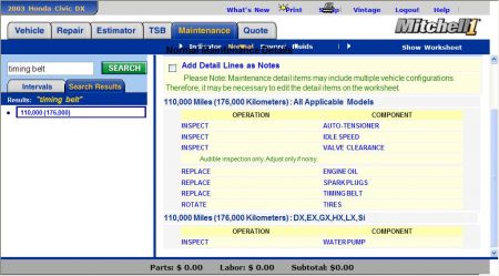

My Civic has nearly 90000 mi. On it. I live in the San Joaquin Valley of California (100 degrees in Summer)
When should I change the timing belt?
Sunday, January 5th, 2020 AT 5:40 PM (Merged)
  • 75,992 POSTS
If I were you change it now-see below
https://www.2carpros.com/forum/automotive_pictures/12900_timing_belt_5.jpg
JON BYERS
  • 2003 HONDA CIVIC
  • 114 MILES
When should I have the timing belt changed? I have been told by several other owners that they changed for the first time as late as 200k miles.
  • 52,797 POSTS
I recommend hondas at 110,000. The book calls for 100k in severe driving and 125 with easy driving.
Do not wait as it will cost you lots if it breaks. You may bend valves.
