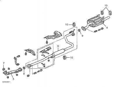

Totally unrelated, but we were about 70 miles out of Phoenix and our exhaust resonator rusted right through and hit the ground as we were driving up a big hill. How much will it cost to get a new exhaust pipe and resonator?

As far as the exhaust if number 6 in the picture is what you are refering to, the part is around 160.00 + labor.
https://images.2carpros.com/forum/automotive_pictures/249084_res_1.jpg
Now for the engine problem. I find it hard to believe that the AC is shuting the engine off. Has the check engine light come on? WHen it stops, is it all at once or does if studder first then die? Is the a loss of power before this happens? Let me know, and thanks for using 2carpros.com. Joe
