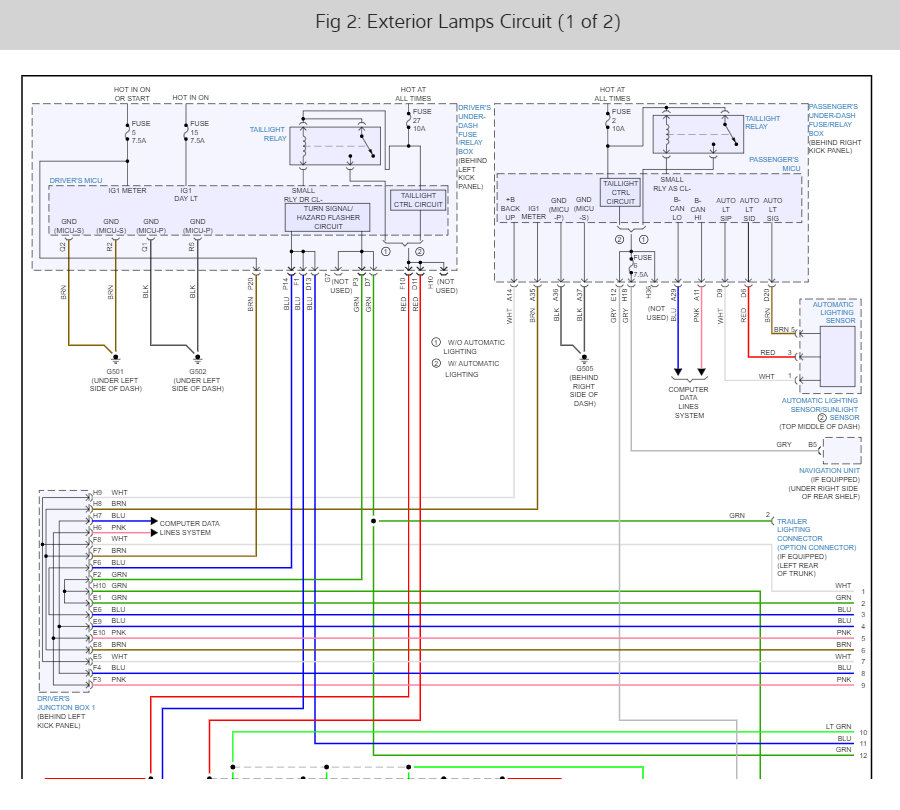

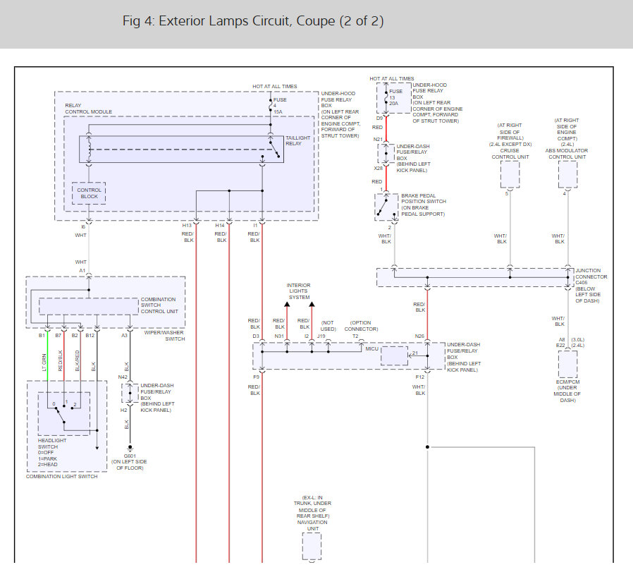

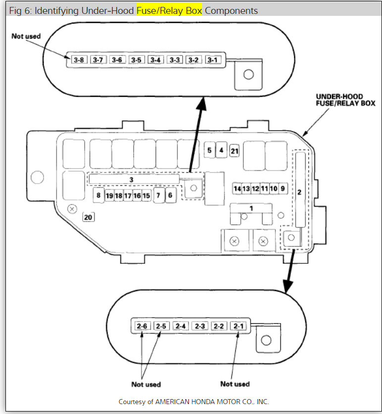

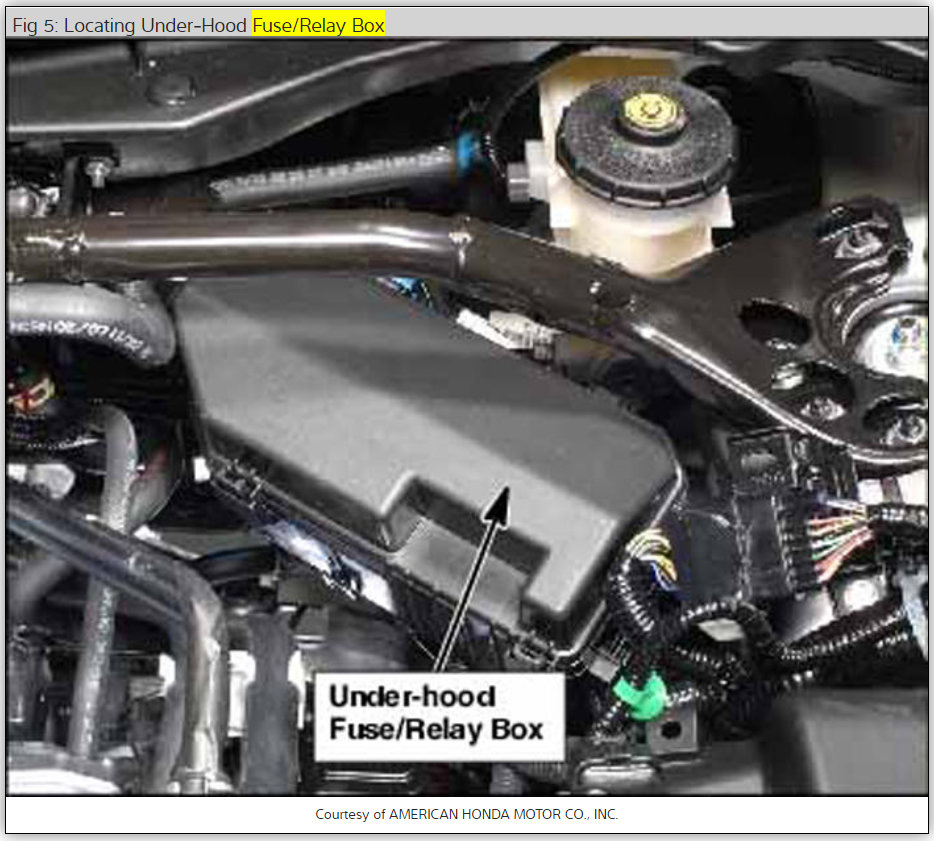

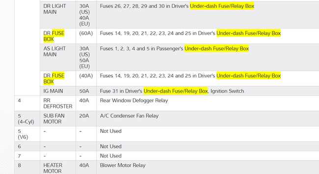

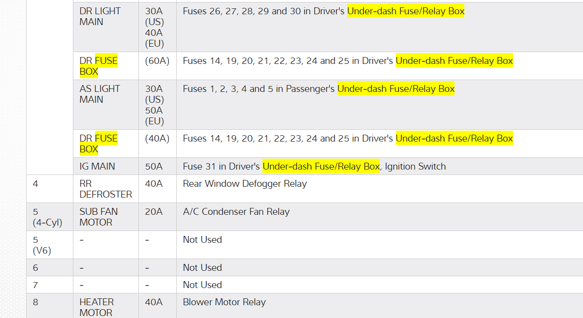

My brake lights are not working? There are two (2) wires (black and red) for the bulb but I don't know how to fix it can you help me?
Mar 14, 2010 at 12:43 AM
KHLOW2008
  • 41,814 POSTS

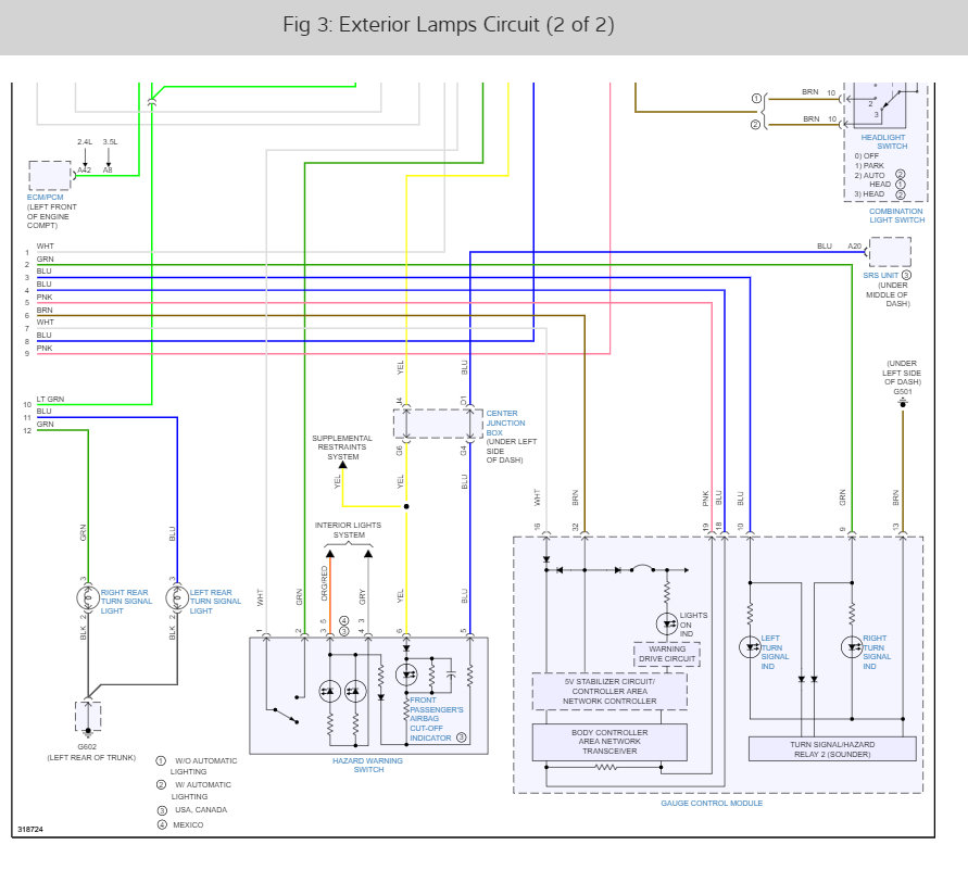

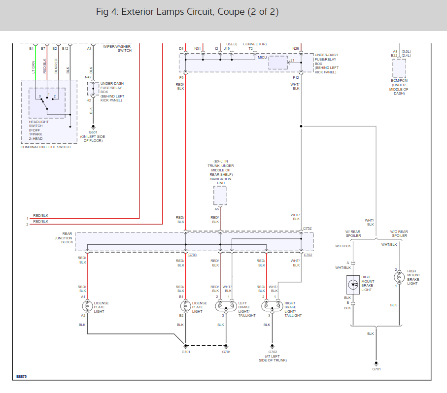

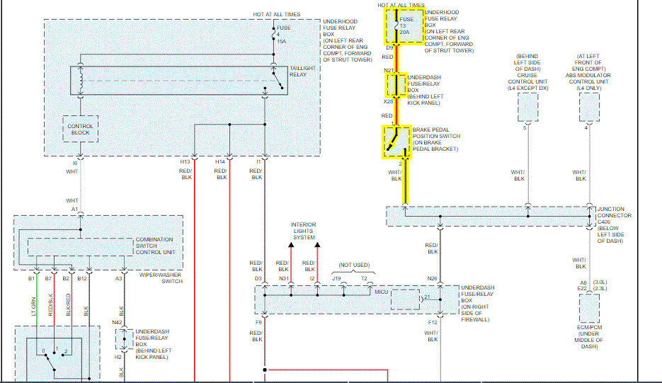

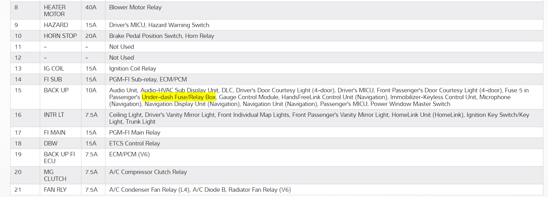

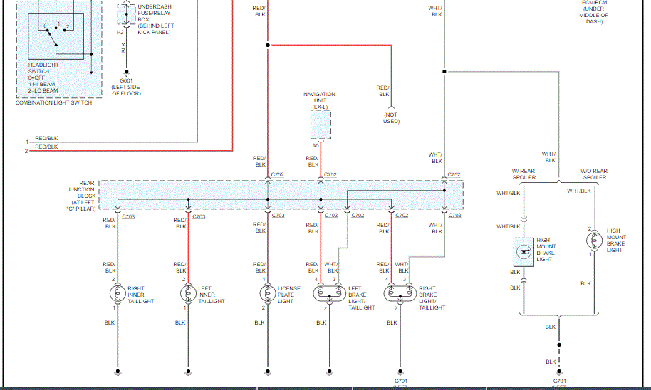

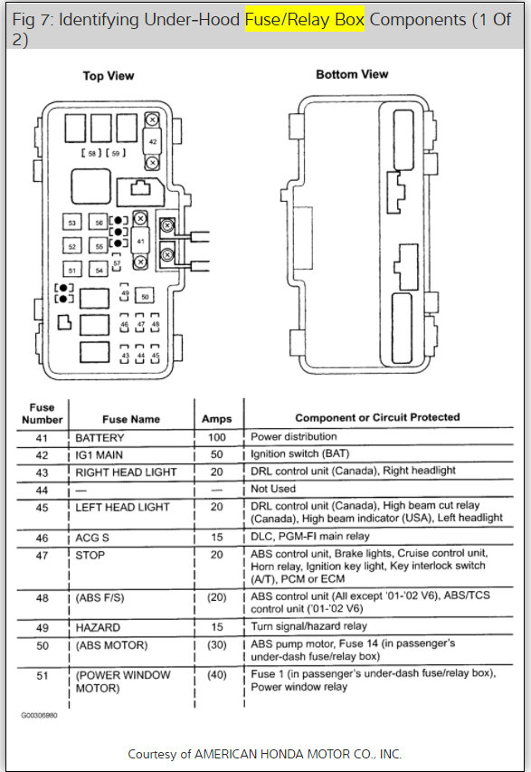

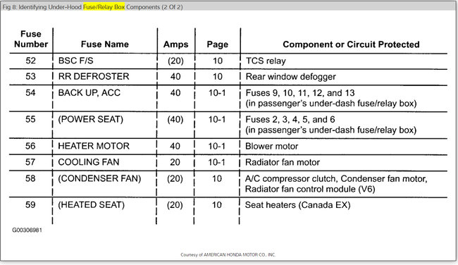

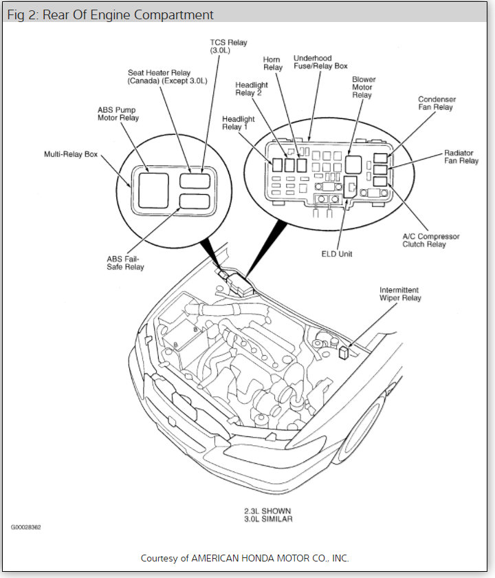

It sounds like the #10 fuse in the under hood fuse panel is out or the drives MICU is out. But let's start with the easy stuff, here is a guide to help you check the fuses witht he fuse location in the diagrams below. I have included the brake light wiring diagrams and fuse locations so you can see how the system works.
https://www.2carpros.com/articles/brake-lights-not-working
and
Check out the diagrams (Below). Let us know what happens and please upload pictures or videos of the problem.

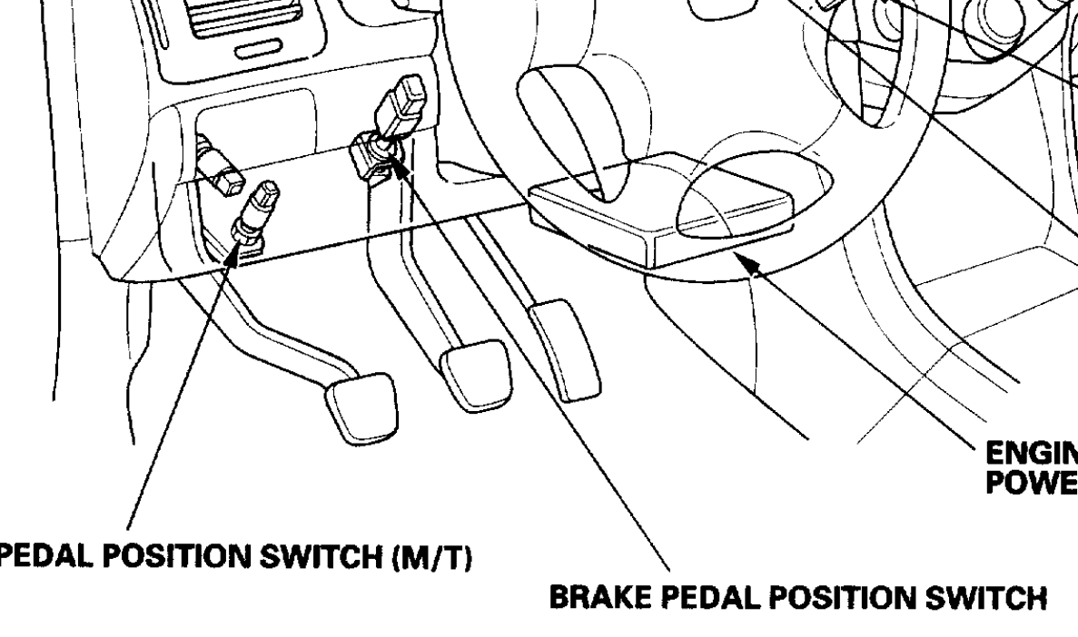

It can be the brake light switch I just had this problem with a this car in the shop here is the switch location so you can change it out. Check out the diagrams (Below). Please let us know what you find.
May 17, 2021 at 5:01 AM (Merged)

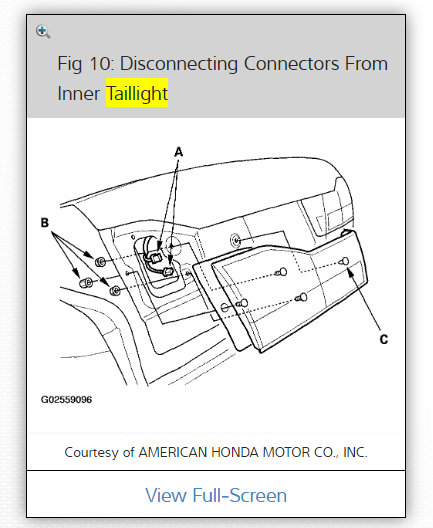

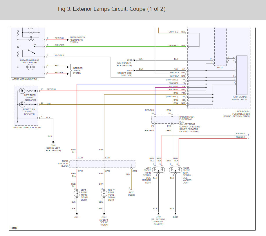

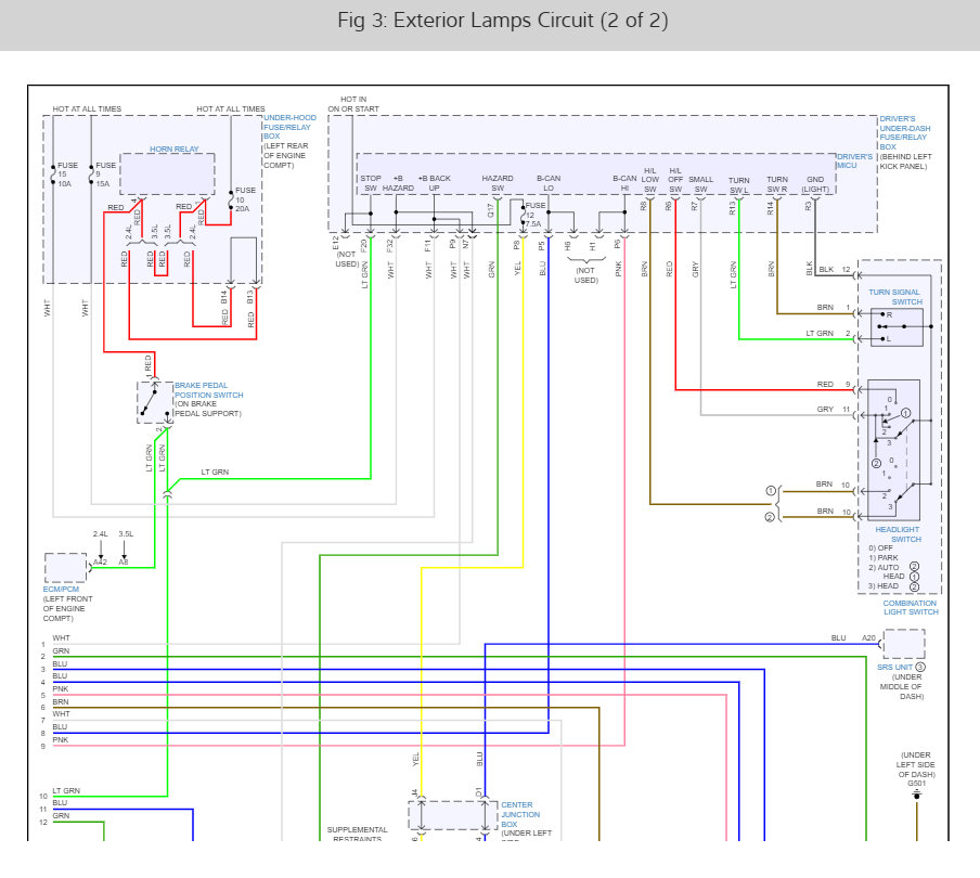

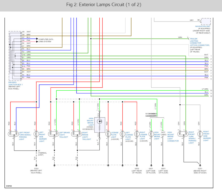

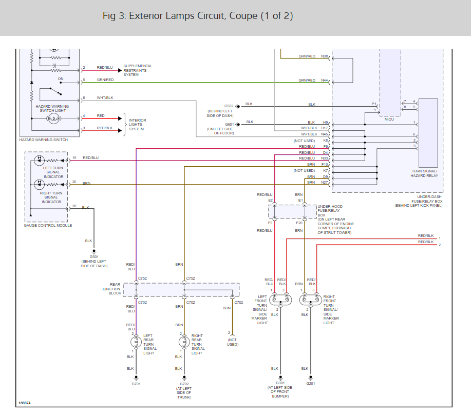

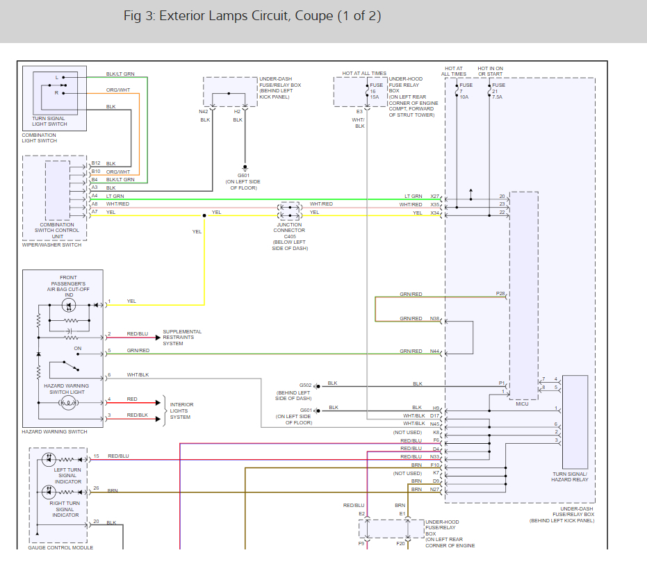

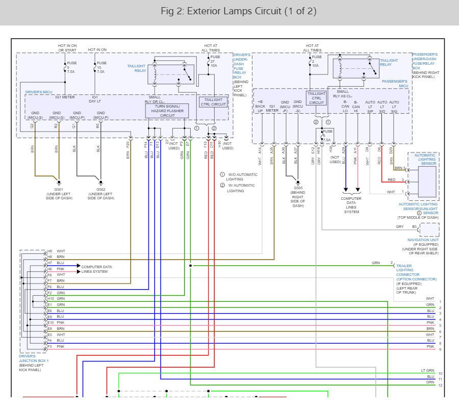

All of my lower brake lights are out at the same time but the upper brake light is okay. The filaments in the brake lights look okay. All other lights and electrical are okay?
KHLOW2008
  • 41,814 POSTS

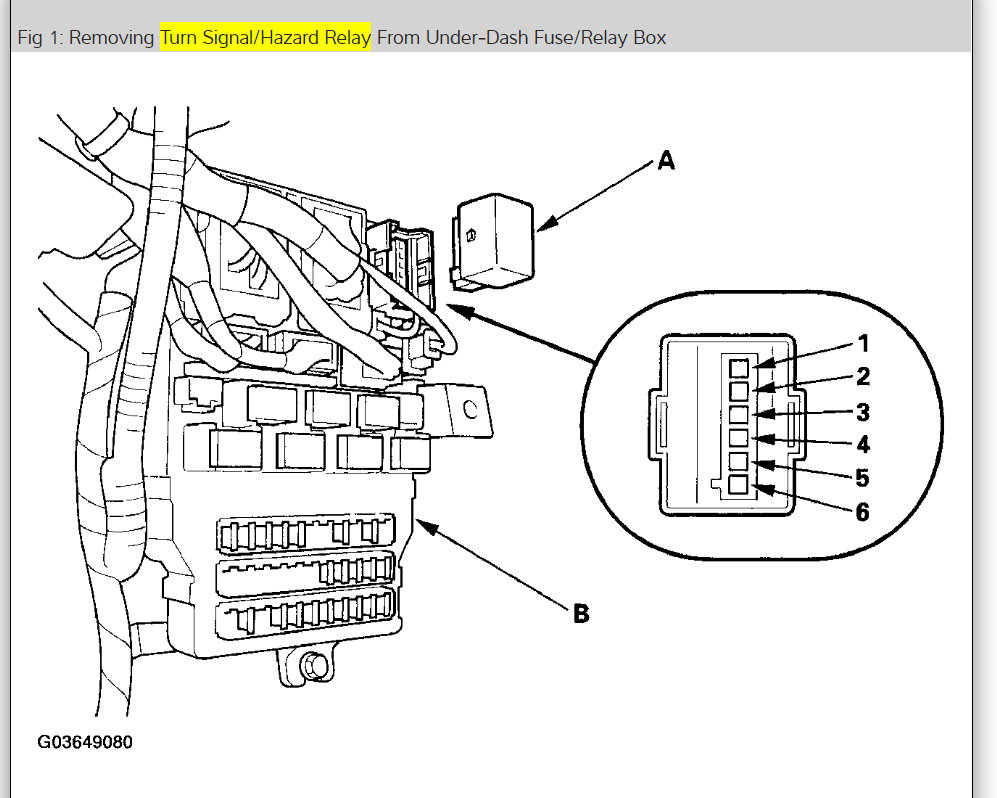

Hi bmanion,

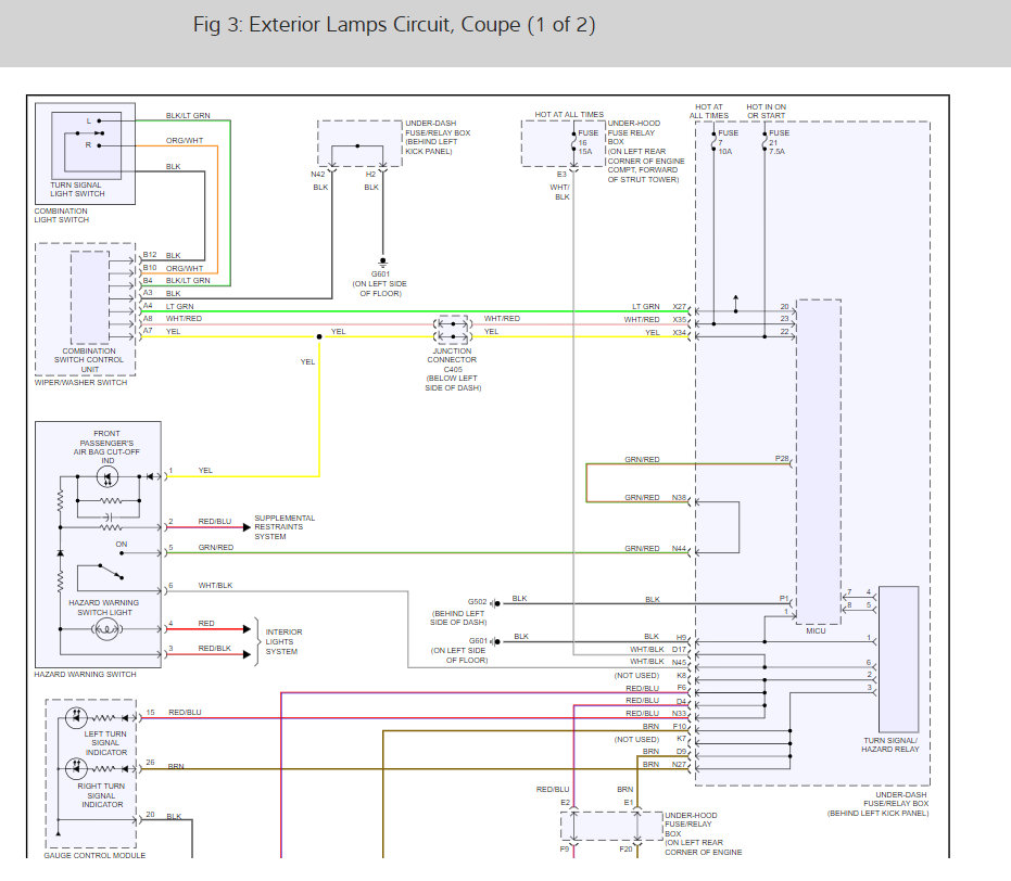

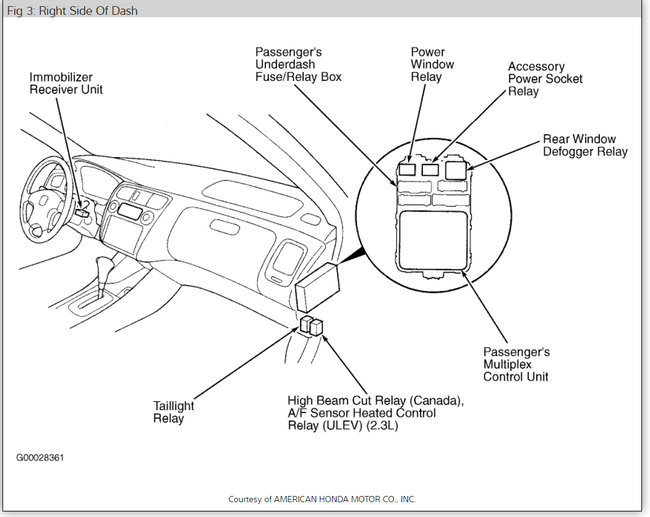

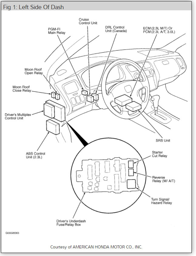

It sounds like the turn signal hazard relay is not working correctly but to be sure here is a guide to help test for power with the brake light wiring diagrams along with the turn signal relay below.
Check out the diagrams (Below). Please let us know what you find. We are interested to see what it is.
ZANYJB
Thank you for this post I had this problem and had to get a new flasher relay cost me $65.00 all fixed I love this site.

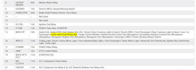

LITTLERASCAL

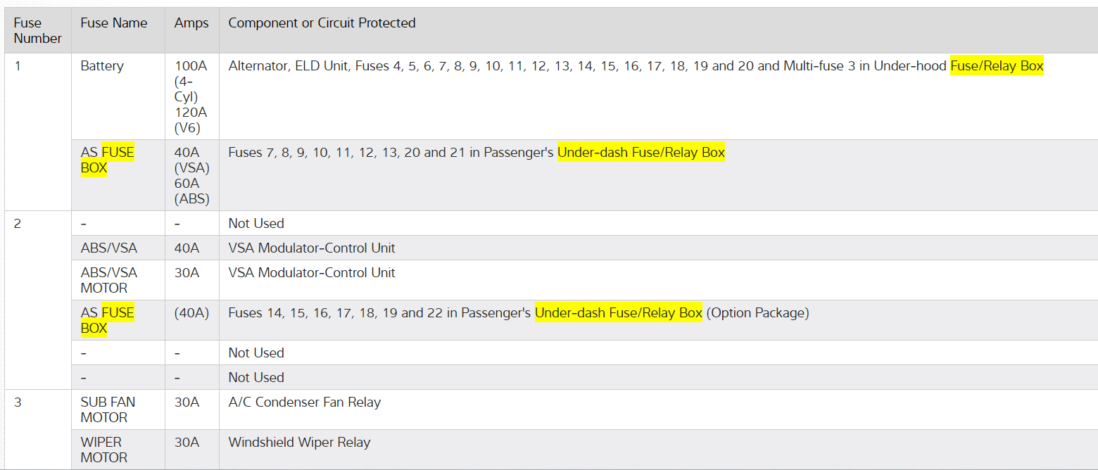

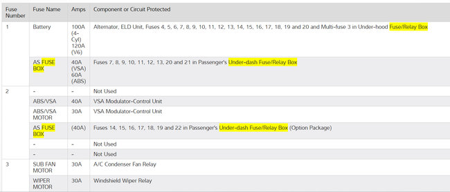

Looking at the manual it does not indicate which fuse is used for the "brake lights." Without pulling every fuse how do I tell which one I should be checking.
F4I_GUY
  • 3,302 POSTS

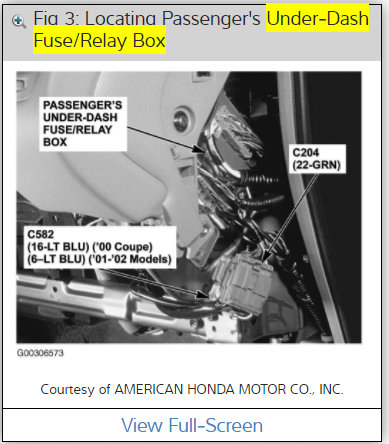

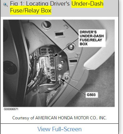

You should check each fuse with a test light or multimeter. Sometimes the fuse schematics does not list every circuit that is on that particular fuse so it is always best to check all of the fuse.
Here is a guide to help you see how to check the fuses
Here are the fuse panel locations and identification
Cheers

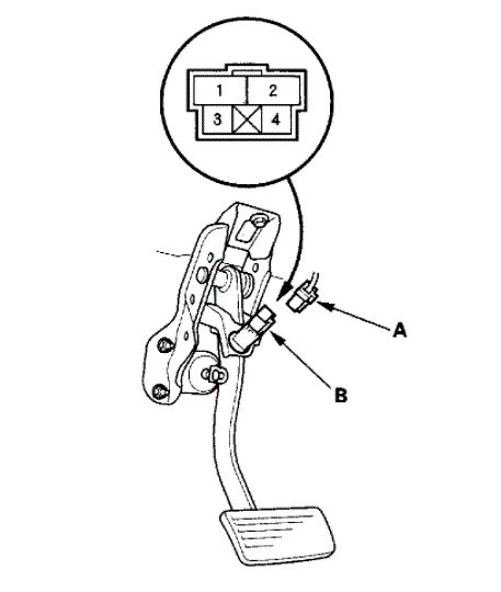

Good afternoon,
I attached a wiring diagram for you to view. You need to test for power to the brake light switch. In most cases, it is the switch that is bad.
1. Disconnect the 4P connector (A) from the brake pedal position switch (B).
2. Check for continuity between the No. 1 and No. 2 terminals.
There should be continuity when the brake pedal is pressed.
There should be no continuity when the brake pedal is released.
3. Check for continuity between the No. 3 and No. 4 terminals (with cruise control).
There should be no continuity when the brake pedal is pressed.
There should be continuity when the brake pedal is released.
4. If necessary, adjust or replace the switch, or adjust the pedal height.

i suspect and would check the brake light switch on the brake pedal.
May 17, 2021 at 5:02 AM (Merged)
G.SMOTHERS
Bruce- I replaced the brake light switch and I'm good to go. I really appreciate the help. :D

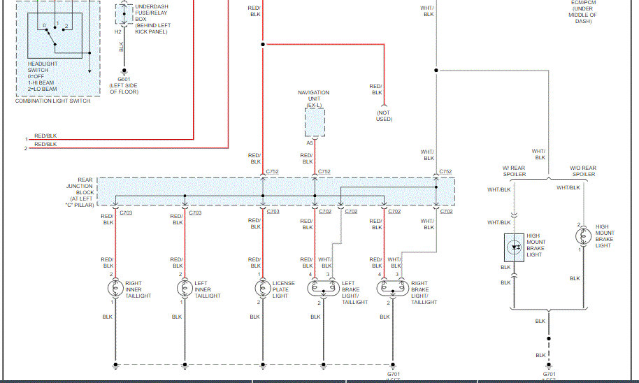

TATARIE

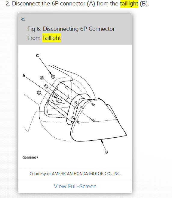

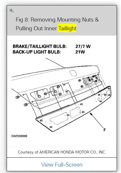

I recently bought a 1991 honda accord. the passenger side brake light didnt work, so i replaced the bulb..and it still doesnt work. could it be the wiring? how do i fix this?
KHLOW2008
  • 41,814 POSTS
Hi tatarie,
If the bulb socket is rusty, it would not provide good conductivity and the spring might be stuck resulting in the bulb not seating properly.
Is the bulb used correct? Double filament type.
The right and left are connected in parallel, so it should be the wiring at the taillights only.
