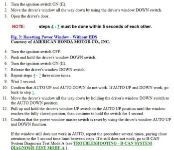

I've had my car for something like a year and a half now. It performs as well as I'd expected for the most part but it has this minor problem that could get me into quite a bit of trouble. Every now and then I'll leave my car with the windows competely closed. When I return the windows will be partially or completely rolled down. This doesn't occur all the time (maybe 1 in 15 times), but it happens often enough that I'm worried about the car being broken into or potential flooding from rain/snow...
Any suggestions?
Apr 6, 2009 at 3:53 AM
KHLOW2008
  • 41,814 POSTS

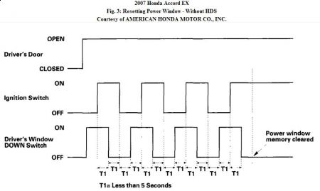

Hi kevsky2, Your vehicle should be under waranty and you sshould have the dealer have a look at it. Seems the muitiplex control system is malfunctioning. anyway I have attached a resetting procedure that you can try and see if it helps., if not you would have to refer to the dealer.
