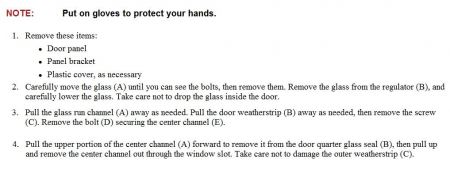

Hi.
Both rear windows on my Accord 07 EX Sedan are making this noise when going up and down.
I showed it to Honda dealer and they said will take $320 per side to replace regulators.
I ordered regulators online and have basic wrench and body panel trimming kit.
As per what I can do, since owning this car for past 3+ weeks I took off bumper to TRY repair a crack, changed engine oil, flushed power steering fluid and replaced all brake pads.
Do you suggest giving it a go at home and if so can some one point me to a DIY/scanned service manual pages for removing rear panel and regulators for my model.
Please suggest.
Thanks

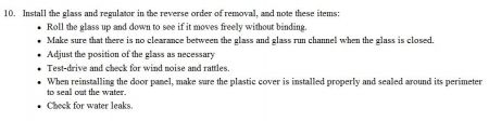

steps are below for replacing rear window glass regulator, let me know if you need further assistance with this repair..

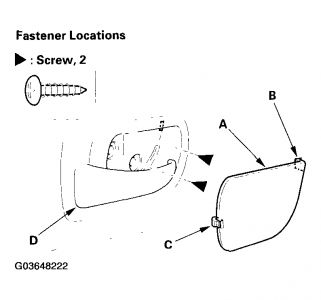

But am stuck at one of the basic things. I was able to take out the power window console from door handle but not sure how to take this cover.

no problem, first lower the glass all the way down. then use your trim tool to pry out on teh rear portion of the cover (A in pic) to release the hooks (B,C in pic), then remove the cover and the screws securing the inner handle on.

Thanks, I manged to scratch it before realizing I can use the small screw driver from my PC repair kit.
I changed both rear window regulators, checked windows they worked like new.
Thanks once again for the prompt reply.
