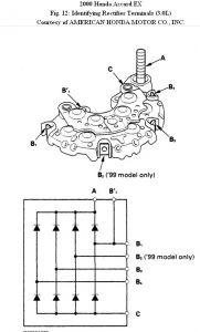

One more thing is there a way to get in the alternator and check it from the inside to maybe see if I could find something?
Friday, August 6th, 2010 AT 5:42 PM
KHLOW2008
  • 41,814 POSTS
The rectifier can be tested but not the voltage regulator.
RECTIFIER
Check for continuity in each direction, between the B terminal "A" and P terminals "B", and between the E terminal "C" and P terminals of each diode pair. See Fig. 12. All diodes should have continuity in only one direction. Because the rectifier diodes are designed to allow current to pass in only one direction, and the rectifier is made up of 8 diodes (4 pairs) (6 diodes (3 pairs) for 2000-03 models), you must test each diode in both directions for continuity with an ohmmeter that has diode checking capability: a total of 16 checks (12 checks for 2000-03 models). If any diode is faulty, replace the rectifier assembly (Diodes are not available separately). If all the diodes are OK, go to BRUSHES inspection.
http://www.2carpros.com/forum/automotive_pictures/192750_Rectifier00AccordFig12_1.jpg
