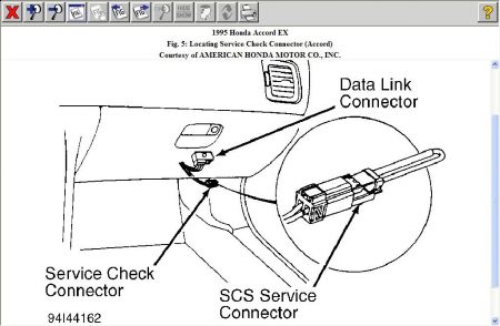

Bridge the SCS connector and read the blinking of the CEL to get the DTC. Let me know what you find.

Ok I got the trouble codes I think I have 2
I have 7 Quick flashes Then I have 2 Long 1 med and 1 short. Tried to go to my local autozone or auto supply to plug in diagnostic tool but nobody has one.
Hope this helps Thank you very much for feedback
Jeff
Thursday, April 2nd, 2009 AT 9:06 PM

Hello again I have found the first trouble code sensor came unplugged fixed it. The other code I have figured out is a code 22 which according to a site I found online is faulty or bad Oil Pressure Switch a.K.A. Vtec pressure switch. So I am looking in at replacing have to special order on saturday should be here monday or tuesday will inform you if problem is solved or persists. Thank you so much for your help I love this site already. Thank you again.
