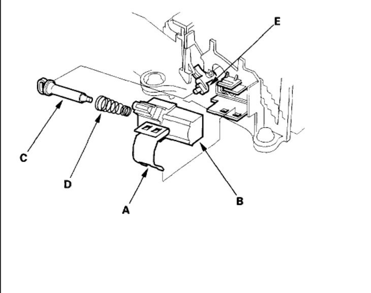

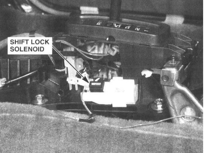

I have a 2000 Honda Accord and the gear shift is stuck in park. When I turn the car on and press the brake in order to shift into drive, the grear shift doesn't move. it's like the button is stuck or something.
Mar 20, 2010 at 10:39 AM
  • 55,224 POSTS
It sounds like you have a shift interlock solenoid that is getting weak or not working.
Here are some diagrams to help you get the problem fixed.
Test the electrical circuit with the key on
Jul 12, 2017 at 1:01 PM

I own a 2002 Honda Accord. The gear shift is stuck in park. How should I fix the problem.
Jul 12, 2017 at 1:02 PM (Merged)
KHLOW2008
  • 41,814 POSTS
Hi brobertson,
Check if the brake lights are coming on with brakes depressed.
When the interlock malfunctions, the most likely fault is a bad brake switch or blown fuse.

My gear shift is stuck in "Park". I can unlock it using the key in the console keyhole, but what do I need for a permanent repair?
Jul 12, 2017 at 1:03 PM (Merged)
  • 75,992 POSTS
Get the shift interlock control system checked out-could be the brake switch or shiftlock control solenoid.
MMPRINCE4000
  • 8,548 POSTS
There is a brake lock solenoid that prevents the shifter from moving unless the brake pedal is pushed. This solenoid/switch is out of adjustment/broke.
There should be an override button on the shift console that you can push and hold to get out of park.
Use the car repair link or get a Haynes manual, but first read the owners manual and see if it tells you the location of the switch.

Seems the interlock system is malfunctioning and possible causes are :
1. Faulty brake switch. Check if the brake lights are working when the shift is stuck in Park. If not, you need to tst if the brake switch is faulty, it could be intermittently not working.
2. Interlock shift solenoid. If the brake lights are working and the shift lever is stuck in Park, with ignition key turned to ON, depress brake pedal and listen for a clicking noise near the gear shift. If there is no noise, either there is a malfunctioning soleanoid or wiring circuit.
If there is a clicking noise and you are not able to shift out of park, the solenoid could be restricted and not moving far enough for the locking tab to be moved to allow the shift lever to be moved out of Park.

Hi! I have a 2000 Honda Accord SE (6 cyl. engine...), automatic, with 99,200 miles. The car will start but wont move out of park. The brake lights also stopped working. My mechanic says stoplight switch needs replacing so I am waiting for the part. Should that take care of the gear shift problem too?
BRUCE HUNT
  • 3,754 POSTS
If he ordered the Honda replacement one that should do the trick.
CARRIE
[quote:88bafbefb1="Bruce Hunt"]If he ordered the Honda replacement one that should do the trick.[/quote:88bafbefb1]
It took care of it! I reccomend people to replace this part yourself; if your car is similar to mine it only took at max 5 minutes and I saved $20 buying the part myself and $65 in labor. My car has also been not performing as well and I replaced the spark plugs (easy enough to do yourself as well) and it seems to have improved that aspect as well. Yay! :)
