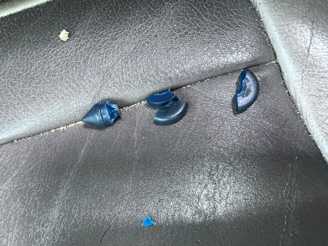

Honda Accord 2000 SE. Morning, I tried to start the car but it won't. Upon investigating i found some broken parts under the steering wheel which turned out to be brake pedal stopper. I guess replacing that will solve the problem. Is it also possible that the battery is completely drained out?

Yes, if the stopper is messed up it can hold the lights on draining the battery out. Can you please upload a picture of what you are seeing?

Here is what i found underneath.

Yep. that will do it, that is the brake pedal stopper. Here are some new ones for you.

Out of stock at auto shops near me. Amazon will deliver it quickest in 3 days! This is so stupid. The brake light must have drained my battery. Now every time I walk out of my car, I need to check the floor for broken pieces or my brake light or is there some other way to detect this?

It's a good idea to keep an eye on the car but this is a rare problem, but should be fixed rather easily.
