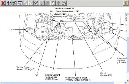

Where is the cooling fan sensor located?
Apr 29, 2008 at 4:06 AM
  • 75,992 POSTS
See below
https://images.2carpros.com/forum/automotive_pictures/12900_ect_4.jpg

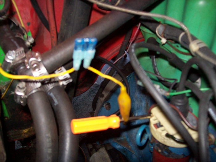

Engine overheating as radiator fan doesn't come on. Condenser fan works.
Fuse good. Swapped relays no diff. Powered fan straight from battery and it works fine. Upper rad hose gets hot after engine warms up. Jumpered the cable that plugs into the temp sensor and when I turn on AC both fans run. Thus I think it is temp sensor but my friend says there is a switch on the rad and the engine and one is bad. I can't find any switch and have no manual. Am I right that it is temp sensor or is it a fan switch and if so can I test the switch and where is it? Accord EX 4 cyl. Thanks!

Check and test the coolant temperature sensor could also be the computer controlled of the fan relay

Hi Bill Leach,
Unplug the fan switch located on the thermostat housing and use a jumper across the wire harness terminal and turn ignition switch ON. Does the fans comes on?

BILL LEACH
Yes the fan does start when I jump out the fan switch. I noticed bottom rad hose cool leading to the themostat. Is this telling me that it is stuck closed or not working at all. Top hose is hot as is rad iator

KHLOW2008
  • 41,814 POSTS
You have 3 possible causes for the condition which is due to insufficient or no coolant flow in system.
1. Bad thermostat. Stuck in closed position. This would be the most likely cause. Use a water to test the thermostat to see if it opens.
2. Faulty water pump.
3. Clogged radiator.
