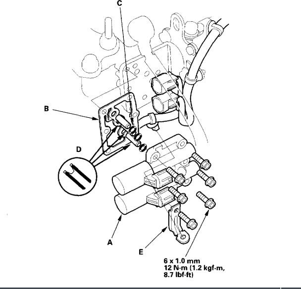

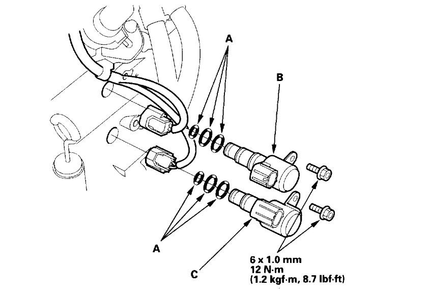

Below are the pictures for the solenoids A, B, C and the pressure solenoid.
You will need to call Honda for the part numbers as they have changed since the update in my system.

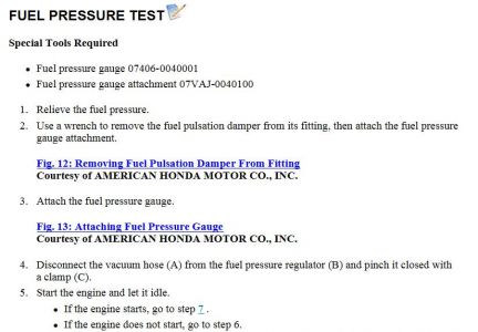

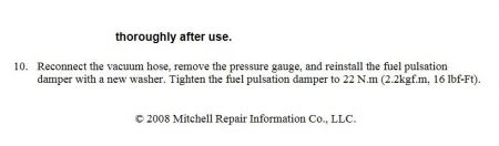

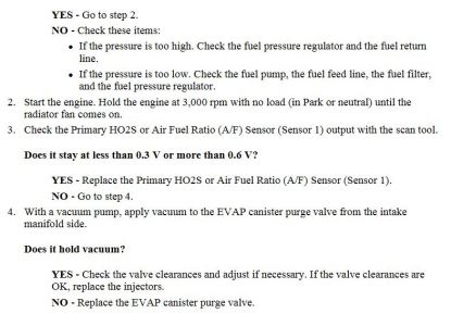

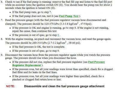

Here are the diagnostics for P0172.
https://www.2carpros.com/forum/automotive_pictures/192750_P0171_00Accord4cyl01_1.jpg
