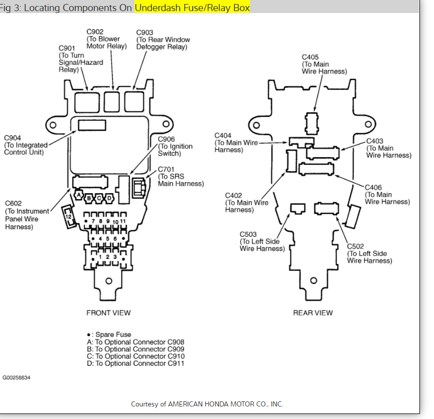

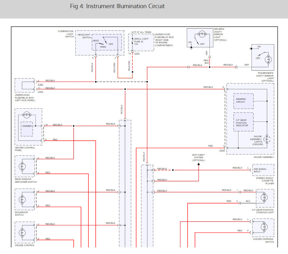

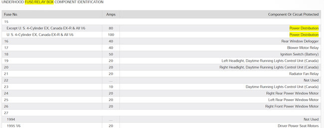

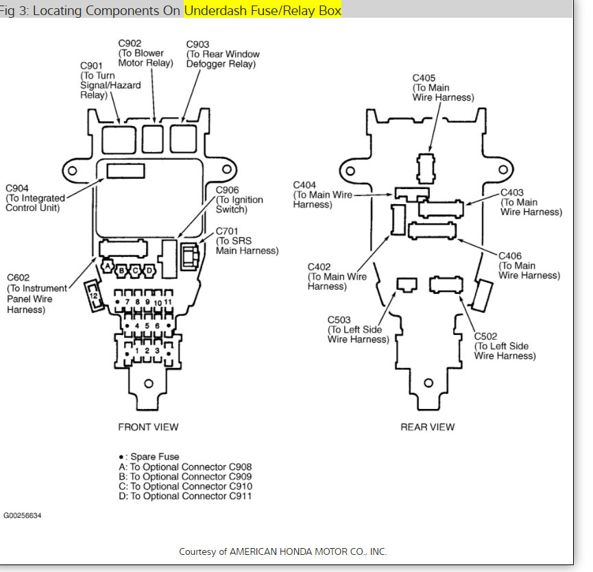

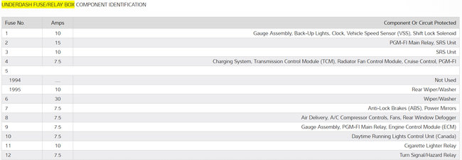

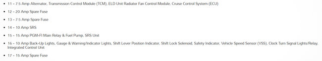

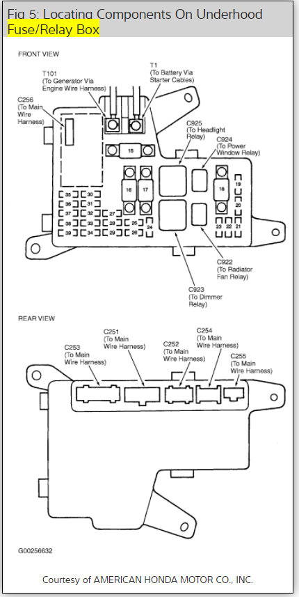

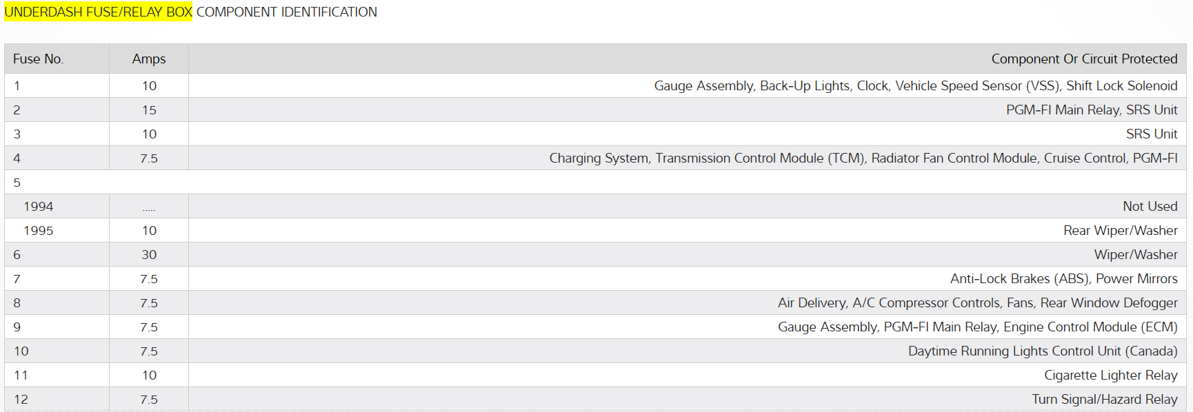

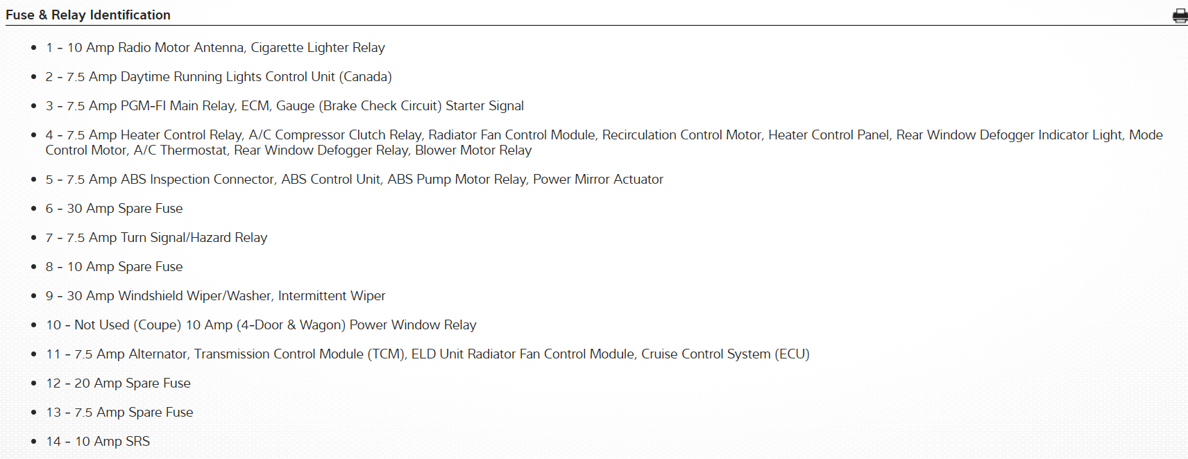

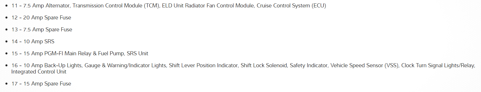

All dash lights are not working so I set out to check the fuses. Would you believe that the interior and exterior fuse identification charts in the owners manual do not have a listing under "dash lights" "gauges" "instruments" etc.?? It can't be this complex but I'd sure like to know which fuses protect the dash lights.
Any ideas?
Sep 14, 2009 at 11:30 AM
F4I_GUY
  • 3,302 POSTS
It is called a small light fuse here is a guide to help test ti and the fuse locations below along with the wiring diagrams so you can see how the system works.

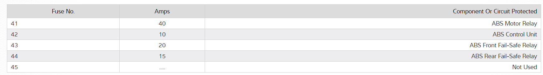

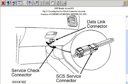

I have had several warning light issues and then more recently (last few Days) the speedo and gear lights been playing up too.
1/ Had ABS brakes fixed but warning light still on.
2/ SRS light stays on although had that checked at same time as ABS fixed and light still on.
3/ Was driving the other day I had the cruise on and it suddenly turned off causeing the car to slow and the speedo needle dropped to 0 then when i hit the acceelerator the needle moved back to current speed.
4/The 4th gear light starts flashing on and off. it starts flashing speratically untill i turn engine off and restart.
5/ Now the speedo does not start working until i have been driving for 5-10 mins then it just starts working and stays on most of the time but then goes to 0 for short periods.
Aug 1, 2019 at 10:19 AM (Merged)
KHLOW2008
  • 41,814 POSTS
Hi DMConlon, You need to retrieve the ABS and Air Bag Diagnostic Trouble code to find out what is wrong. Like wise with the D4 light DTC as well. However the Speedometer not working should be ths cause of the D4 light blinking. The speed sensor, located under the thermostst housing on tran housing is faulty and needs to be replaced.
https://images.2carpros.com/forum/automotive_pictures/192750_SCS95Accord_4.jpg
Bridge the connector, turn ignition switch ON, and count the flashes of the various indicator lights fo rthe code. prolonged flashes = 10 while short fast flash = 1.

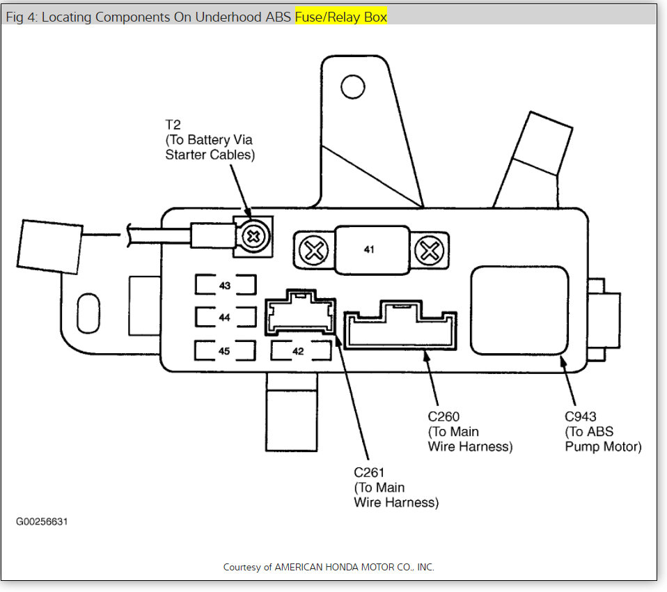

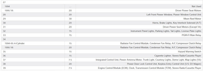

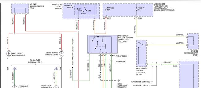

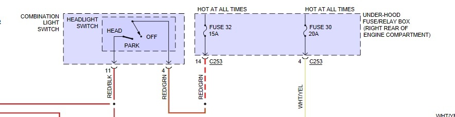

i have a 96 honda accord and have no dash lights or running lights or brake lights i checked fuses and found 2 under the hood bad put in 2 new ones but they blow to
  • 110,244 POSTS
You have a dead short. Start by unplugging the headlight switch and see if the fuse still blows.
Let me know what you find.
MRHILL41
  • 6 POSTS
I replaced the fuse an the light switch but my back lights an dash is still dark
JDL
  • 16,098 POSTS

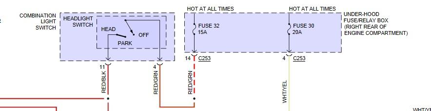

Did you check for voltage at the fuse circuit? Use a testlite. When you backlamps are you talking the tail lites?

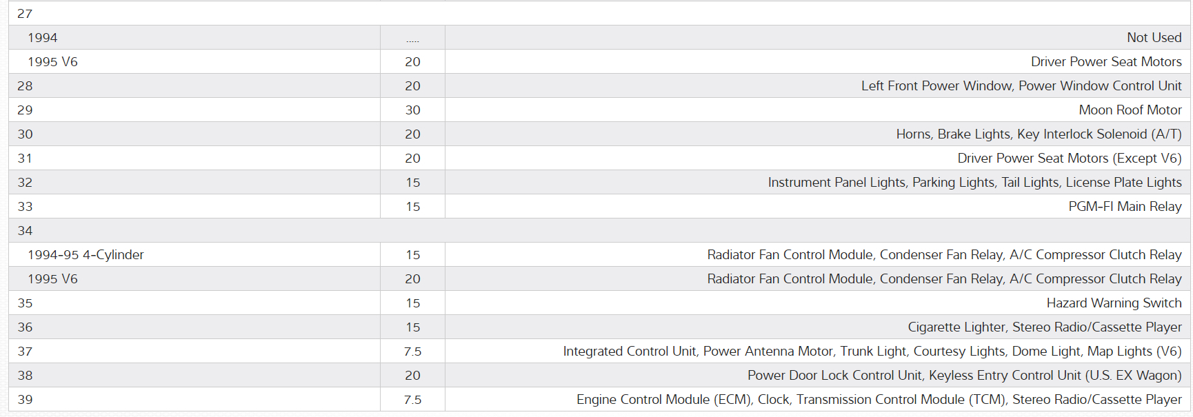

JDL
  • 16,098 POSTS

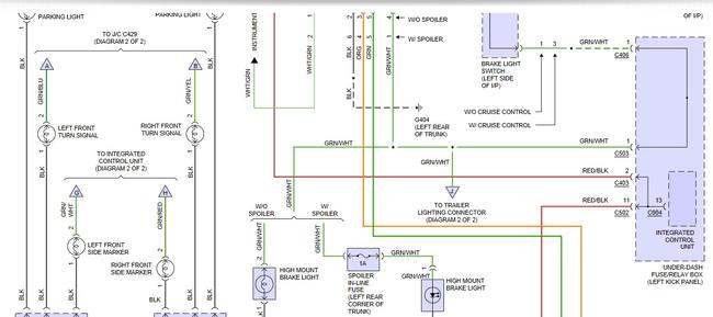

Check fuse 32--15 for voltage. Note the diagram. At the tail lamps, red wire with black tracer is voltage. Black wire is ground.
JDL
  • 16,098 POSTS
I looked at your instrument cluster illumination and it is the same fuse, so check for voltage at the fuse circuit. If there is voltage sounds like a wiring circuit problem.

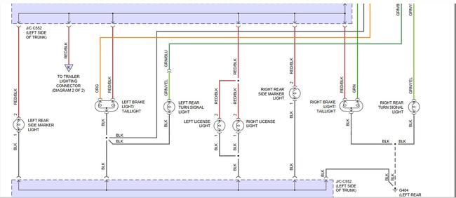

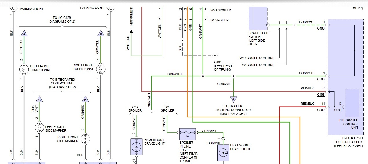

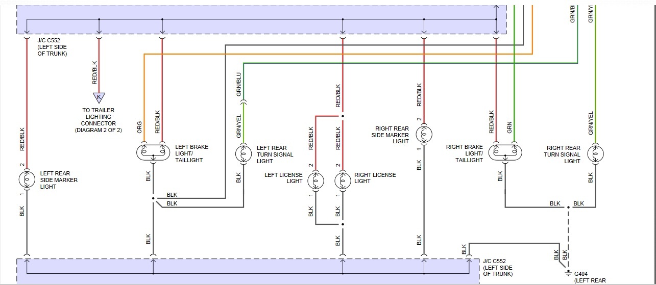

Can u send me a back light diagram
JDL
  • 16,098 POSTS
This is for the tail lights.

DENNIS234
Where is the fuse, located for the dashboard ligts

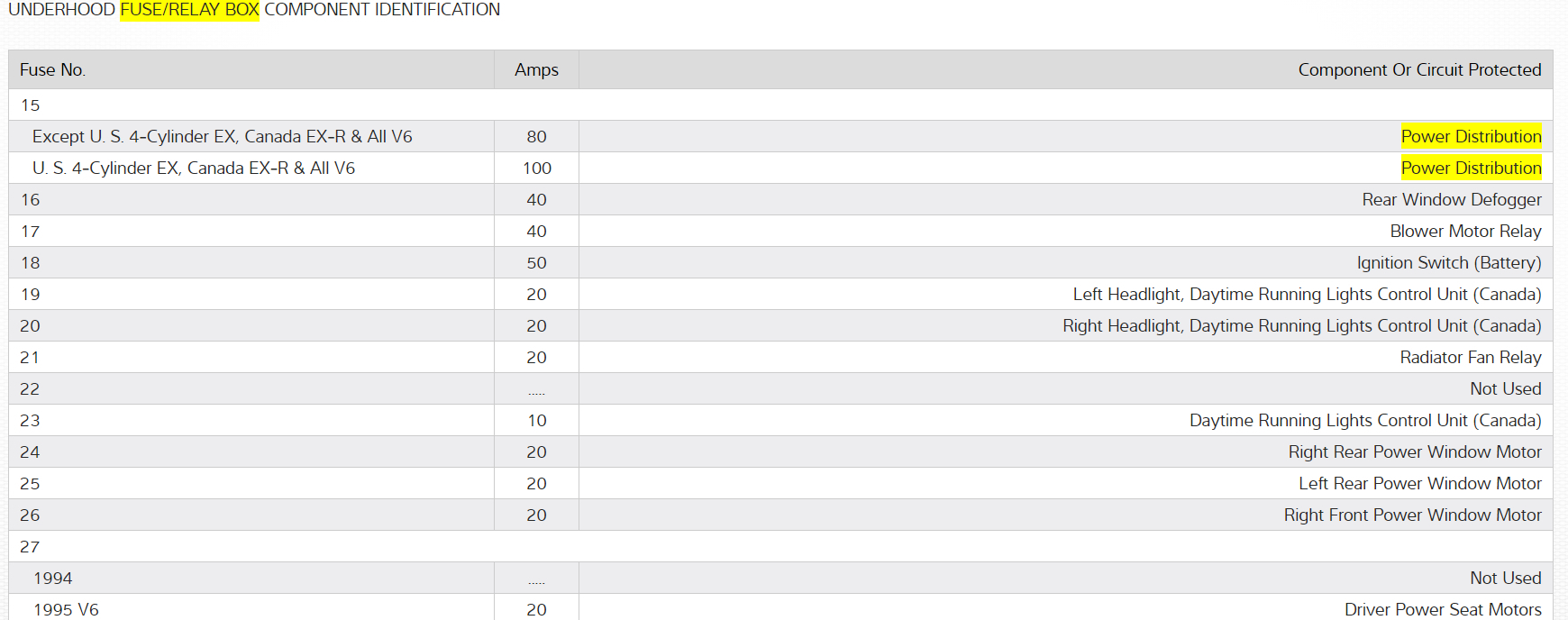

KHLOW2008
  • 41,814 POSTS
Hi dennis234,
If the taillights are not working, then it could be the fuse. # 32 ( 15A ) under hood.
If not, you need to check the integrated control unit and/or meter cluser.
