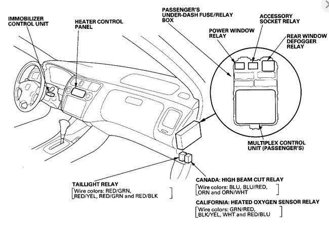

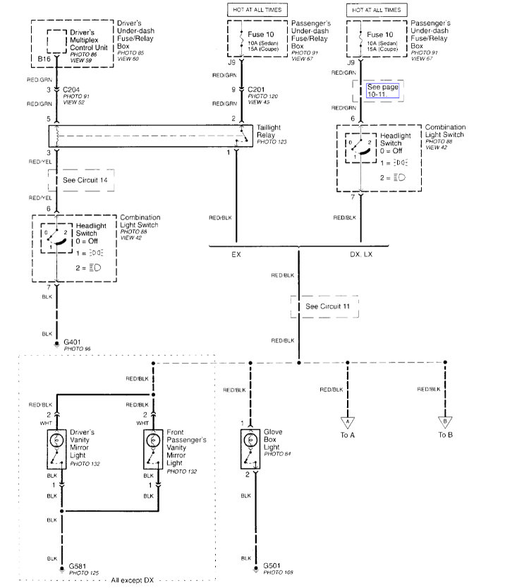

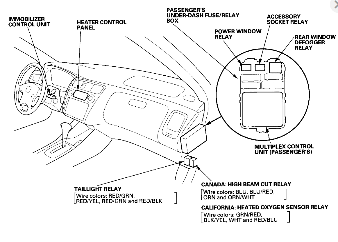

My dash lights has gone out with my clock in dash for my 98 Honda Accord. How do I fix it?
Monday, March 9th, 2009 AT 2:21 PM
SQM
  • 6,383 POSTS
There is a fuse in the fuse block under the dash on the passenger side, that controls the dash light for your vehicle.
That should be the first item to check.
If the fuse is good, then it will be a wiring issue.
I have attached the diagram for your reference.
