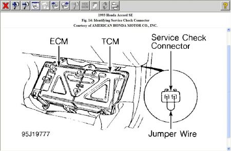

Use a jumper wire to bridge the SCS connector and count the blinking of the D4 light to retrieve the Code.
