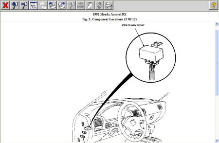

Remove the PGM-FI main relay and resolder the cirsuit board, replacing the solders if necessary and retest.
https://www.2carpros.com/forum/automotive_pictures/192750_PGMFIRelay92Accord_12.jpg
