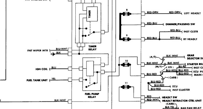

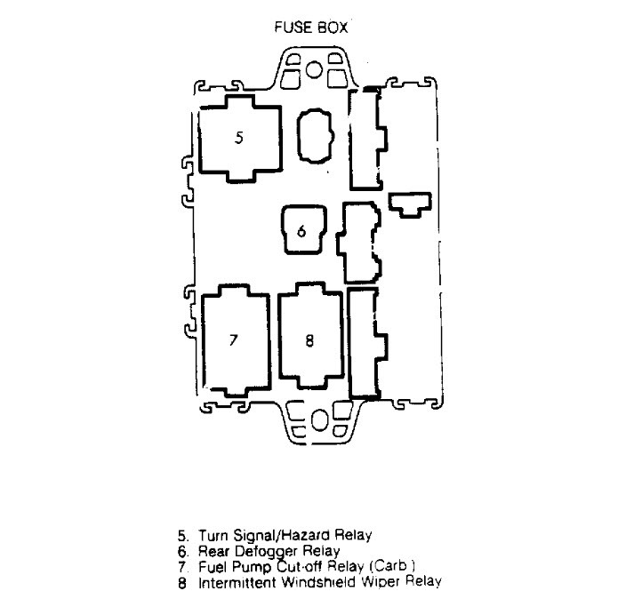

MOTOMAN1976
whereis my fuel pump relay and my fuel cutoff relay
Nov 23, 2018 at 10:51 AM (Merged)
KHLOW2008
  • 41,812 POSTS
The fuel pump (main ) relay is located underdash just above the fuse box. It is a 7 pin grey box with brown socket points.
JWM1120
  • 6 POSTS
KHLow2008 - Bingo, that's what I was looking for I think.

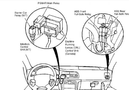

KHLOW2008
  • 41,812 POSTS
Hi nando39, CEL = Check Engine Lamp. Are there any sparks at the plugs? If yes, then you need to check the fuel circuit. The PGM-FI main relay might be intermittently failing resulting in no power supply to the fuel pump.
https://images.2carpros.com/forum/automotive_pictures/192750_PGMFIRelay97Accord_2.jpg
Test for power output to fuel pump for 2 seconds when igniton switch is turned ON.

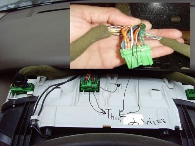

NANDO39
  • 13 POSTS
here is a pic of the 2 wire that I applied + voltage and I blow the fuel but I replace the fuse but no want to run. white/silver dot and a black/white line. is there a in line fuse that Im missing? I check under the hook driver and pasenger side for fuses,all Ok .
https://images.2carpros.com/forum/automotive_pictures/282543_car_2.jpg
hope you can help me

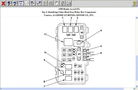

KHLOW2008
  • 41,812 POSTS
Hi nando39, No, the 50 A fuse is under hood Fuse # 42. Guess that is not the cause as it is the main power supply to the ignition switch.

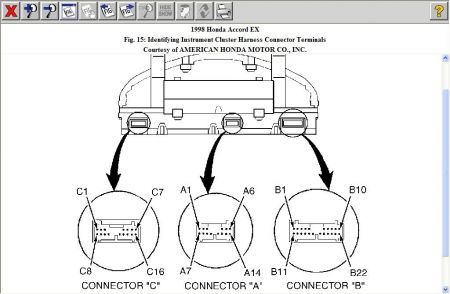

https://images.2carpros.com/forum/automotive_pictures/192750_FuseBox98Accord4cylHood_1.jpg
From the connector can you please tell me the pin # location. I seem to have different wire colors for my diagrams.
https://images.2carpros.com/forum/automotive_pictures/192750_MeterConnector98Accord_1.jpg
I will do some research and see if I can pinpoint the cause. Ok, I now understand which 2 wires you are refering to. 1. A10 = interior light circuit 2. C4 = Reverse light going to the gear shift. From the circuit, there should be no connection to the fuse. From where did you tap the battery voltage to initially blow the fuse? What is the fuse location that blows initially?

I suggest we go back to the basics to understand what is happening. I would like you to provide me with some information with the following tests before we continue further.
1. Attach a test lamp to distributor Black/Yellow and turn ignition switch to ON. Battery voltage must be available.
If not, check Fuse # 1. If ok, test ignition switch black Yellow wire for voltage, must have voltage, if not switch is faulty.
If above ok, crank the engine. Voltage must be available. If not, ignition switch is faulty.
Sparks must be available at the plugs. If not, either distributor is fasulty or PCM grounding is inappropriate or PCM is faulty.
2. Attach a test lamp to PGM-FI main relay terminal # 2, ( Blue/Orange wire) Lamp must light up while cranking. If not, check fuse # 13 ( 7.5 A )
3. With ignition switch turned ON and while cranking, battery voltage must be present at terminal # 4.
4. Attach test lamp to PGM-FI relay terminal. turn ignition switch ON. Lamp must light up for 2 seconds.
Item 1, 2 and 3 above must be ok before this test needs to be done. If no power supply, relay is faulty.
