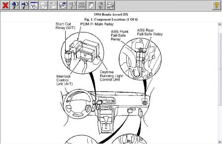

92 Honda Accord 4 cylinder no fuel pressure. Checked pressure regulator with clear vacuum line and looked ok, fuses inside are good, so I replaced the fuel pump. Car still doesen't run. Is there a relay or other check I can do ? no fuel pressure at the fuel rail and I cannot hear fuel pump kick on for 2 seconds when you turn the ignition like it is supposed to. Please help !!!

You need to inspect and test your fuel injection main relay it powers the fuel pump thru the yellow wire at pin 4 at relay.

Can you give me an idea of where the relay is located and how it looks ? How many wires or some description to be sure I have the right one ? Thanks.

Behind left side of dash see below

Thank you ! The information was fast and helpful ! The diagram you showed me for a 94 accord makes it look like the relay is to the right of the steering wheel, and on a 92 model it's on the left kick panel above the fuse box. Once I found it and tested it, it was bad and replacing it did the trick ! Thank's again, B.W.
