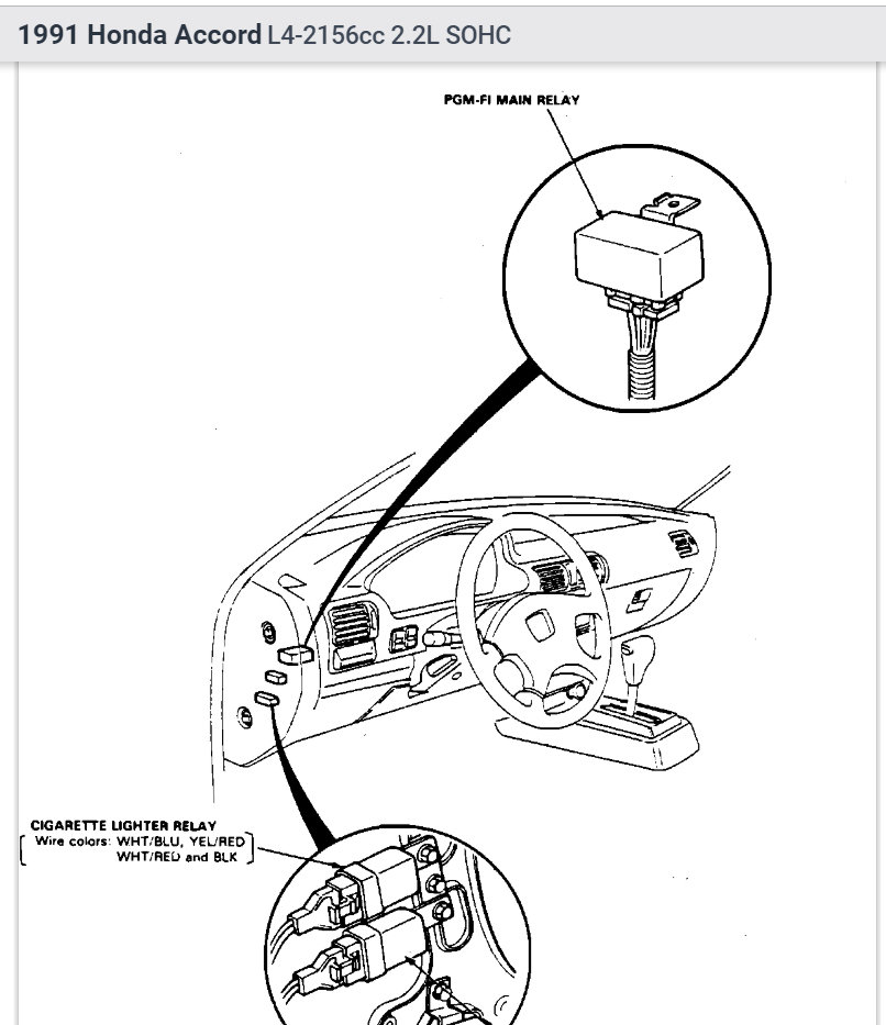

Can't find the fuse for the fuel pump. Know where it is ????
Apr 25, 2009 at 10:10 AM
  • 75,992 POSTS

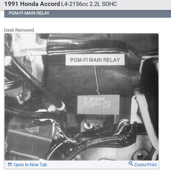

There's no fuse for it the PGM FI main relay powers it when the key is turned on here is a guide to help you test the relay and diagrams below to show you the location.

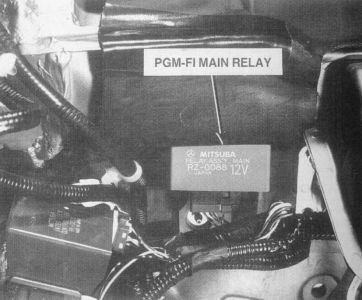

The PGM-FI main relay powers the fuel pump and the fuel pump is in the fuel tank
https://images.2carpros.com/forum/automotive_pictures/12900_mr_1.jpg

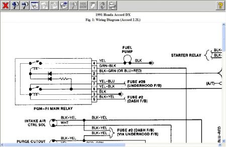

I have a 91 Honda Accord DX and when I start it I lose power to the fuel pump. I am thinking it might be a relay problem. I don't know where the relay is. Can you help me?
Nov 23, 2018 at 10:51 AM (Merged)
  • 75,992 POSTS
Test the PGM-FI Relay it powers the fuel pump-see below

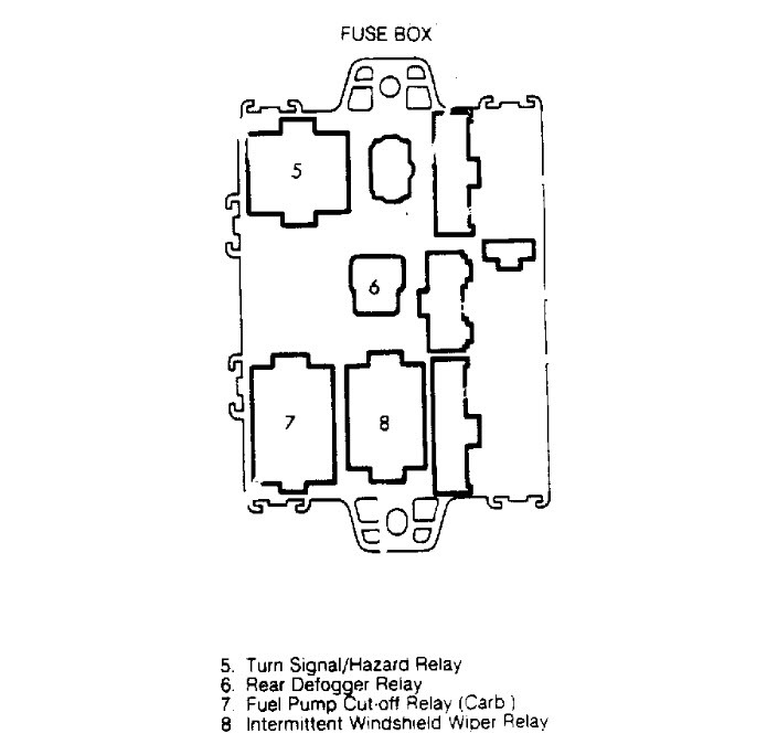

Do I have to have a fuel pump relay in fuel system wiring? If I connect my fuel pump to a toggle switch that I can turn off and on, will everything work ok? What stops the fuel pump from overflowing the carb bowl and continuously pumping? Is that what the relay does? I have an 87 Honda Accord DX but have removed the factory carb. I have a Weber 38 on it instead.
HMAC300
  • 48,601 POSTS
yes you do it's under the dash on left side pic included.

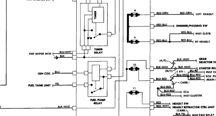

I swapped out the relay and it still didn't work. If I jump it, it does work. If I run a seperate wire from the ground terminal to a ground spot nothing happens. The relay has 4 terminals +,-,Fuel Pump, and Ignition. I'm not getting power to the ignition terminal. That's why I wanted to wire a switch in seperately. Could it be my oil pressure switch is malfunctioning? It is a carb car, no ecu. How does the fuel pump get a signal from oil pressure?
HMAC300
  • 48,601 POSTS
ok yours is a little different. in the pic i've included the yellow wire goes to the fuel pump. the blue comes form the ignition coil and balck to ground. the other wire goes to fues 1 and should power up with thekey on. if one of these aren't working like the power up an dignition coil your pump wont' work. you can test these with a test light. It may be a bad connection or broken wire on any of these.

For carburetted engine, there is an ECU, Emission Control Unit, which controls the various solenoids and valves but is not related to the fuel pump relay.
If you do not have any power from the ignition terminal, that is the problem you need to address. Ignition terminal receives its pulse from the ignition coil and would only work while engine is being cranked or is running.
Oil pressure switch is not related to the fuel pump relay operations.
Check the continuity of the Blue wire from ignition coil. If the tachimeter is not working, the ignition coil could be faulty.
Using a toggle switch works but is not safe as the fuel pump would not cut off when engine stalls and that is a safety hazard.
