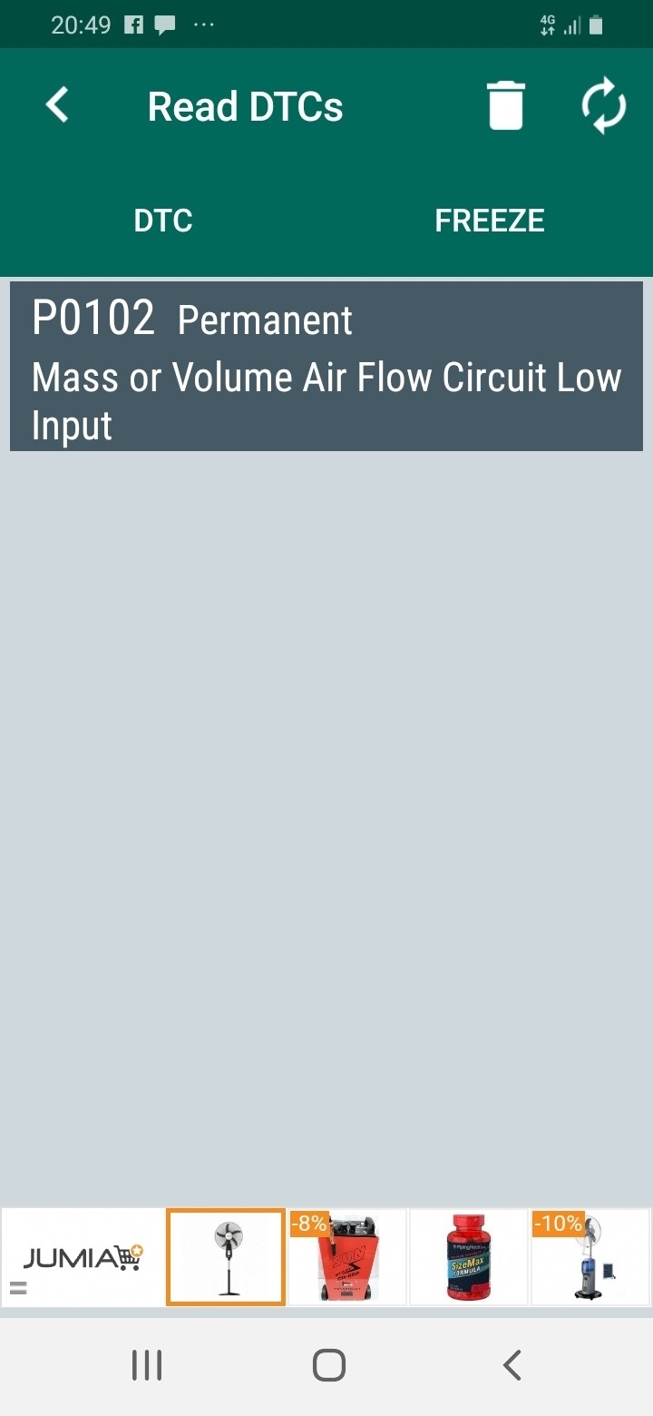

Error code: P0102 Permanent Mass or Volume Air Flow Circuit Low Input.
May 23, 2020 at 6:59 PM

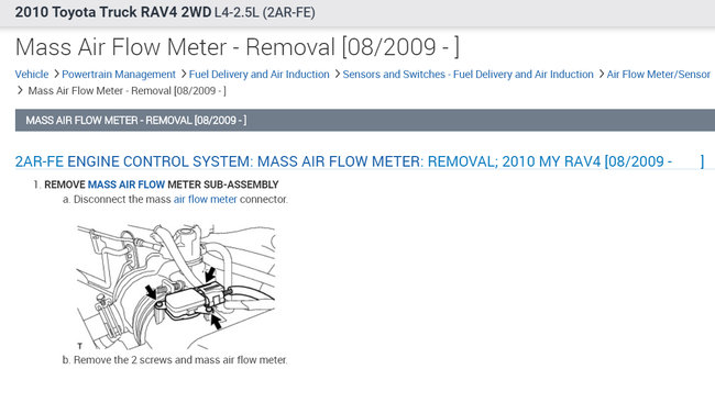

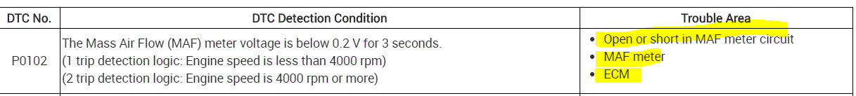

There are a few things that can cause this. I have the diagnostic flow chart which requires a specific type of scan tool. If you look at the attached pic, it shows possible causes. If you want, I can provide the directions. However, I don't want to overwhelm you if you are not comfortable. LOL It's extensive.
Let me know if you want me to send them to you.
May 24, 2020 at 11:36 AM

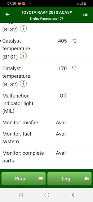

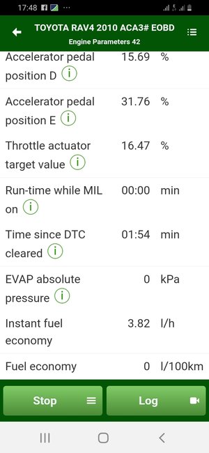

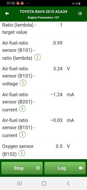

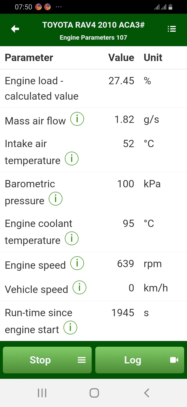

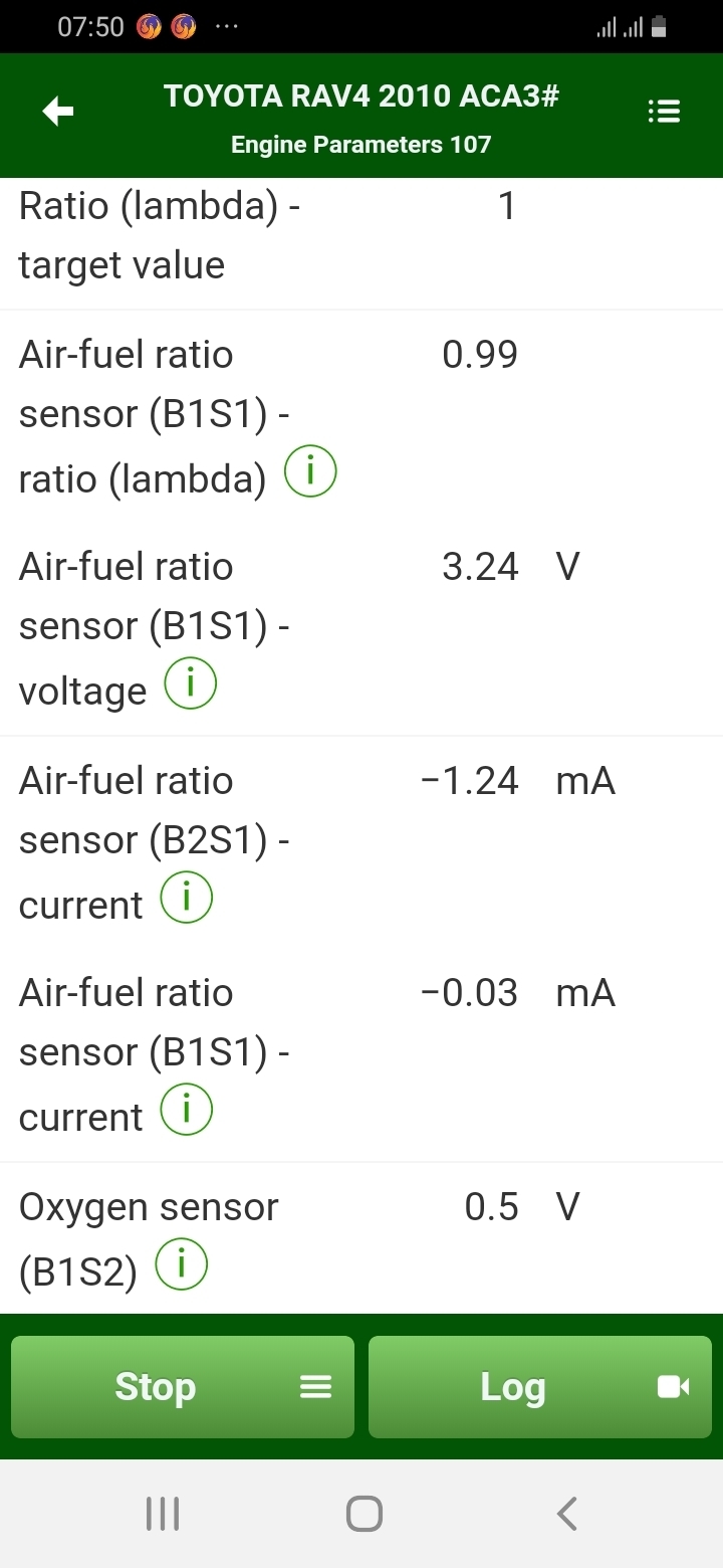

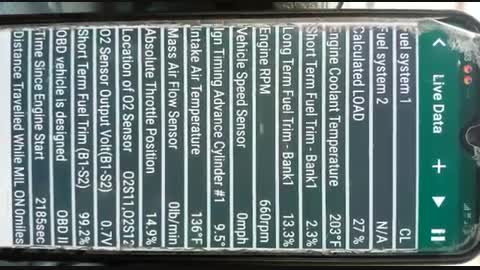

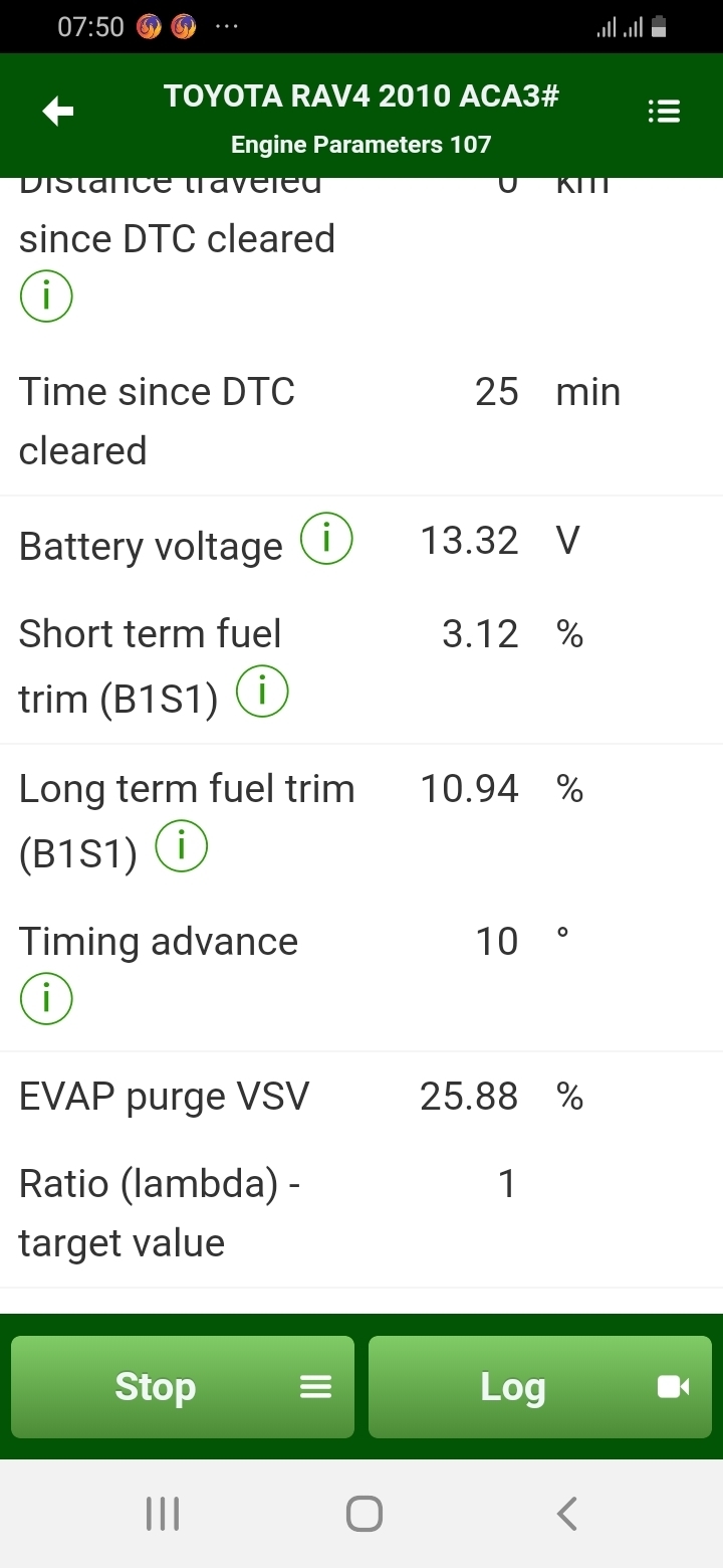

Here are the readings I got from the obd2 scanner I use. please can you look at it and tell me the area I need to lookout for? Please find attached of obd2 reading.
Thanks for your response.
May 26, 2020 at 6:51 PM
  • 110,241 POSTS
Okay, the fuel trims indicate the computer is adding fuel to the air/fuel mixture. I noted the oxygen sensor is a .5. That is normal, but it should be fluctuating up and down between .1 and .9. Is that happening? Also, do you have the engine coolant temperature sensor's reading? That's the only one I didn't see.

Okay, please fine attached for the engine coolant temperature sensor reading 90c.
Thanks waiting for your response.
May 27, 2020 at 3:31 PM
LUCKY EMEFE
  • 6 POSTS
For the oxygen, I will check it and see if it moves between 1 to 9 and get back to you.
May 27, 2020 at 3:43 PM
  • 110,241 POSTS
The temperature (if that was operating temperature) is nearly perfect. Let me know about the O2 sensor and if there are any other symptoms you can think of that could help.
May 28, 2020 at 1:40 PM
LUCKY EMEFE
  • 6 POSTS

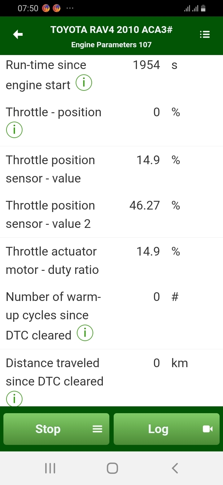

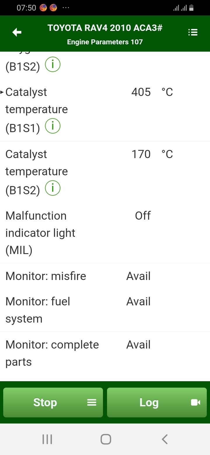

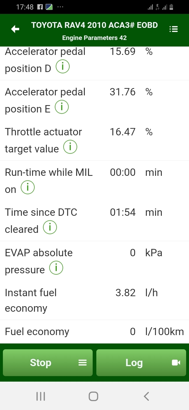

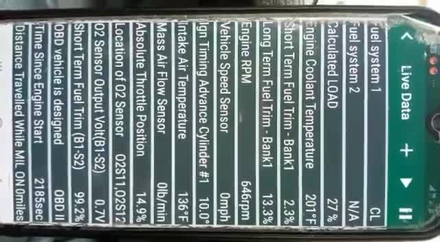

Hi, please find attached of the OBD2 data readings,order symptoms is that when I engage on drive the engine will be vibrating at idle.
May 29, 2020 at 1:54 AM
  • 110,241 POSTS
Everything there looks normal. Have you had the chance to check the O2 sensor?

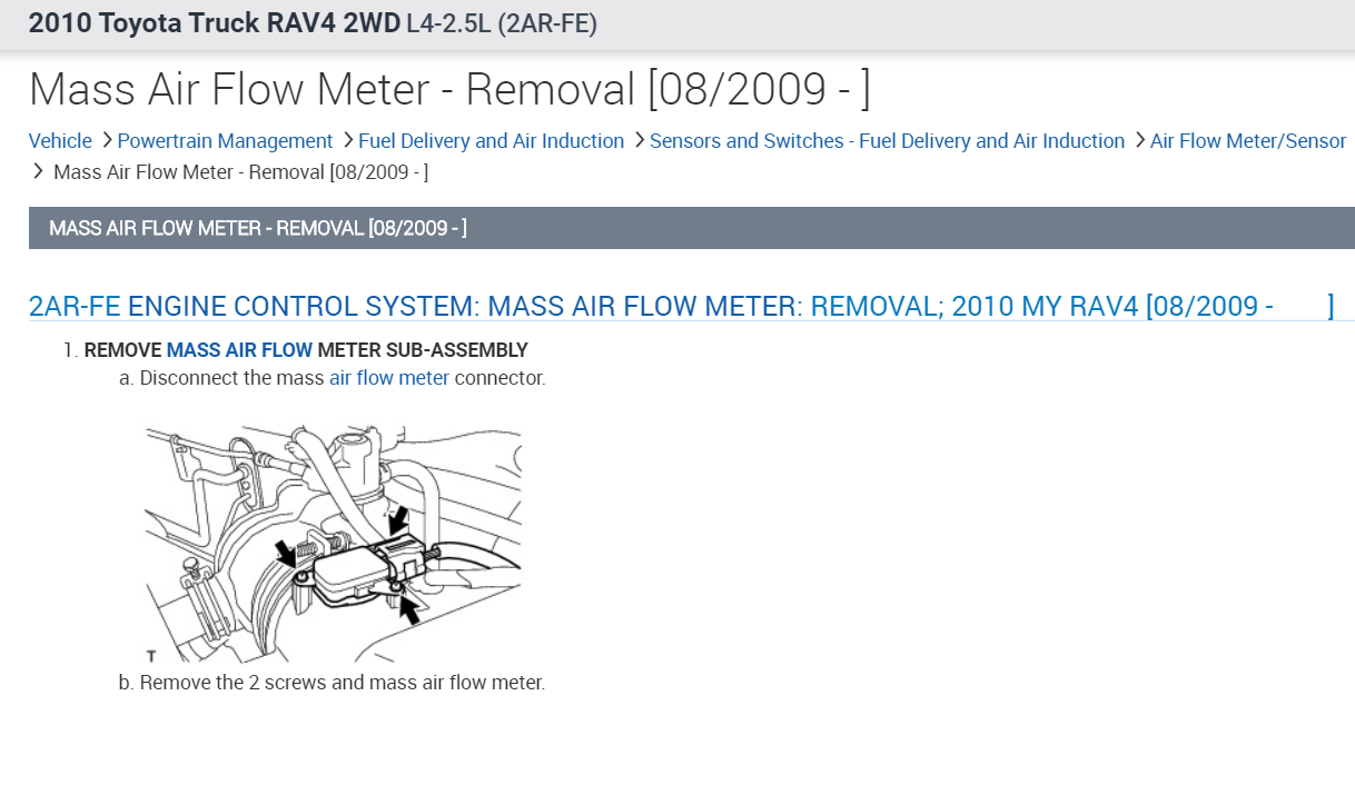

If I may, 9 times out of 10 it will be the MAF sensor due to contamination of the hot wire. At this point you are best to replace it. here is a guide to help walk you through the steps with instructions in the diagrams below to show you how on your car:
https://www.2carpros.com/articles/how-to-replace-a-mass-air-flow-sensor-maf

Hi,yes I have change the air filter and the MAS airflow sensor. my car average MPG has come back to normal. I am now getting 21 mpg, you guys are the best.
Thanks very much I appreciate your support.
