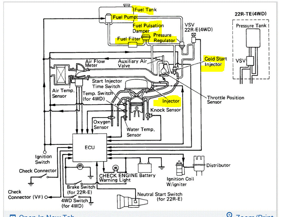

The electric fuel pump could be causing issues. If the pressure is too high, the needle and seat in the carb can cause it to receive too much fuel and run extremely rich or even flood.

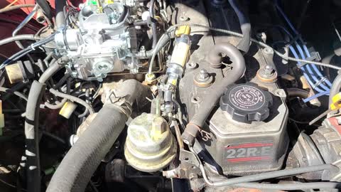

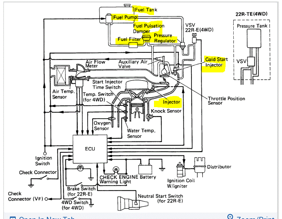

Is it possible for you to take a few pics of the carb, pump, or anything you think may help me? Looking through manuals is very limited and offers different set-ups.
If you look at the pic below, you'll see what I mean. It shows an electric fuel pump in the fuel tank, a pressure regulator, and fuel injection. I have to try and figure out how things have been changed.

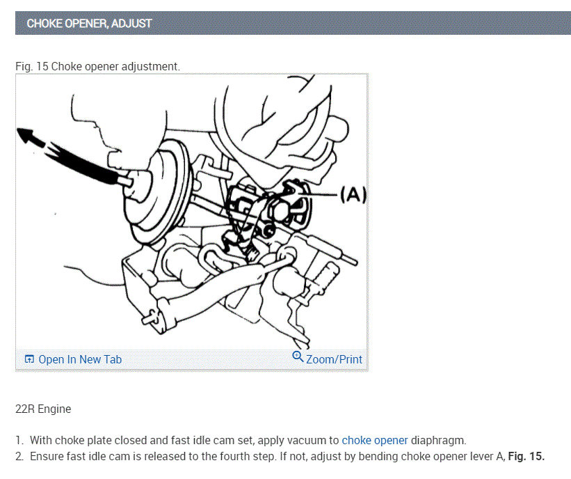

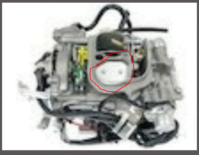

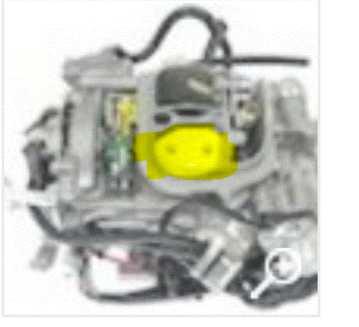

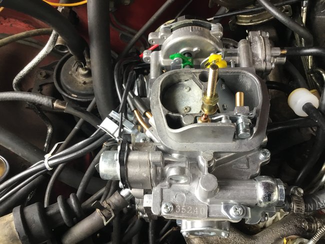

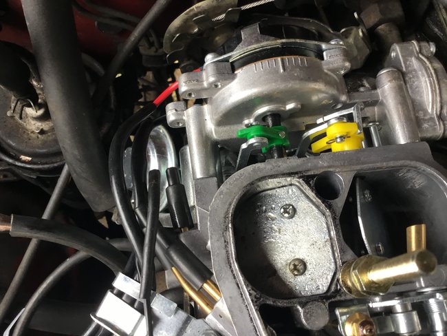

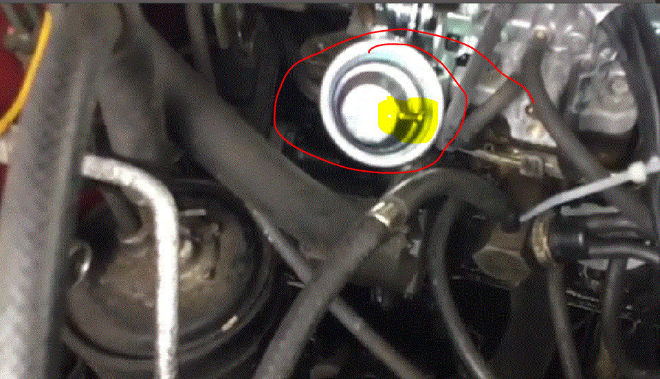

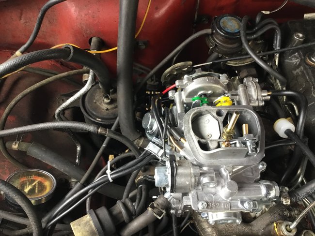

Since the problem starts when it gets warm, have you checked to make sure the choke is fully opening?
I copied your pic above and highlighted the choke.
Let me know. Also, let me know if all vacuum hoses are going to the carb. it may have a vacuum choke pull-off.

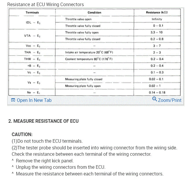

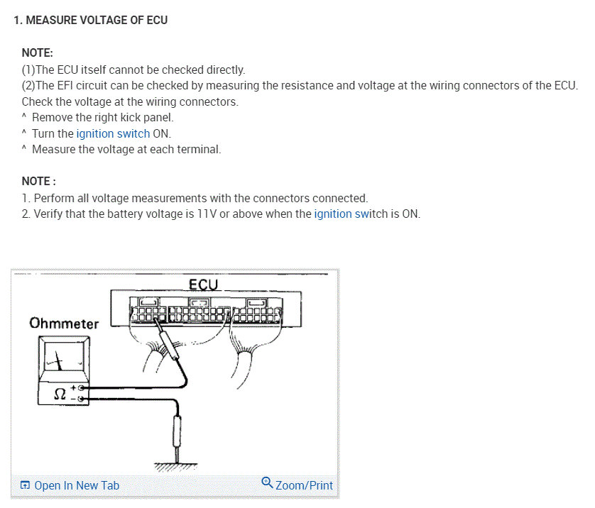

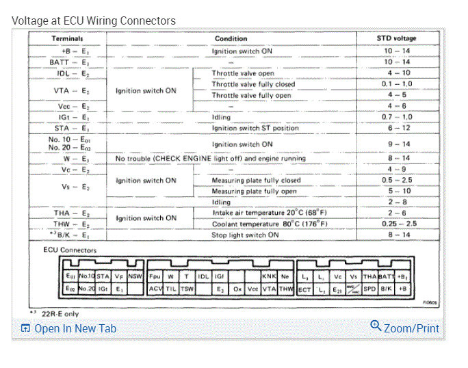

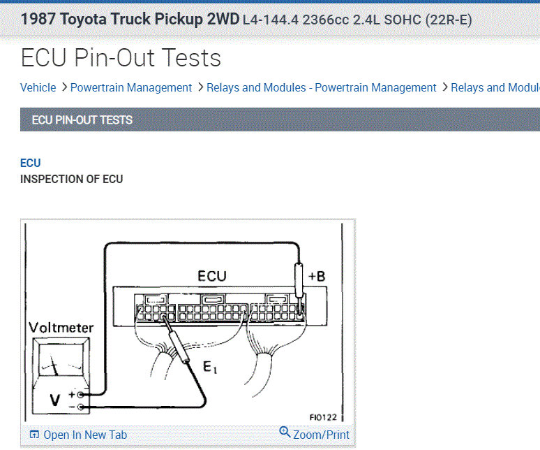

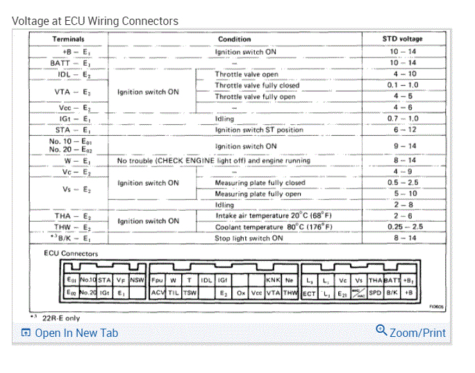

Yes, the ECM (ECU) can be checked by testing pin output. I attached the directions below for how it's done.
Additionally, I went to a 1983 vehicle that came originally with the carburetor. There is a vacuum pull-off for the choke. If it is staying shut or nearly shut after warm-up, it can be causing the issue. By chance, has the choke's operation ever been inspected? Larry, I feel it is related to the carb not being set up properly. The ECU on this vehicle shouldn't affect the carburetor. The only thing I can think of that makes sense is the choke isn't opening properly or it is going closed or nearly closed after the engine warms up. The ECU wouldn't have controlled that in a 1983. Instead, it would have been controlled by the choke linkage and engine vacuum.
If you look below, I provided the pin-out test for the ECU on your truck (1987). Take a look through it and let me know if you have questions or if I can help in any way.
I may be wrong, I have before and will be again, but I don't see this as an electrical issue.
See pics below Note: The test below is for ECU for a 1987 22RE engine. If your vehicle originally had something different, let me know. Also, pic 1 shows the choke pull-off vacuum hose. That hose should have an intake vacuum at all times with the engine running. Please confirm that for me.

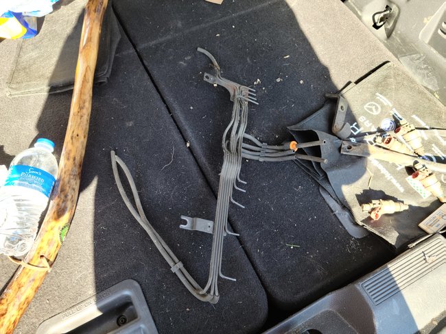

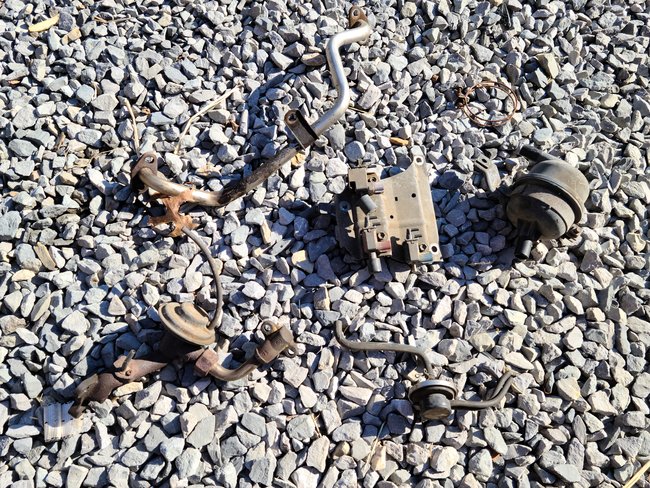

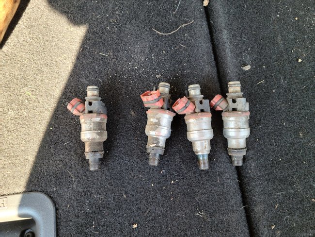

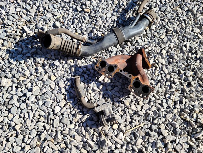

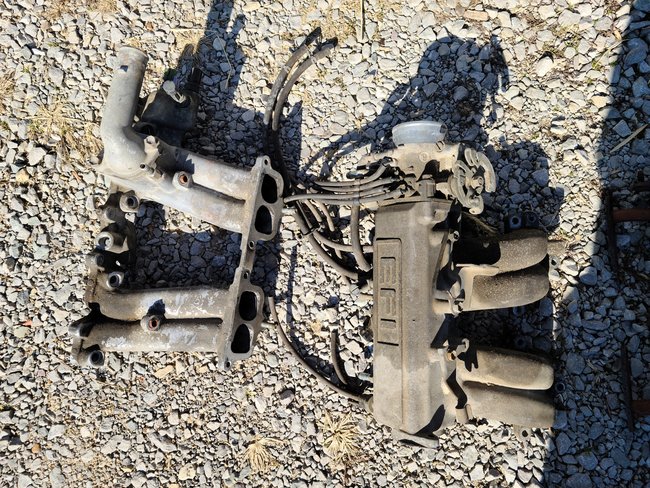

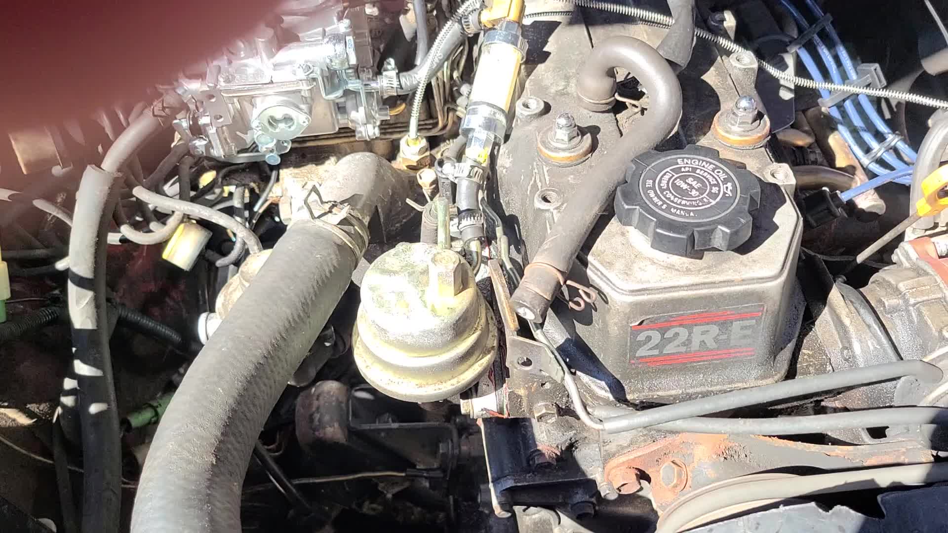

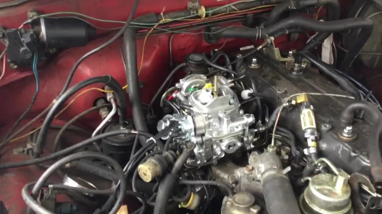

This is everything they took off the 1993 engine that was fuel injected and they added the carburetor. The real reason why they removed the fuel injection was that the fuel tank on the 1987 Toyota would not work with a fuel injected engine and he would have to buy one that would work with the emissions and the fuel injected engine. Does the fuel tank make that big of a difference? Where is the ECU located at?
Feb 16, 2022 at 6:29 AM
  • 110,194 POSTS

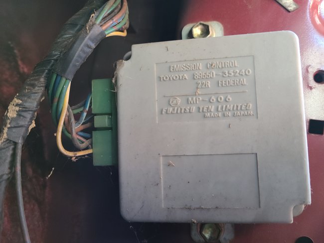

All things in the pics are related to the intake and injection system. As far as the ECU, I attached a pic below showing it.
If I recall, it is in the vehicle behind the kick panel.

Yes, the ECU will be on the passenger side. As far as the fuel tank is concerned, what did they install?
As far as the choke, it will either be open or closed. When the engine is warm, it should be open. Let me know if that makes sense or if you have other questions.

No problem whatsoever. If you look below, I circled the choke. In the picture, it is closed. When the engine is warm, it will turn 90 degrees to fully open.

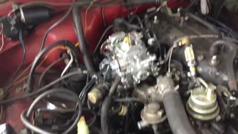

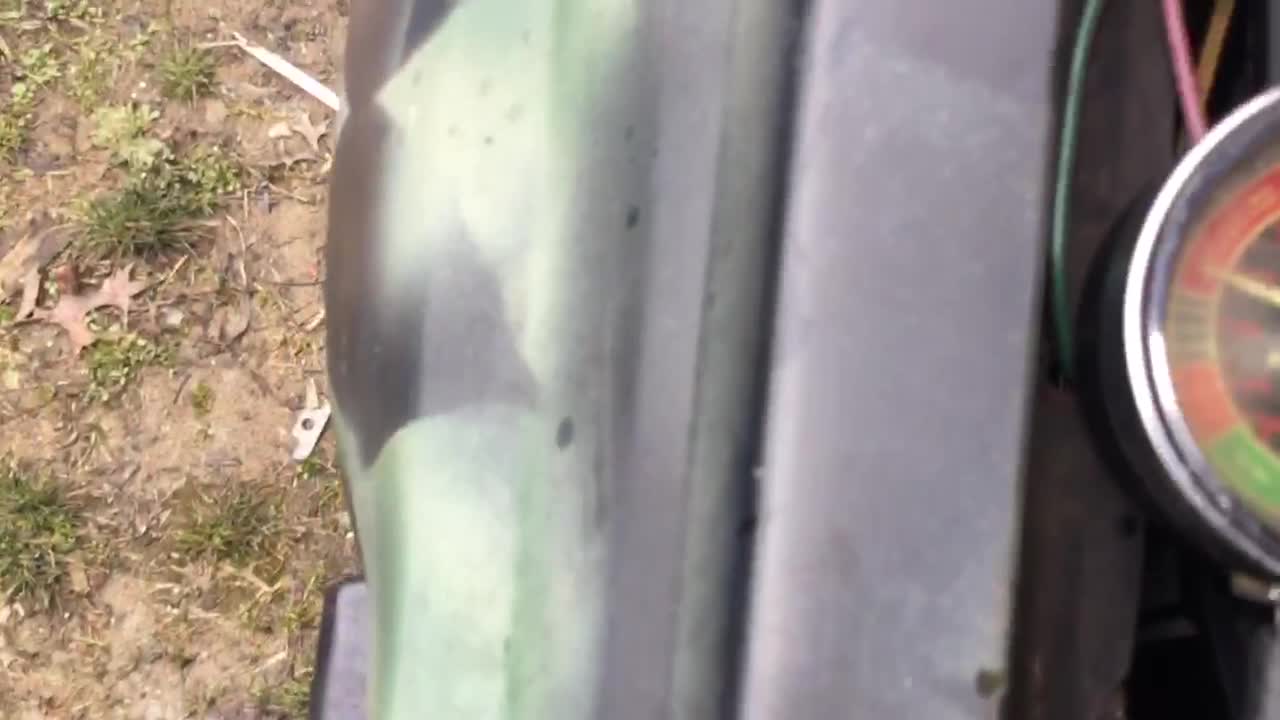

Good morning, Sir, how are you? I went up where my truck is, had a hard time starting it. I had a hard time starting it had to use starting fluid to get it start it. I don’t like starting fluid!
I made two videos, one running above idle and one with Idle, looks like I have an intake exhaust leak. Would this cause problems with it running right? As the fuel injection I believe that I would have to change the wiring harness. I found the Emission Control on the right-side kick panel. The first video is at idle, the second video is with the peddle pressed down a little.

I watched both videos. Do me a favor. I paused the video and made a copy of it. I attached it below. Watch the video and tell me if I am seeing light, a spark arcing, or something leaking.

I'm seeing a spark or an arc I will go back up there this week. Now that would cause a problem right, I will go back up there and look at it, is this what we're looking for ECU.
Feb 22, 2022 at 6:43 AM
  • 110,194 POSTS
Yes, to the ECU. And if that is a spark/arc from the ignition system, that will cause it to run really rough.

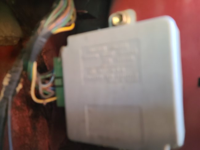

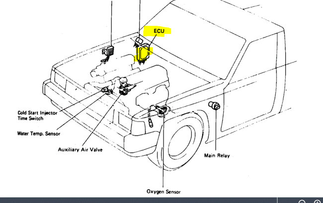

You sent me a post a while back that was supposed to have a picture of the ECU never received that picture, I have kept everything you have sent me and will print it and put it in my book. Thanks for your help

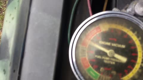

I'm so sorry. I thought I sent that. I attached the location below. Also, to check for a vacuum leak, what you suggested is how it's done. I don't use starting fluid because it is so much easier to cause a fire. Instead, I use carburetor cleaner.
Take a look through this link and let me know if it helps.
Also, an intake leak will certainly cause issues. Let me know if you are able to find one.

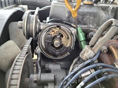

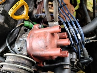

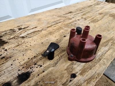

Things are going slow with the truck, the person working on it has COVID. I went and got the distributor cap off and the rotor cap off, to have it matched to get a new one. I have added the pictures of the distributor and rotor cap.

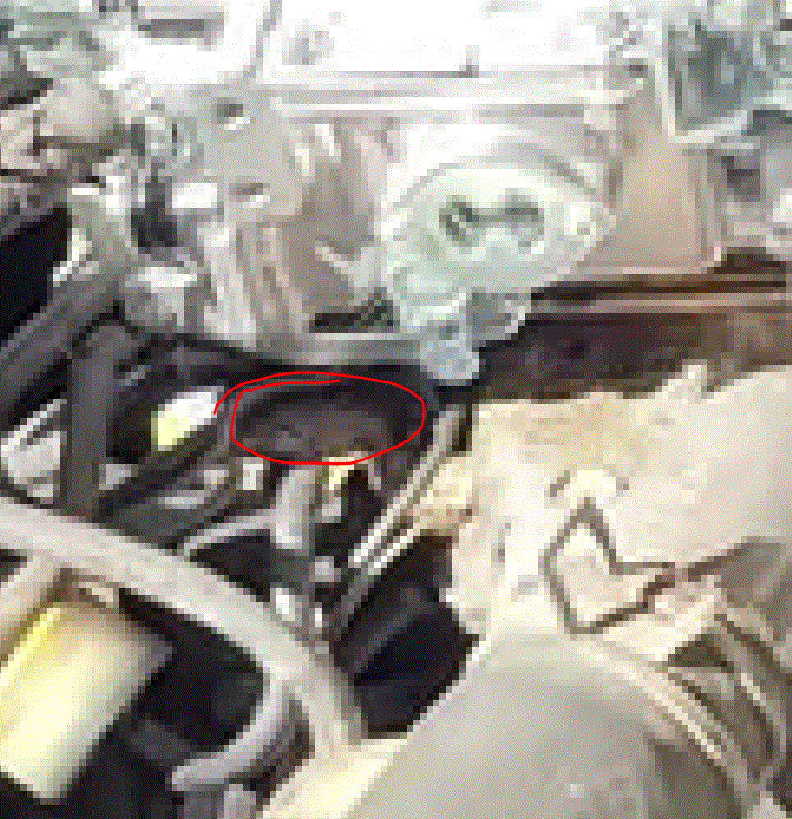

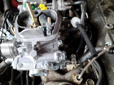

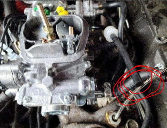

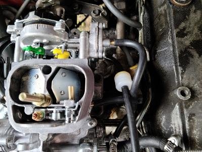

Joe, I have taken to pictures of the area of the carburetor where you said the vacuum leak might be, see if you can see the area, you were talking about.

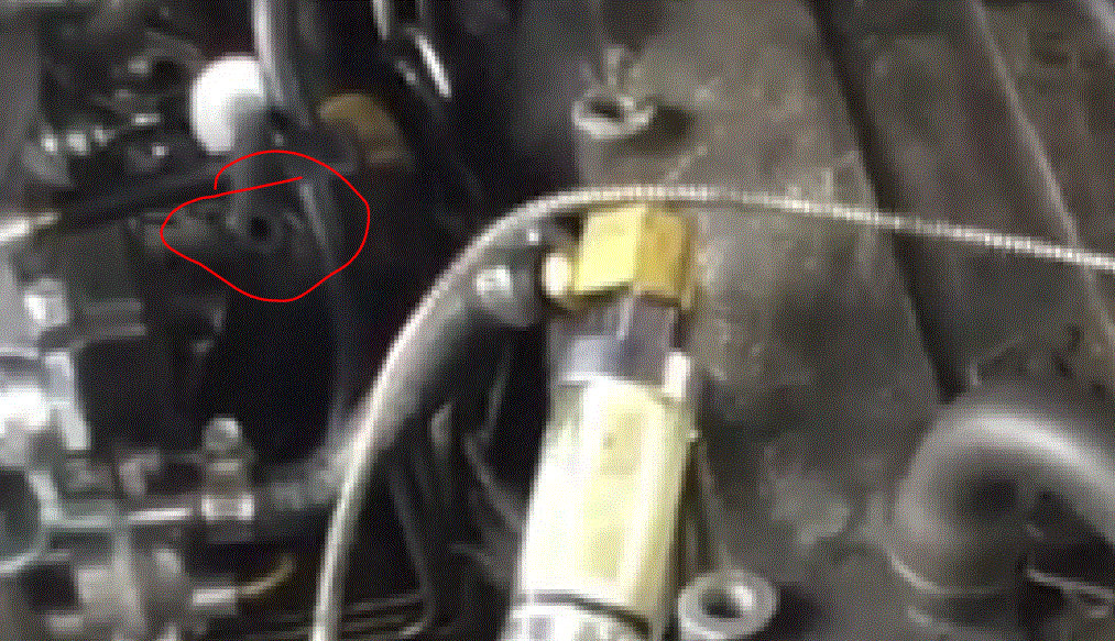

Joe, I have taken two pictures of the area of the carburetor where you said the vacuum leak might be, see if you can see the area you were talking about.

The rotor looks really corroded. Also, does the inside of the distributor cap look the same?
I attached a copy of your pic below. The hose I circled appears to be a disconnected vacuum hose. With the engine running, see if there is a vacuum at it. Or, plug it with a bolt and see if it changes how it runs.
I'm not seeing the other one I mentioned.
