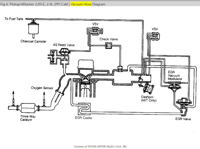

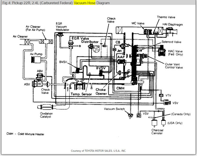

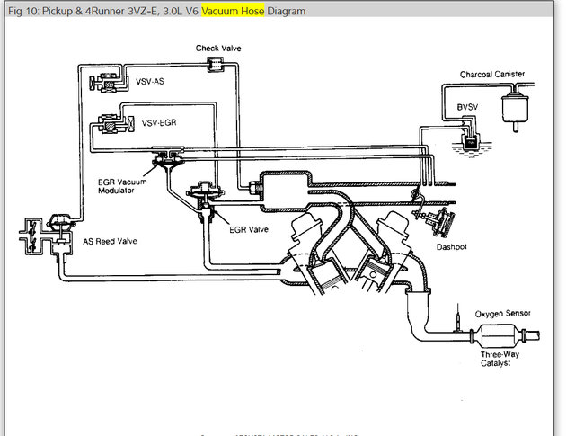

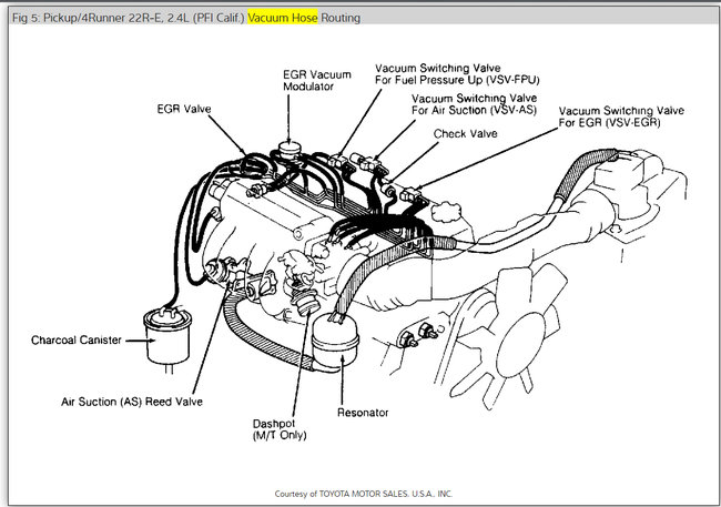

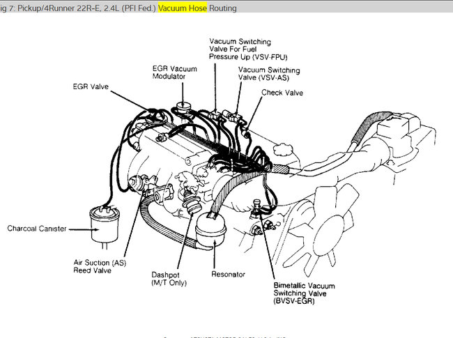

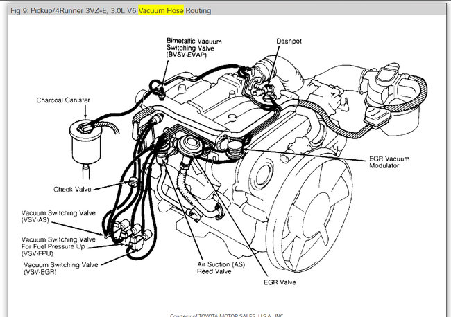

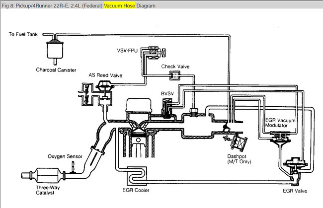

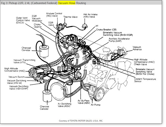

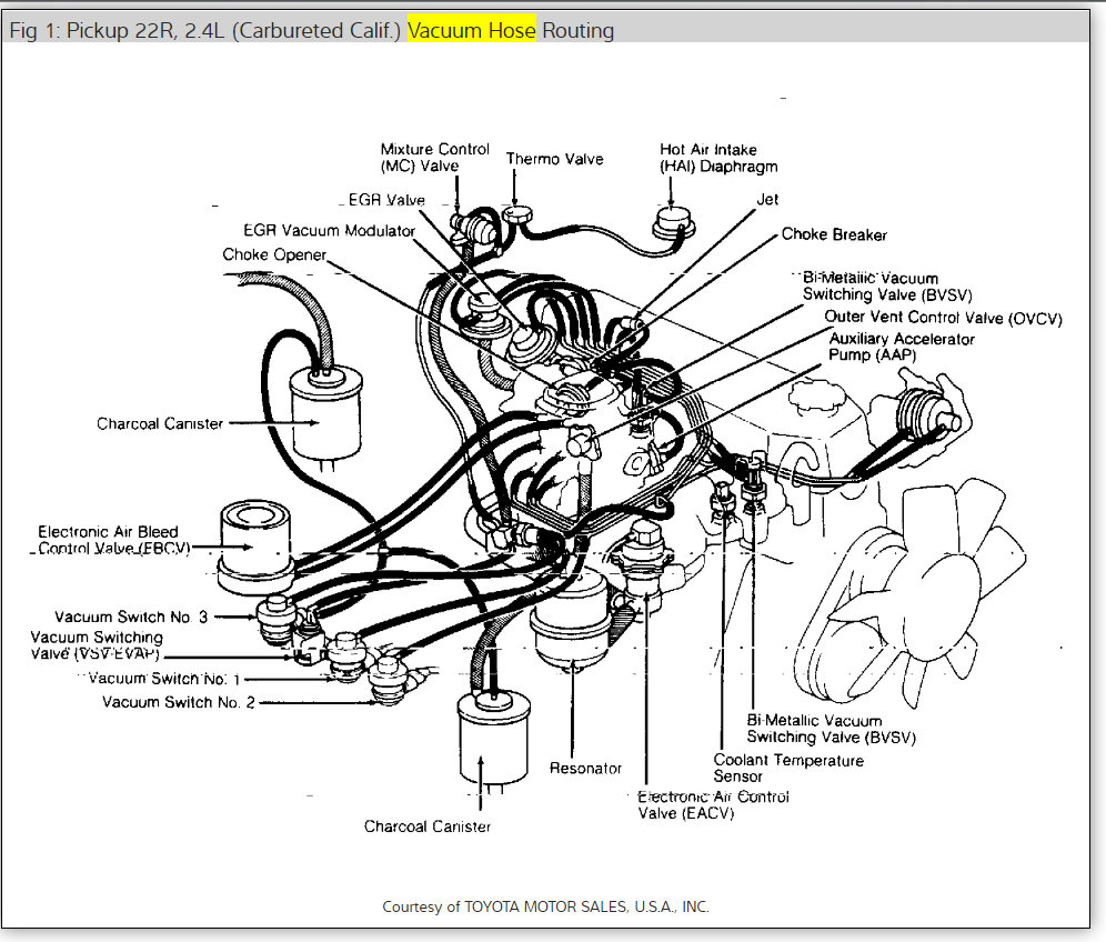

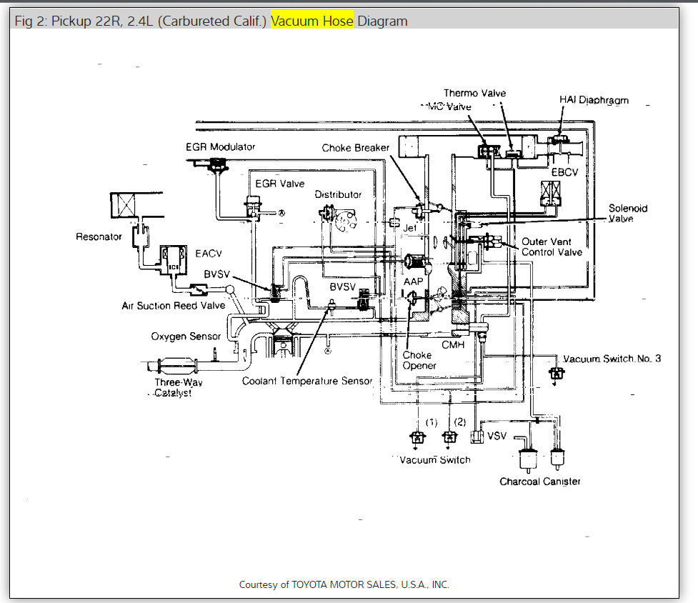

All the vacuum hoses are not on the engine and I need a hose route diagram.
Thursday, June 17th, 2010 AT 5:21 PM
MECHANIC
75,992 POSTS
There are many different combinations of all the engine they put in the truck so here are all the engine vacuum line diagrams BELOW
