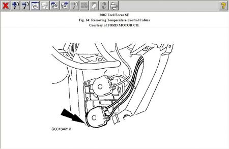

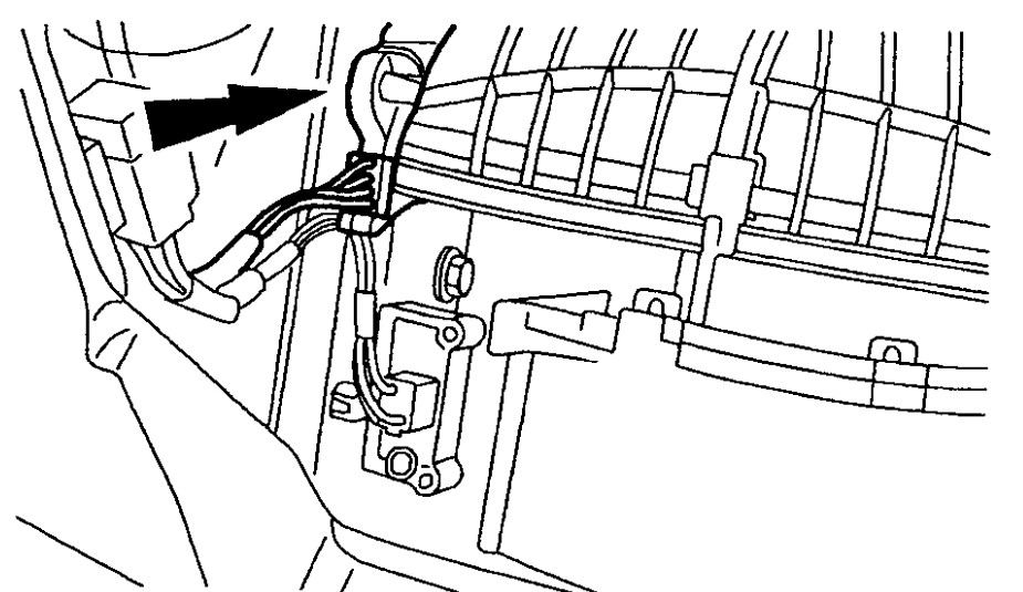

The heater core or hoses could be clogged-up. Further You can visually inspect the temperature control cable, blend door, temperature control switch and mechanical air temperature valve.
-2
Wednesday, January 13th, 2021 AT 4:51 PM (Merged)
TARGAC
How do I look at this door and switch
  • 75,992 POSTS
You need to go behind the dash its a tedious job-
https://www.2carpros.com/forum/automotive_pictures/12900_air_distribution_cable_1.jpg
https://www.2carpros.com/forum/automotive_pictures/12900_cable_1.jpg

It's hard to connect hoses incorrectly because they are different sizes. Pull fuses 36 and 45 in central junction box inside car with key on this may reset actuator. Then have it scanned for codes as it may be the solid state unit in control head. The actuator is by blower motor that is the only one there is. So yours may be also manually controlled with a cable if It is it will be on the heater box and see if it operates. It may be broken.
