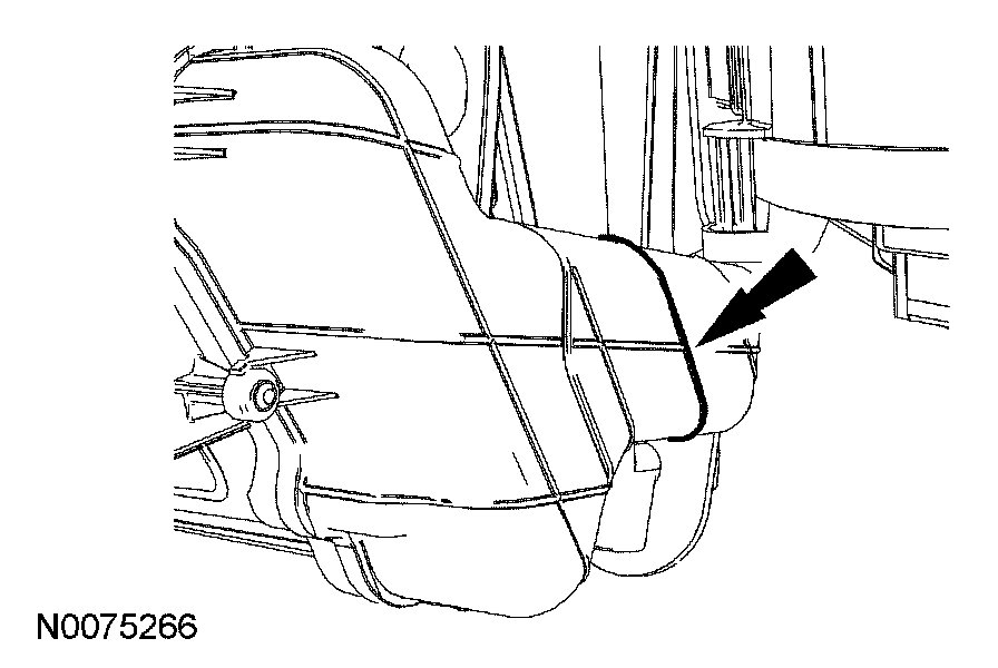

Here are the directions specific to your vehicle. The attached pictures correlate with these directions.
__________________________________________________

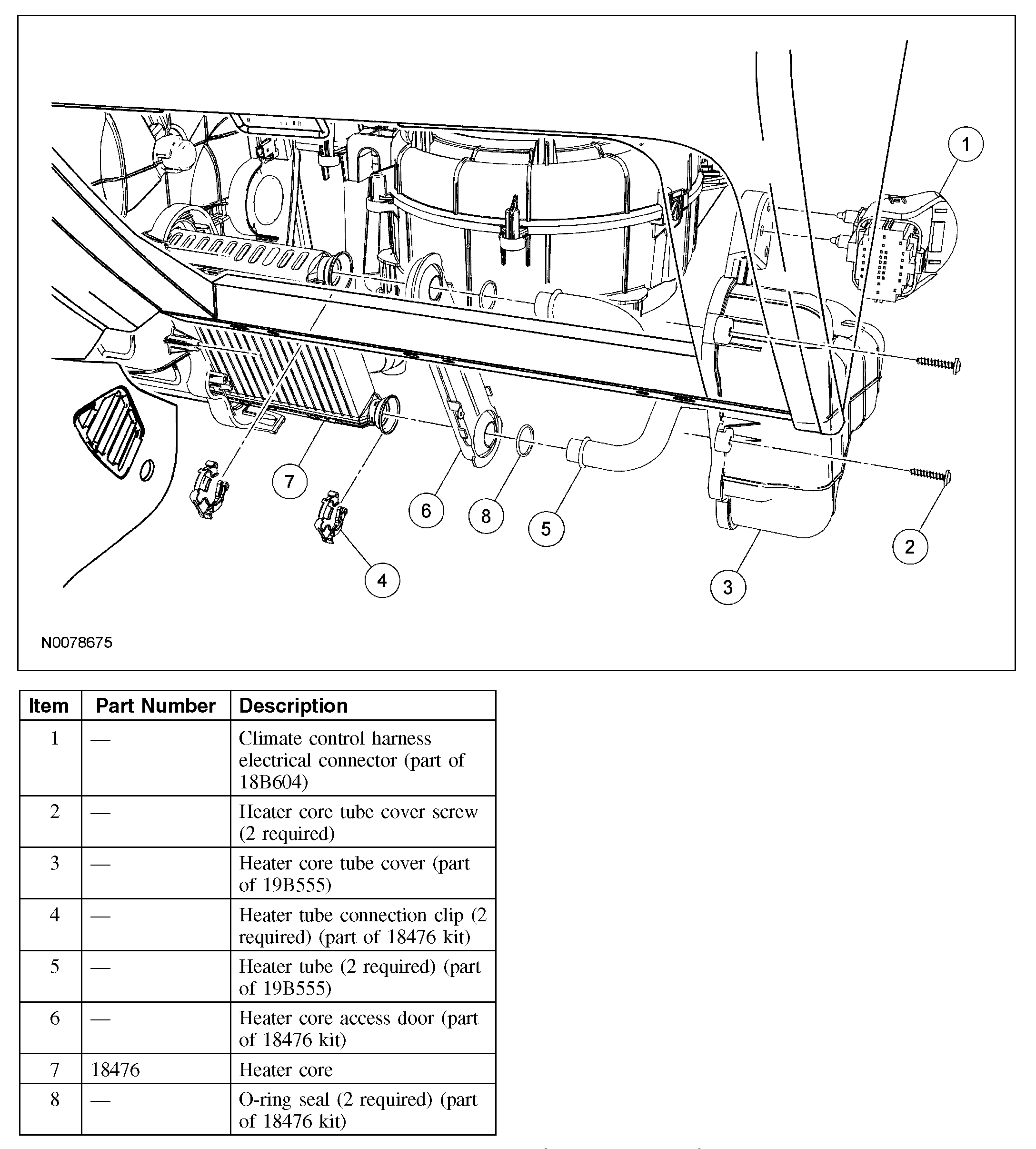

HEATER CORE
Picture 1
Removal and Installation
NOTE:
- If a heater core leak is suspected, the heater core must be leak tested before it is removed from the vehicle. See: Heating and Air Conditioning > Component Tests and General Diagnostics
- It is not necessary to install new heater core inlet and outlet tubes when installing a new heater core unless there is evidence of damage to the heater core tubes. The new O-ring seals supplied with the heater core service kit must be installed any time the heater core tubes are detached from the heater core.
1. Drain the engine coolant. See: Cooling System > Service and Repair
2. Remove the 3 glove compartment screws and the glove compartment.
- To install, tighten to 10 Nm (89 lb-in).
3. Using a suitable utility knife, carefully cut the heater core tube cover along the rib as shown.
Picture 2
4. Detach the climate control wire harness connector from the heater core tube cover.
5. Remove the 2 heater core tube cover screws.
6. Remove the cut portion of the heater core tube cover.
7. NOTE: Before disconnecting the heater core tube connections, position a suitable drain pan to catch any residual coolant that may drain from the heater core or heater core tubes when disconnected.
Remove the 2 heater core tube connection clips and disconnect the 2 heater core tubes from the heater core.
- Discard the O-ring seals.
8. Detach and remove the heater core access door.
9. NOTE: The heater core must be carefully manipulated to clear the blower motor housing while being removed.
Remove the heater core.
10. NOTE: Be sure that the new O-rings are installed, and the heater core tubes are fully seated into the heater core before installing the heater core tube connection clips.
To install, reverse the removal procedure.
- Install new O-ring seals.
- Apply a suitable black duct-type tape over the cut in the heater core tube cover.
11. Fill the engine coolant level. See: Cooling System > Service and Repair

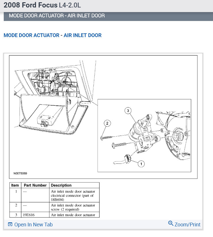

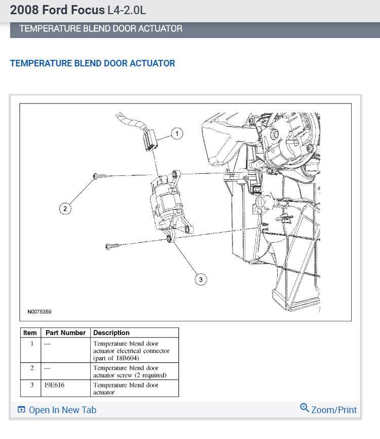

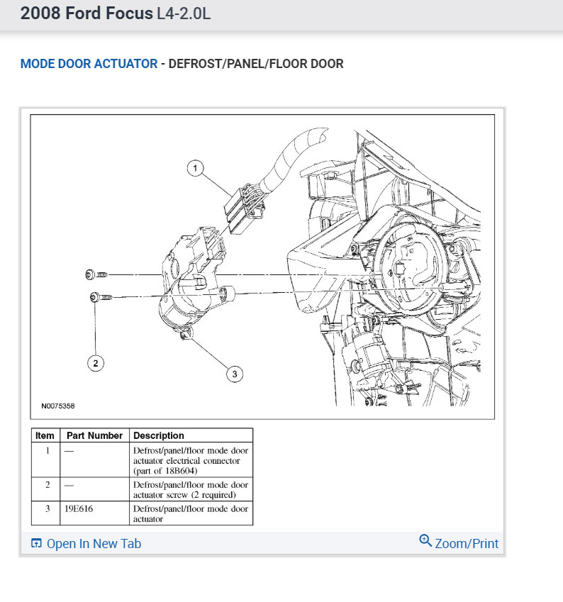

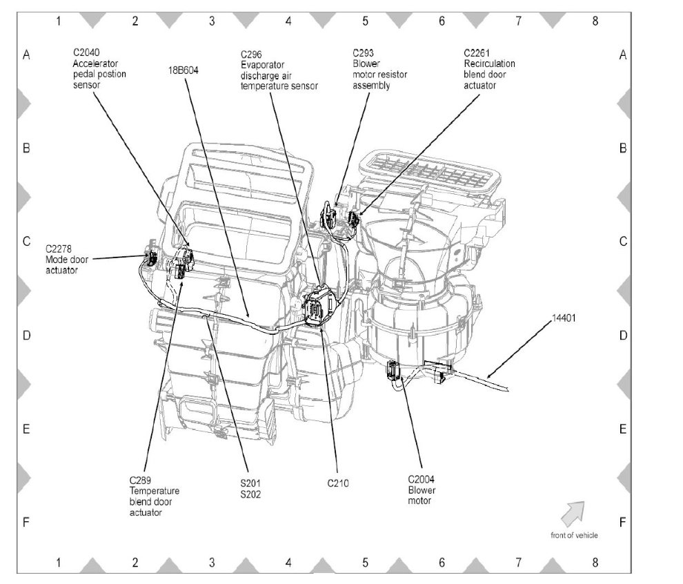

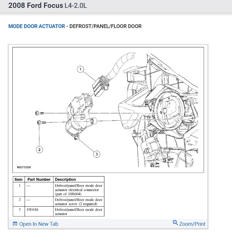

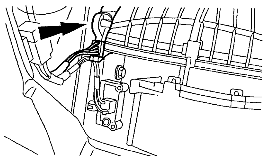

If both heater core hoses are hot in the aforementioned directions, the last thing is the blend air door. This door determines if heat or AC enters the vehicle and is also located under the dash.
Here is a link that shows in general how one is replaced.
Here are the directions specific to your vehicle. The remaining pictures correlate with these directions.

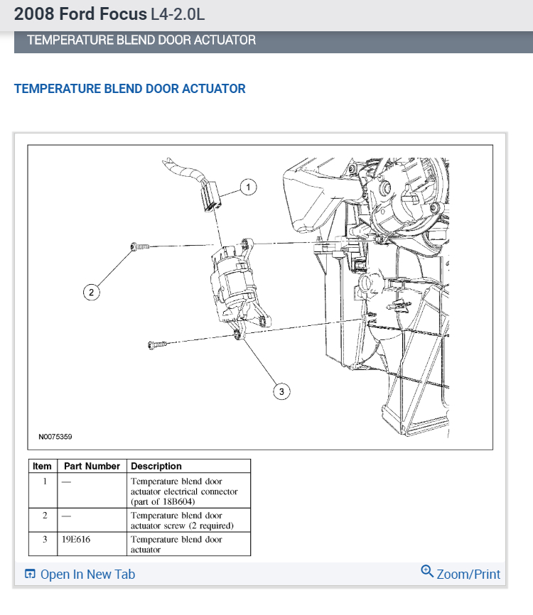

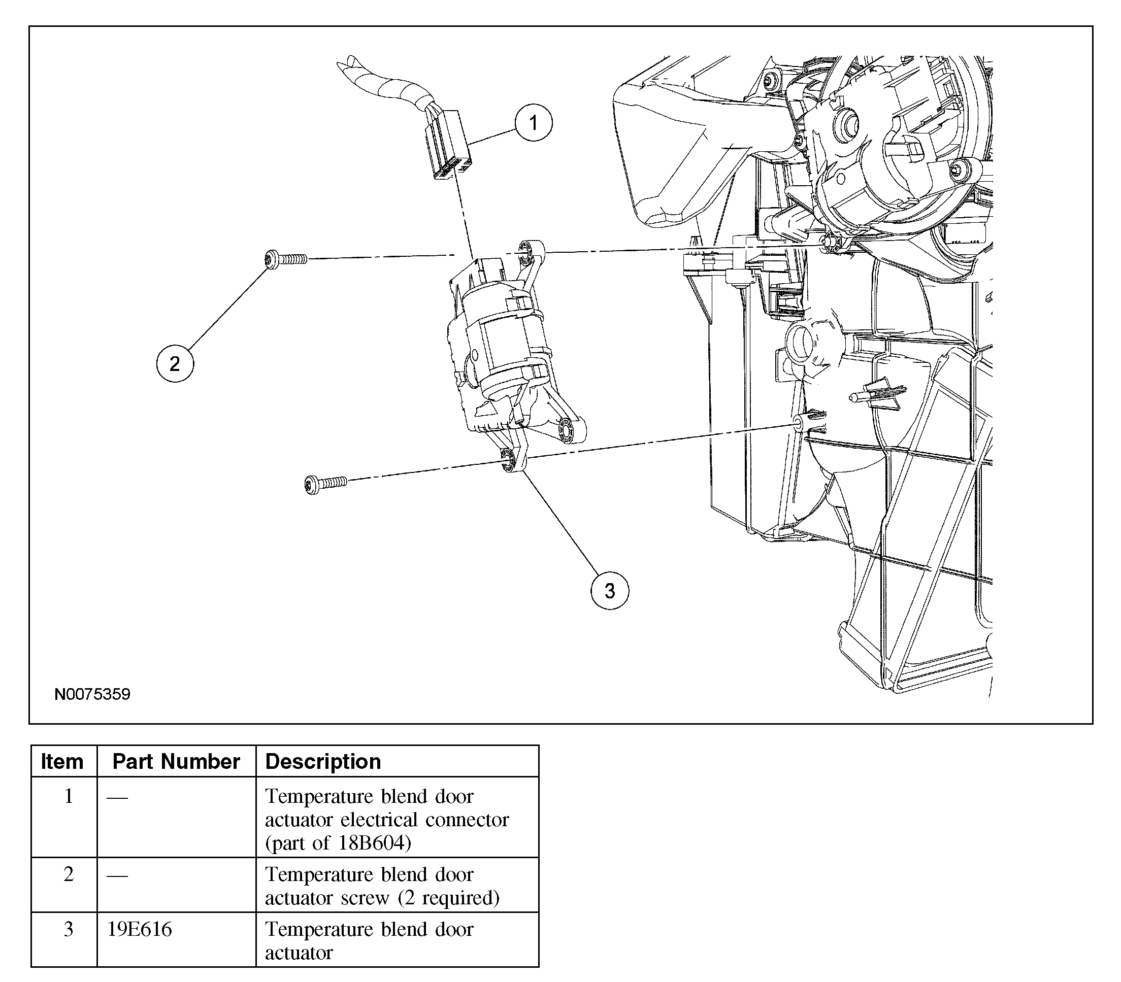

TEMPERATURE BLEND DOOR ACTUATOR
See picture 3
NOTE: The temperature blend door actuator can be accessed from below the instrument panel to the right of the accelerator pedal.
1. Disconnect the temperature blend door actuator electrical connector.
2. Remove the 2 temperature blend door actuator screws.
3. Remove the temperature blend door actuator.
4. To install, reverse the removal procedure.

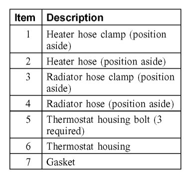

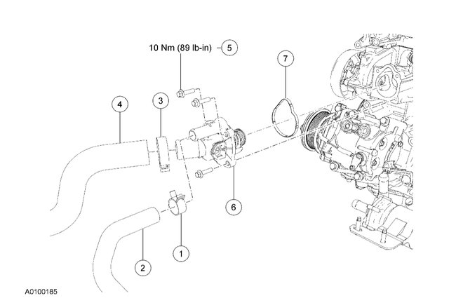

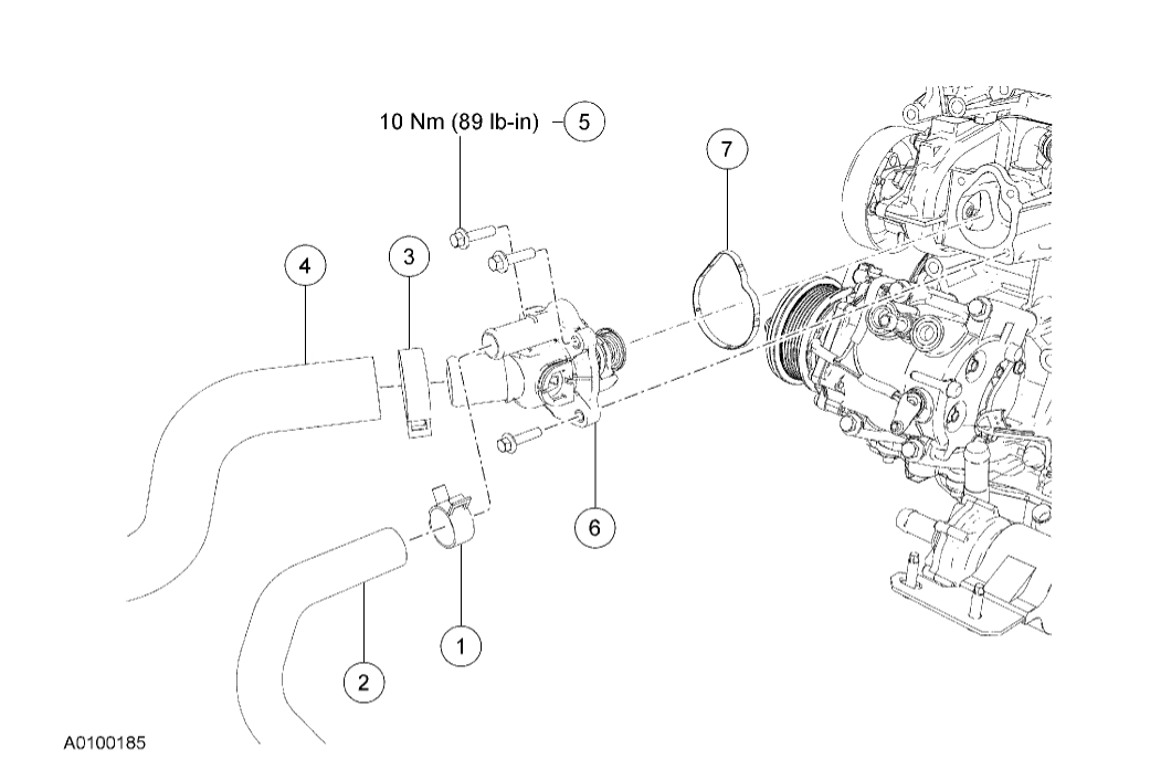

You are on the money with the thermostat it sounds like it is stuck open.
Here is a guide to help you see what you are in for when changing the thermostat out:
Here is what it will be like for your car (below).

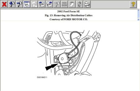

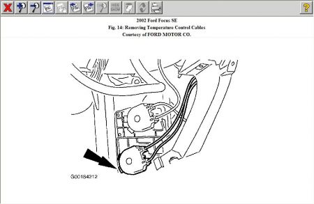

What are the options for me to look at if the heater doesn't work. The only thing that blows out of the vents is cold air.
Jan 13, 2021 at 8:51 AM (Merged)
  • 75,992 POSTS
The heater core or hoses could be clogged-up. Further You can visually inspect the temperature control cable,blend door, temperature control switch and mechanical air temperature valve.
TARGAC
how do I look at this door and switch
  • 75,992 POSTS
You need to go behind the dash its a tedious job-
https://images.2carpros.com/forum/automotive_pictures/12900_air_distribution_cable_1.jpg
https://images.2carpros.com/forum/automotive_pictures/12900_cable_1.jpg
