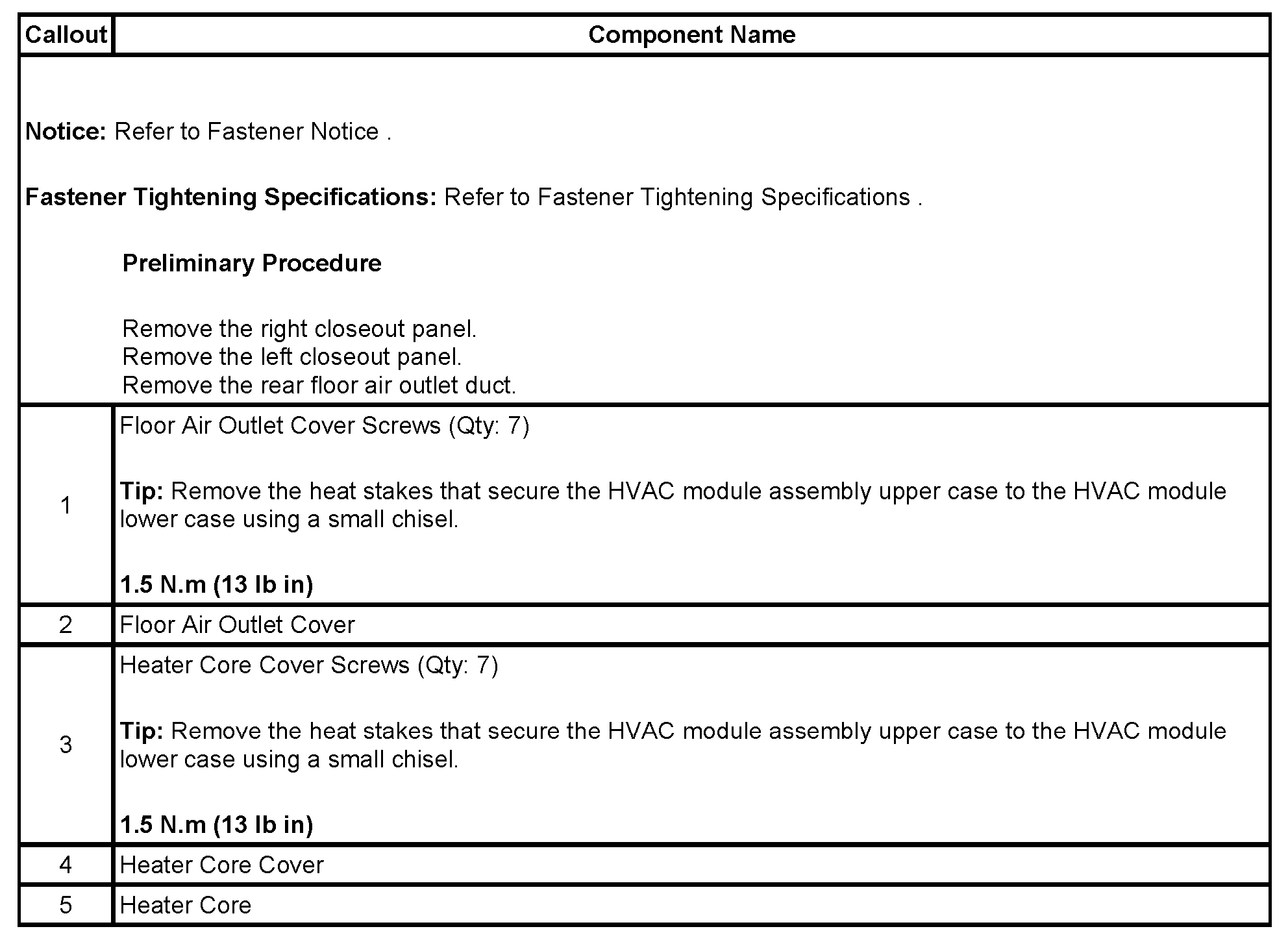

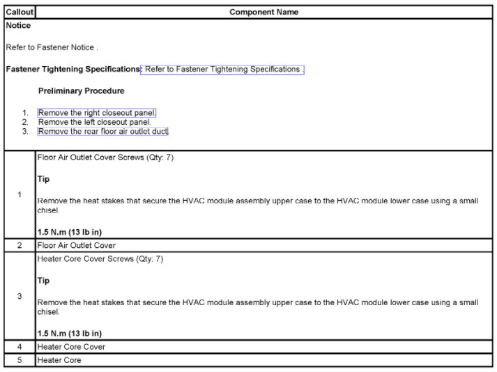

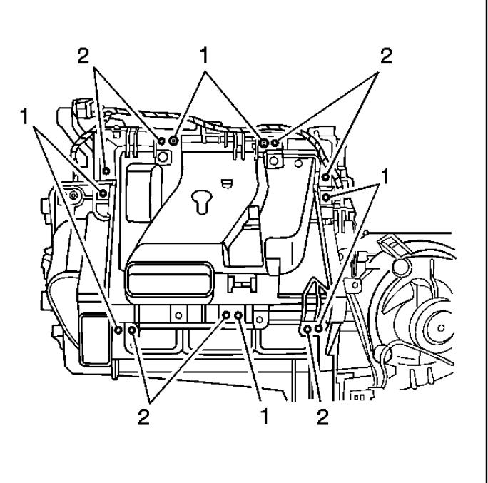

I need directions to replace heater core.
Sep 27, 2016 at 1:44 AM
  • 110,240 POSTS

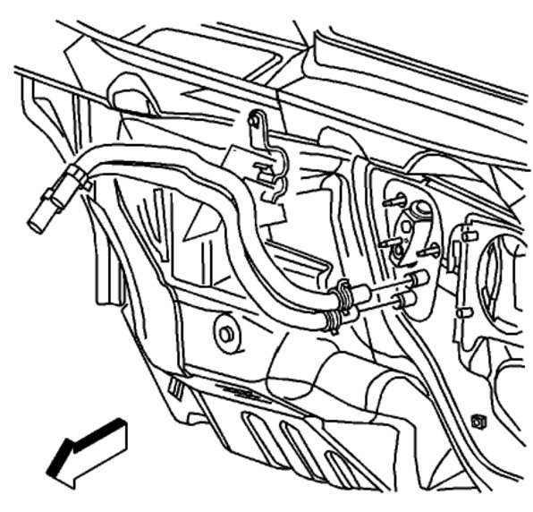

The heater core is located on the inside of the vehicle under the dash. It's a little bit of a job but if you follow the directions, you can do it.
First, here is a link that shows how it's done in general. Use this as a guide.
https://www.2carpros.com/articles/replace-heater-core
____________________________________________________________

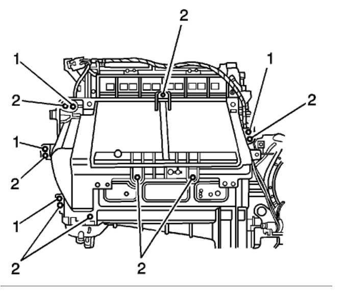

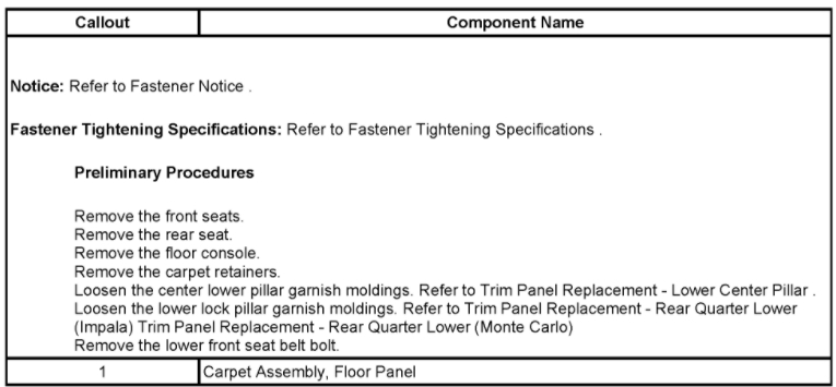

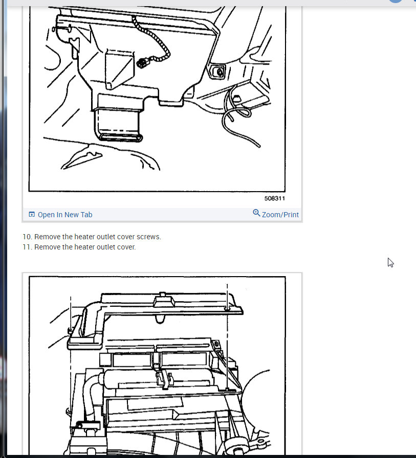

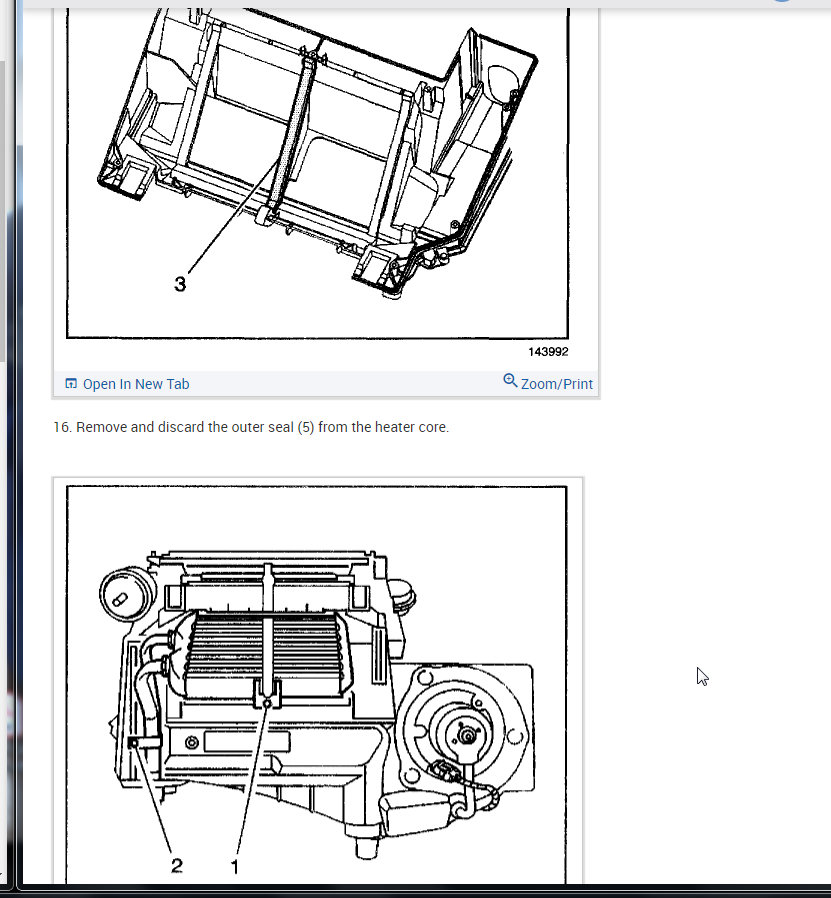

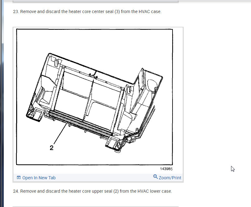

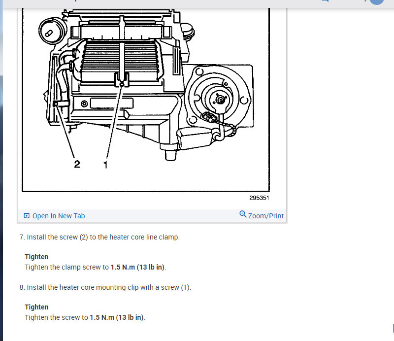

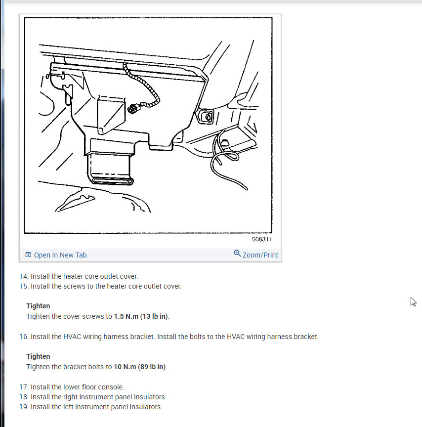

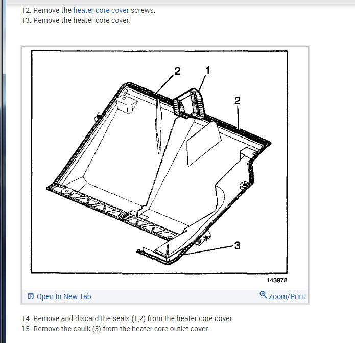

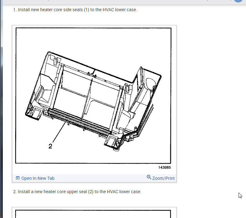

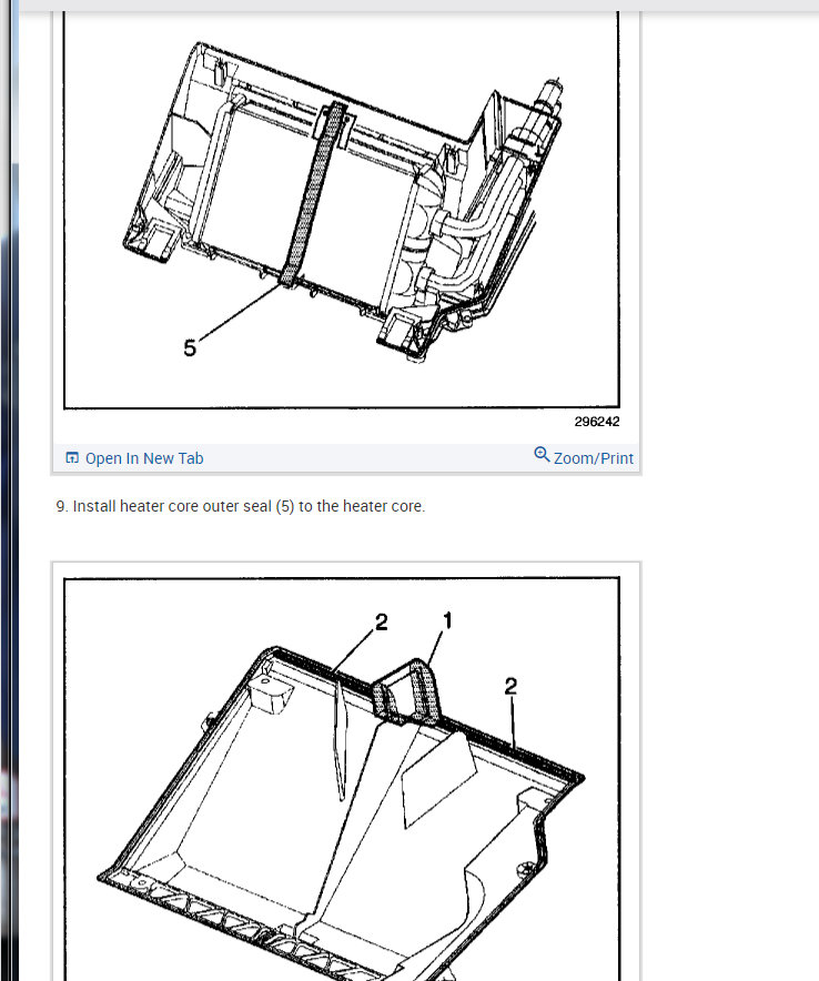

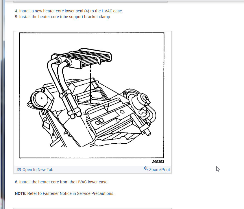

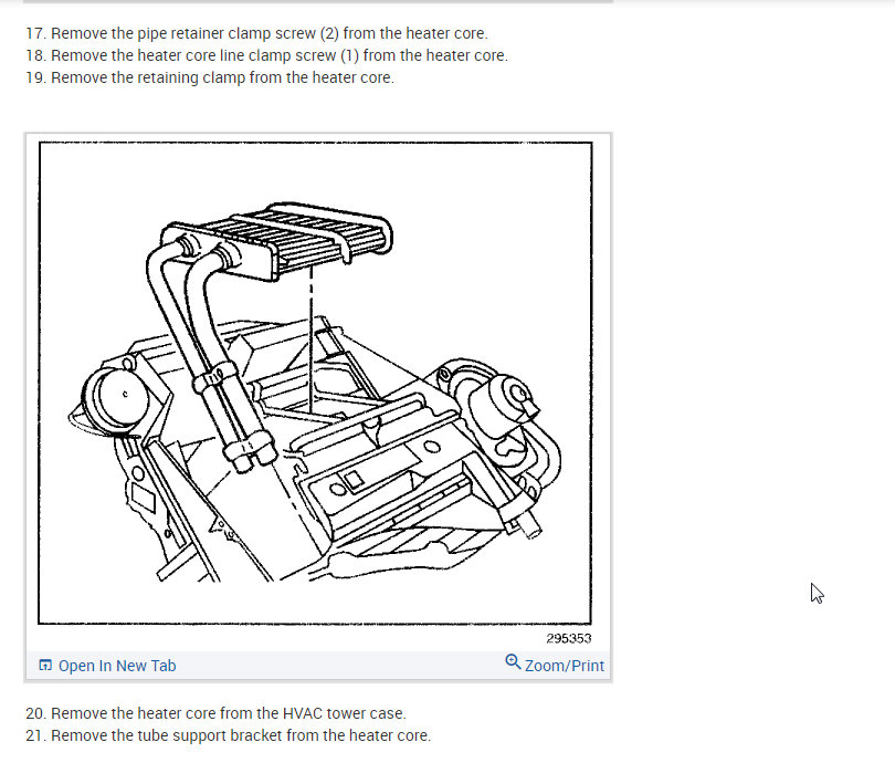

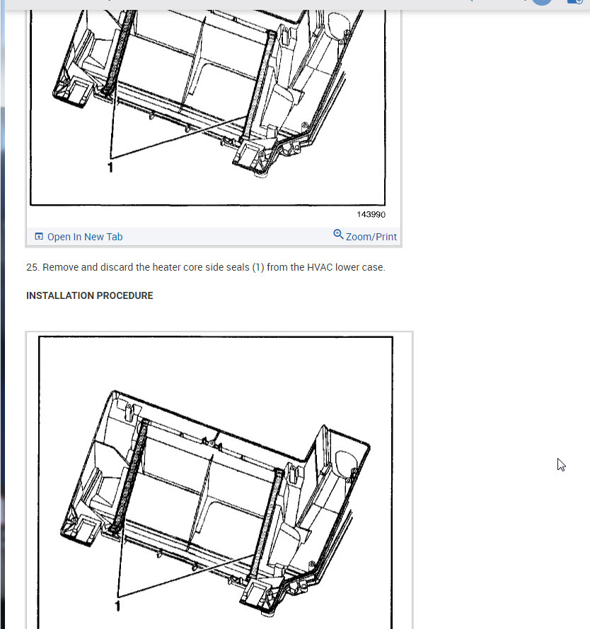

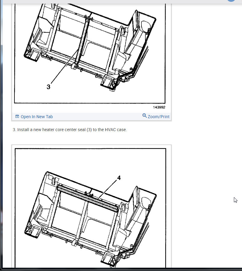

Here are directions specific to your vehicle. The two attached pics are the actual directions and an exploded view of the heater unit.
2008 Chevrolet Impala V6-3.5L
Heater Core Replacement
Vehicle Heating and Air Conditioning Heater Core Service and Repair Removal and Replacement Heater Core Replacement
HEATER CORE REPLACEMENT
pic 1
pic 2

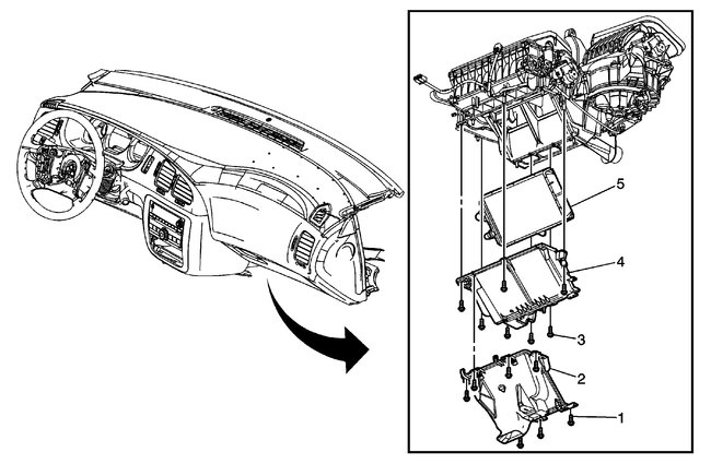

Hello, I'm Danny.

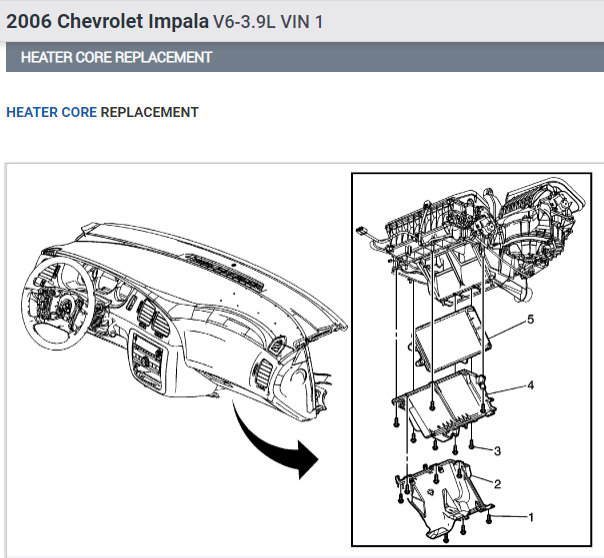

Here is the information you requested. Here is a tutorial to get you started on how to replace a heater core:
I've attached picture steps below on how to remove and replace the heater core on your car. Hope this helps and thanks for using 2CarPros.

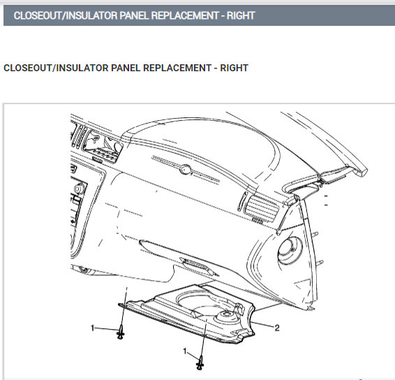

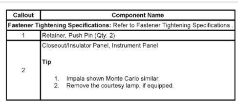

Remove the lower instrument panel lower compartment by removing or disconnecting the following:
Lower right instrument panel insulator
Compartment-to-panel bolts and screws, from under the instrument panel compartment
Instrument panel compartment door screws and the door
Instrument panel compartment screws and plastic clips; then slide the compartment from the instrument panel

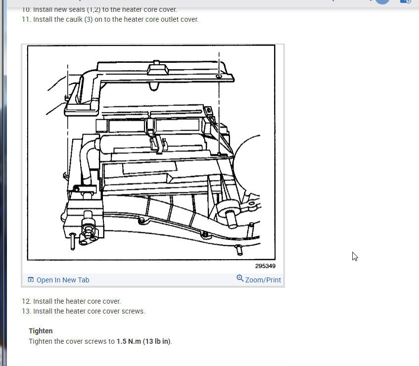

Lower heater duct
Heater core cover and discard the cover seals Heater core mounting clip and bracket
Heater core
INSTALLATION:
Install and connect the following:
Heater core in the vehicle

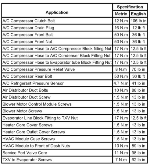

New seals on the heater core cover
Heater core cover and torque the bolts to 13 inch lbs. (1.5 Nm)
Lower heater duct, if removed
Ashtray and bracket, if removed
Install the lower instrument panel lower by installing or connecting the following:
Electrical connector to the compartment
Slide the compartment into the instrument panel; then, secure it with screws and plastic clips Instrument panel compartment door and screws Compartment-to-panel bolts and screws, located under the instrument panel compartment
If equipped, install the lower center console install or connect the following:
Console in the vehicle and connect the electrical connectors
Console-to-chassis bolts and screws, tighten in sequence beginning at the front right and continue in a clockwise order to 106 inch lbs. (12 Nm) Armrest compartment mat and lower the front floor console armrest C/D storage compartment into the front floor console
Electrical connectors to the upper console trim plate and snap the trim plate onto the console
Automatic transaxle shift handle and the cigarette lighter

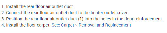

Heater hoses to the heater core and secure with the clamps
Refill the cooling system by performing the following procedure:
Close the radiator drain valve.
If the air bleed screws (located at the top of the thermostat housing) is closed, open it by turning it 2-3 turns.
Slowly add coolant until it reaches the radiator neck.
Wait for 2 minutes and recheck the coolant level; then, add more coolant if necessary.
Fill the coolant reservoir to the COLD mark.
Close the air bleed screw.
WARNING
Do not over-tighten the air bleed screw for it is made of brass.
Install the radiator cap and make sure that the arrows align with the overflow tube.
If equipped with a 3.8L engine, install the fuel injector sight shield by performing the following procedures:
Remove the oil filler cap/tube assembly from the valve cover.
Slide the fuel injector sight shield into the rear engine bracket and lower it into place.
Reinstall the oil filler cap/tube assembly in the valve cover. Twist it clockwise to lock the detent on the tube into the notch in the valve cover.
If equipped with a 3.1L engine, install the air cleaner and duct assembly.
Connect the negative battery cable.

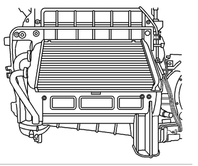

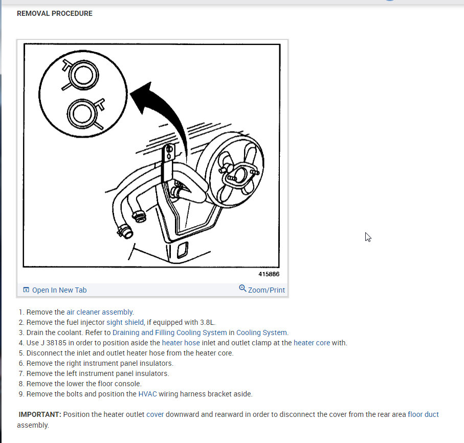

BRIAN61969

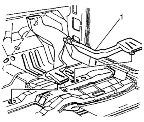

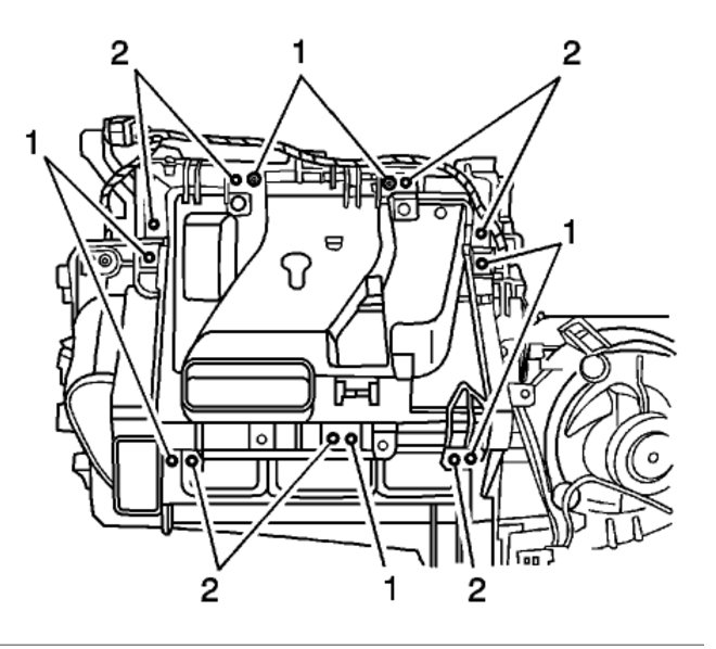

how do you remove a heater core on a 2004 Impala SS 3.8l v6. the heater core is leaking. Well I really need to know how to take the heater core out.
Feb 19, 2021 at 5:50 AM (Merged)
  • 55,381 POSTS
Hey BRIAN,

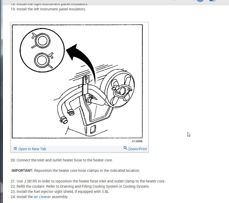

Doing a heater core is a big job but you can tackle it if you just stick to it. Here are some instructions and a diagram or two to help you through the job.

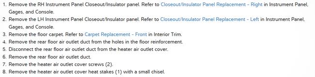

Remove the fuel injector sight shield.
Drain the cooling system. Refer to Draining and Filling Cooling System in Cooling System.
Use J 38185 in order to position aside the heater hose inlet and outlet clamps at the heater core.
Disconnect the inlet and outlet heater hose from the heater core.

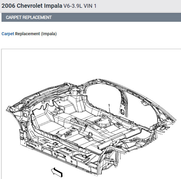

Remove the RH Instrument Panel Closeout/Insulator panel.
Remove the LH Instrument Panel Closeout/Insulator panel

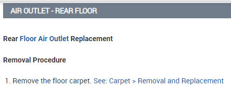

Remove the floor carpet.
Remove the rear floor air outlet duct from the holes in the floor reinforcement.
Disconnect the rear floor air outlet duct from the heater air outlet cover.
Remove the rear floor air outlet duct.

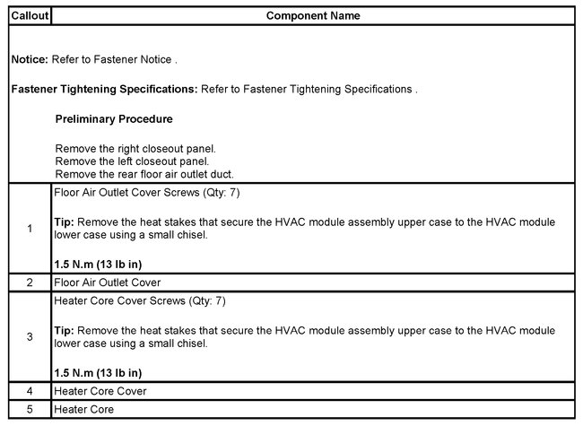

Remove the heater air outlet cover screws (2).
Remove the heater air outlet cover heat stakes (1) with a small chisel.
Remove the heater air outlet cover from the HVAC module assembly.

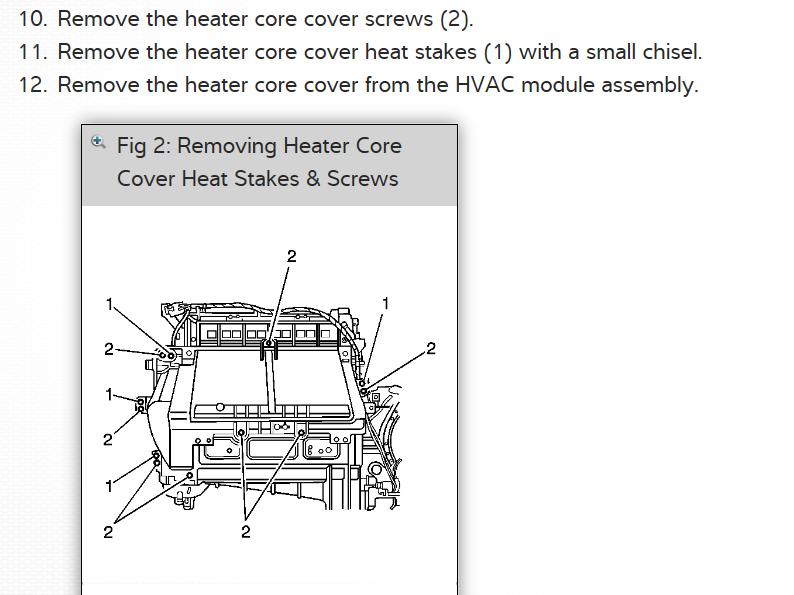

Remove the heater core cover screws (2).
Remove the heater core cover heat stakes (1) with a small chisel.

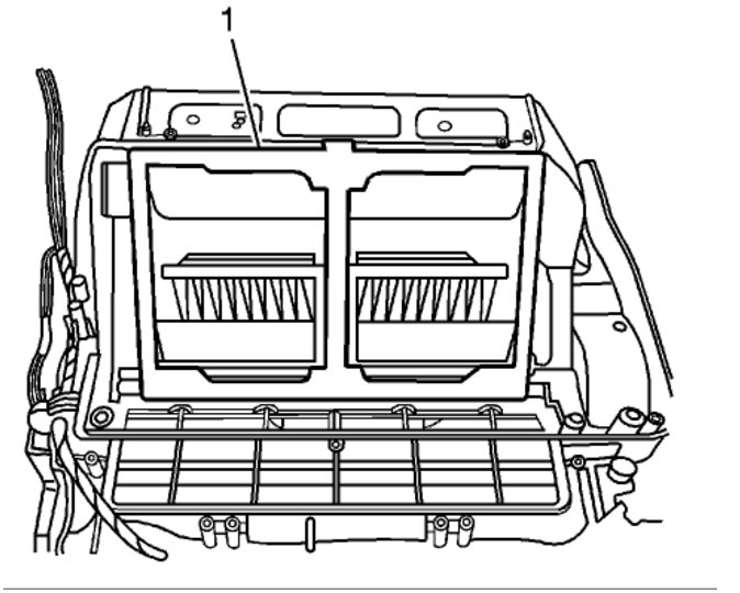

Remove the heater core cover from the HVAC module assembly.
Remove the heater core from the HVAC module assembly.
Remove the heater core foam seal (1) from the HVAC module assembly.
Please let us know happens so it will help others. check out the diagram (Below)
Best, Ken

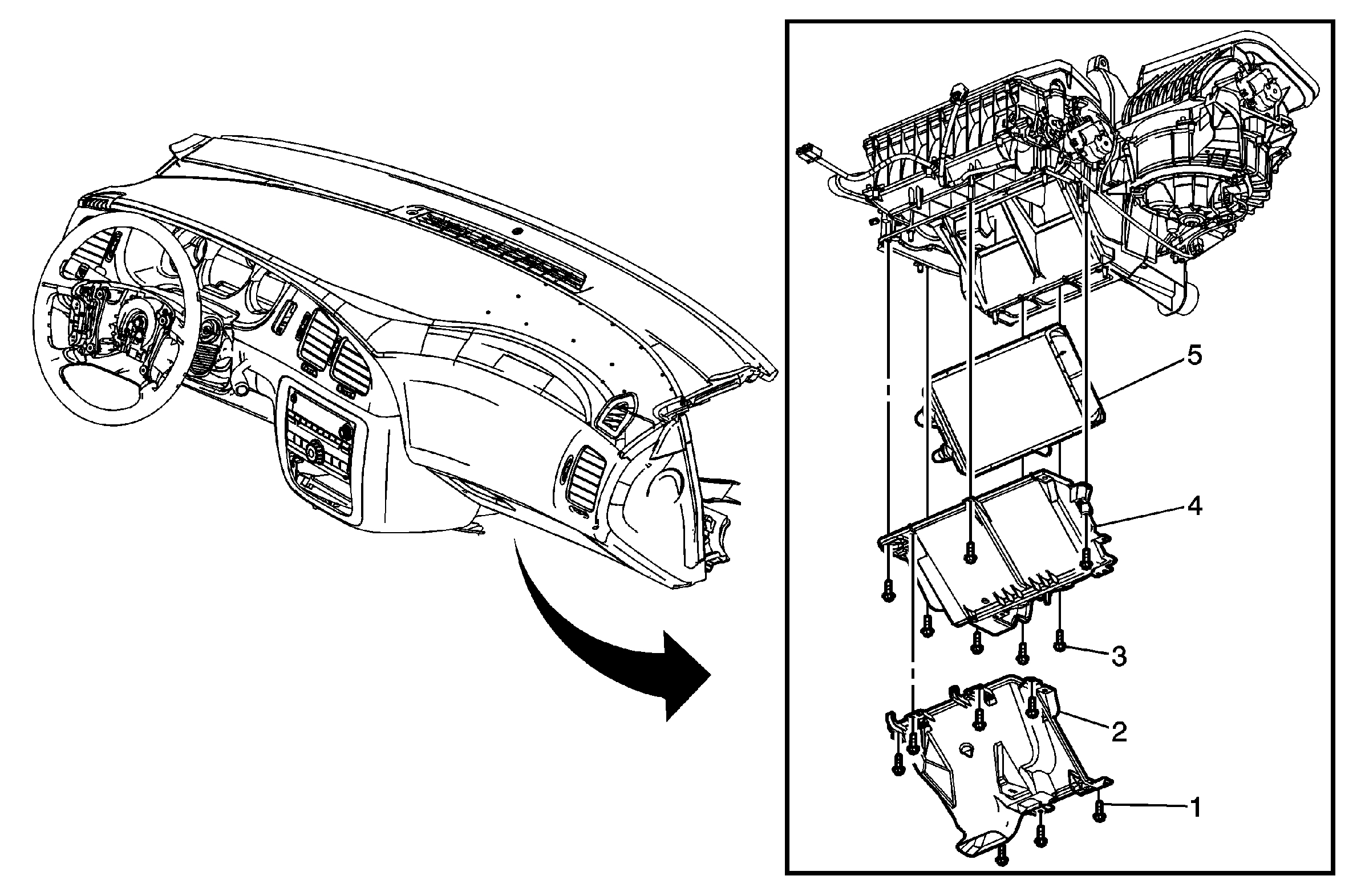

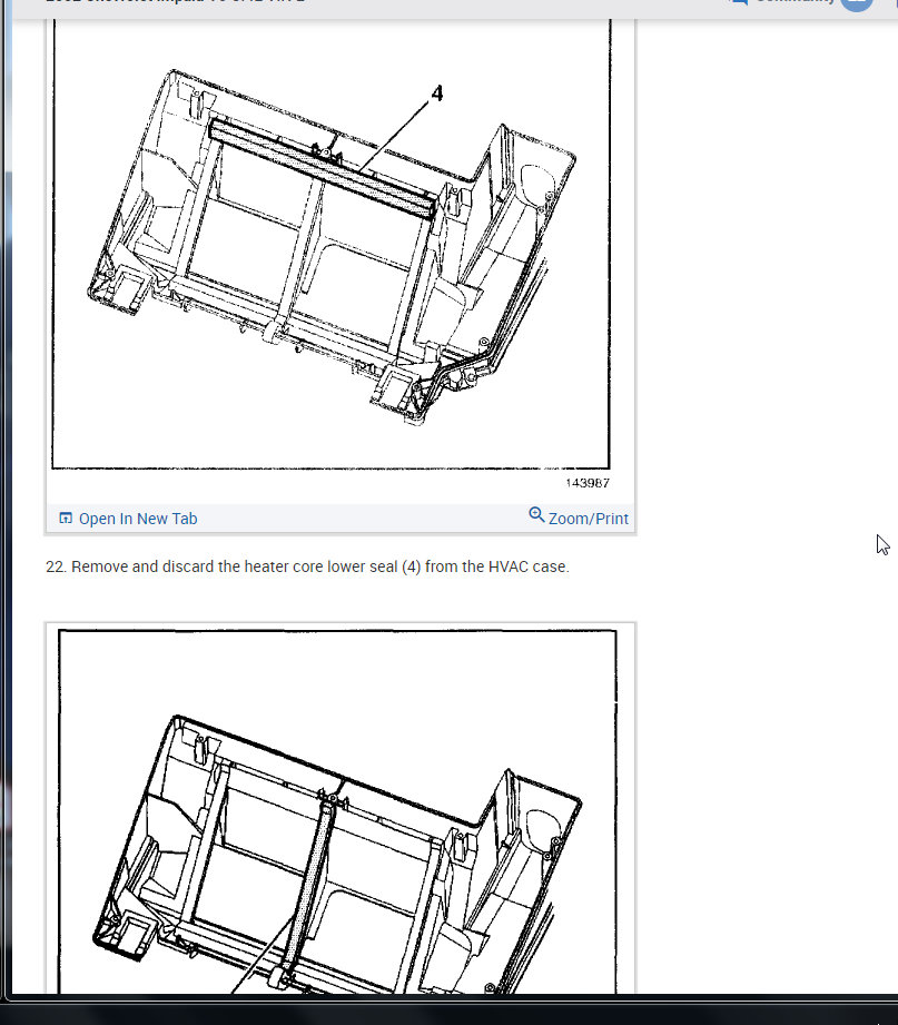

heater core replacement in 2002 chevy impala What's the easiest way to replace the heater core?
Feb 19, 2021 at 5:51 AM (Merged)

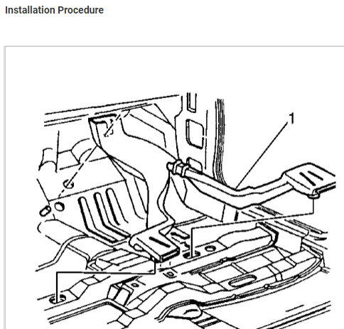

Unfortunately there is no short cut for this vehicle. I am attaching below the process from the manual on how to replace this.
Let us know if you have questions. Thanks
