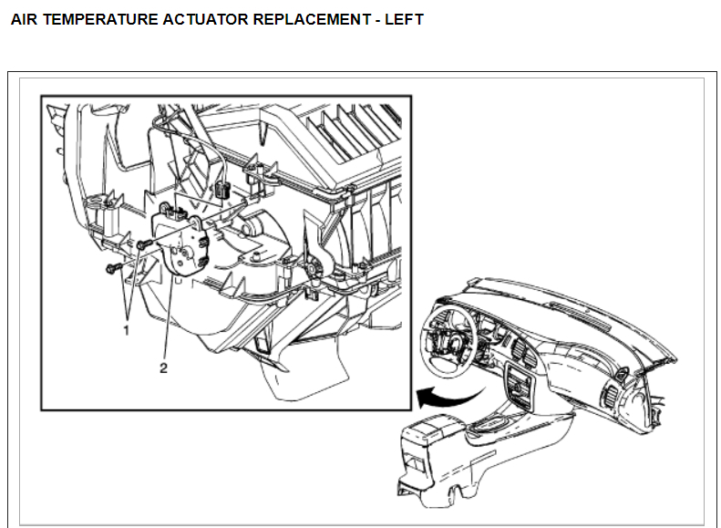

The heater will blow cold air even when temp gauge is at halfway point. As soon as you drive the car it starts to heat up and work fine. Started at first to do it once in a while nows seems to be more frequent. I have checked antifreeze all fluids are fine and cap is tight no visible leakage.

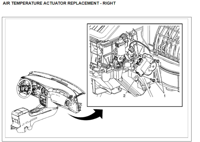

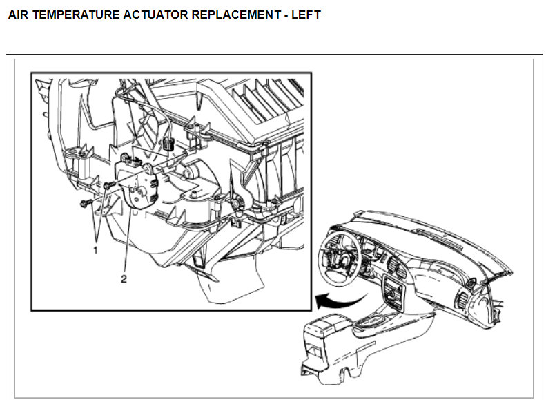

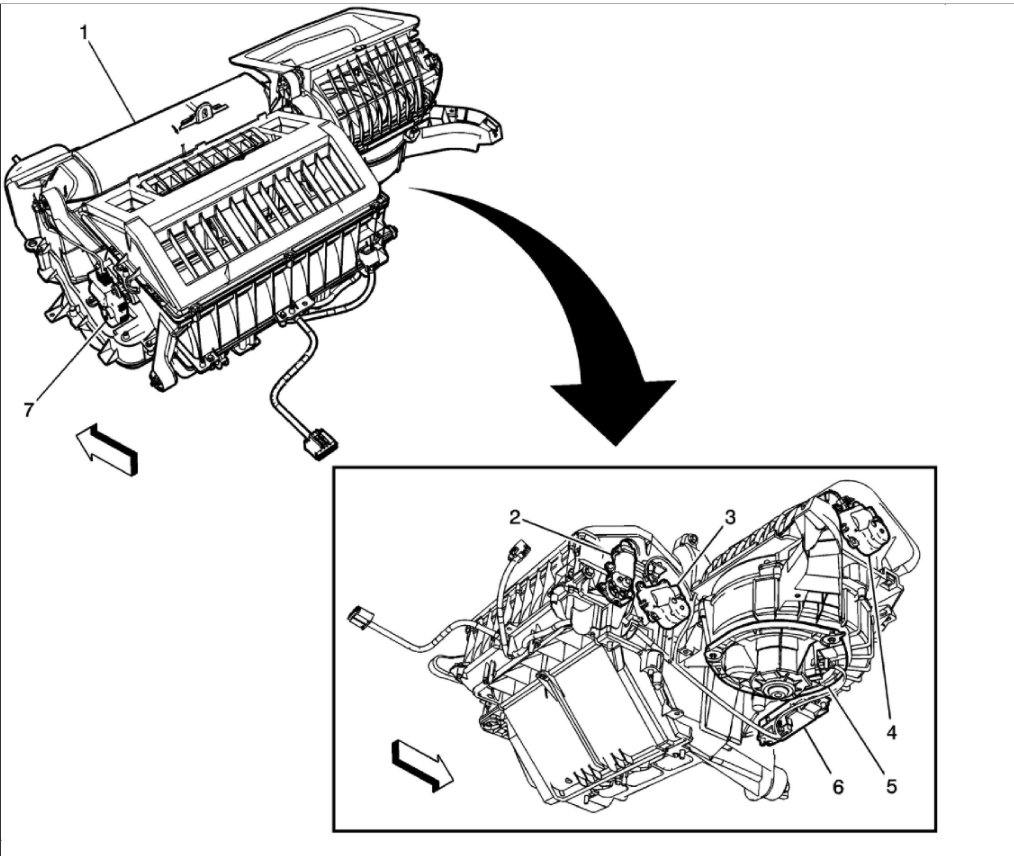

This sounds like you have a problem with the blend door actuator for the temperature. Here is a guide to help you see what I am talking about.
Here is the location for your car (below)

Yep that did the trick for me.
