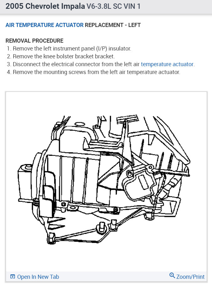

Air will come out of the vents but no heat comes out just cold air?
Monday, October 19th, 2009 AT 12:04 PM
30 Replies
RENAUDTN
  • 636 POSTS

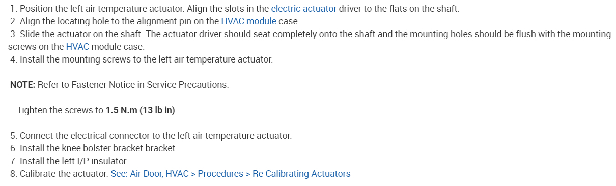

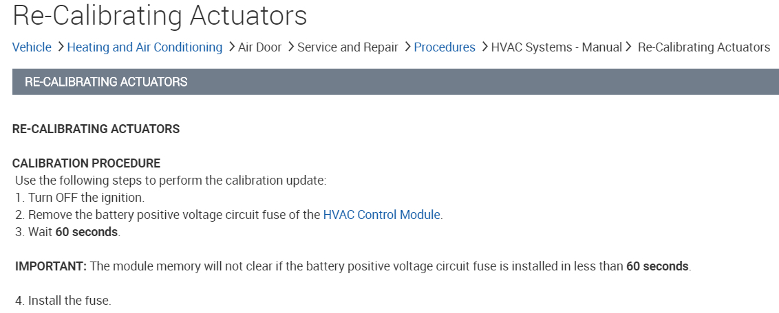

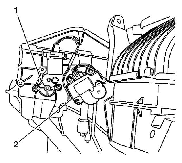

It sounds like you have a temperature blend door actuator that is not working here is a guide to help you see what you are in for when doing the job and the location of the actuator for your car below.
this guide can help as well
Check out the diagrams (Below). Please let us know what you find. We are interested to see what it is. Cheers
-2
Tuesday, October 20th, 2009 AT 4:17 PM
DONO1233
Thank you so much, I got an actuator for $76.00 and installed it. Took longer than I thought but all fixed!

The acuator needs to be reprogramed that is the cost of the labor butyes it also could be the acuator the your 2005 that does deturmine the temp on driver and passenger side

WRENCHTECH
  • 20,761 POSTS
With the engine at full operating temp, locate the 2 heater hoses where they go into the firewall and feel them to see if they are both too hot to hold. If they are.
The heat in that vehicle is controlled by a blend door that regulates heated air flow. It is operated by an electric motor/actuator. The problem can be that the actuator is stripped or inoperative or the door itself could be damaged. This is what needs to be determined by examining the actuator and see if it is responding to heat change commands or not.
