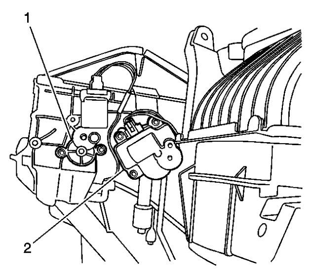

ANITACORBEIL
  • 2005 CHEVROLET IMPALA
  • 150,000 MILES
No heat. Water pump replaced last year. Hose broke about a month ago and all fluid was replaced. There is talk about acuators on line, but I can't locate them in the car book. Is there a fuse for them?
Anita
Monday, January 13th, 2020 AT 6:31 PM (Merged)
HMAC300
  • 48,601 POSTS
Try pulling the hvac fuse for 60 seconds with key on then reinstall sometimes that resets the actuators. There are two one for left and one for right and one for heat/cool #2 is heat but it may be #1 as well. Pic is under the dash on rh side.
