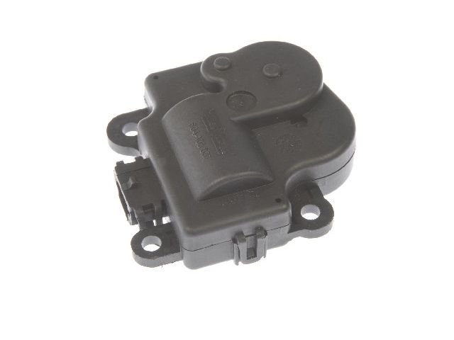

Drivers side heater works, passenger side only blows cold air. no clicking noises.
Dec 21, 2016 at 1:40 PM
STEVE W.
  • 15,349 POSTS

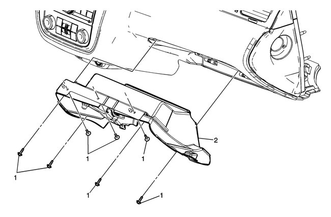

Most likely the temperature control actuator for the passenger side. It could be the temperature control door, but getting in and checking the motor would be the first step. It can be tested or replaced without pulling most of the dash apart. You remove the trim panel for the glove box area. Then the inner trim panel and the motor is on the end of the HVAC box.

Try checking the air blend door/actuator - also check the thermostat, go over this guide to help you fix the problem

MRNOBLES
Yep, got a new actuator for $87.00 heat is nice again, been cold for too long :)

Car made clicking noise under dash couple of days ago now heater only blows cold air, no heat at all
Jan 13, 2020 at 11:02 AM (Merged)
HMAC300
  • 48,601 POSTS

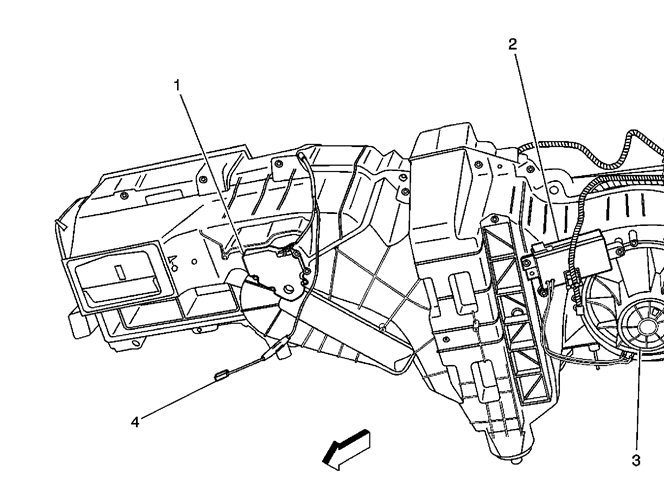

first try pulling hvac fuse under dash for 60 seconds then reinstalling with key on and wait 60 seconds after install. it may reset actuator if not seeif actuator under dash is getting power generic pic included.
