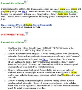

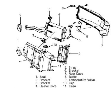

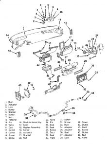

Set aside a weekend..
https://www.2carpros.com/forum/automotive_pictures/30961_hc_2.jpg
https://www.2carpros.com/forum/automotive_pictures/30961_hc1jpg_1.jpg
https://www.2carpros.com/forum/automotive_pictures/30961_hc2_1.jpg
Here's some crap for ya. IF you are a technician that is paid flat rate. The Dealership charges flate rate. Meaning he only gets paid this much time regardless of what it takes. Notice how the time is 5.5 hours?
NOW LOOK AT THE AMOUNT THE TECHNICIAN WILL GET PAID FOR DOING WARRANTY WORK?
ABOUT HALF OF IT. Sorry for yelling I hit the cap unverdently.
No wonder a technician isn't going to look too close for warranty work huh?

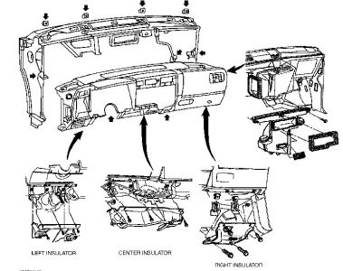

Ok if you would have the temp of the engine checked with an infered thermometer to see what temp the engine is running at. You may have a bad temp. sending unit. Now as for the heater if you would check the actuators. There is one under the hood and one just to the right of the gas pedal area and one on the passanger side. They have vacuum lines connected to them. Make sure the vacuum lines are not cracked and that the actuators hold vacuum. The best I can tell the one near the passenger kick panel is the one that blends the outside to inside air, therefore it controls the temp. Don't know how well it will come out but see pic below.
https://www.2carpros.com/forum/automotive_pictures/249564_Graphic_187.jpg
