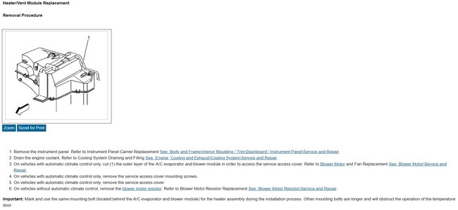

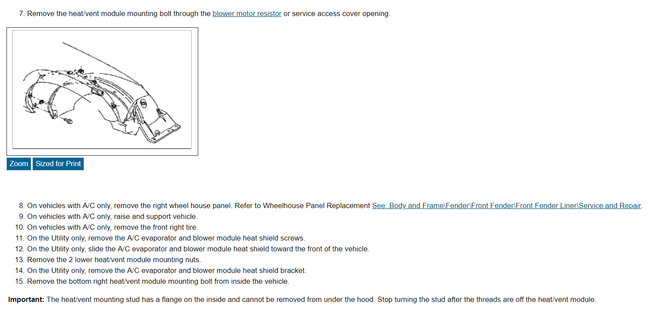

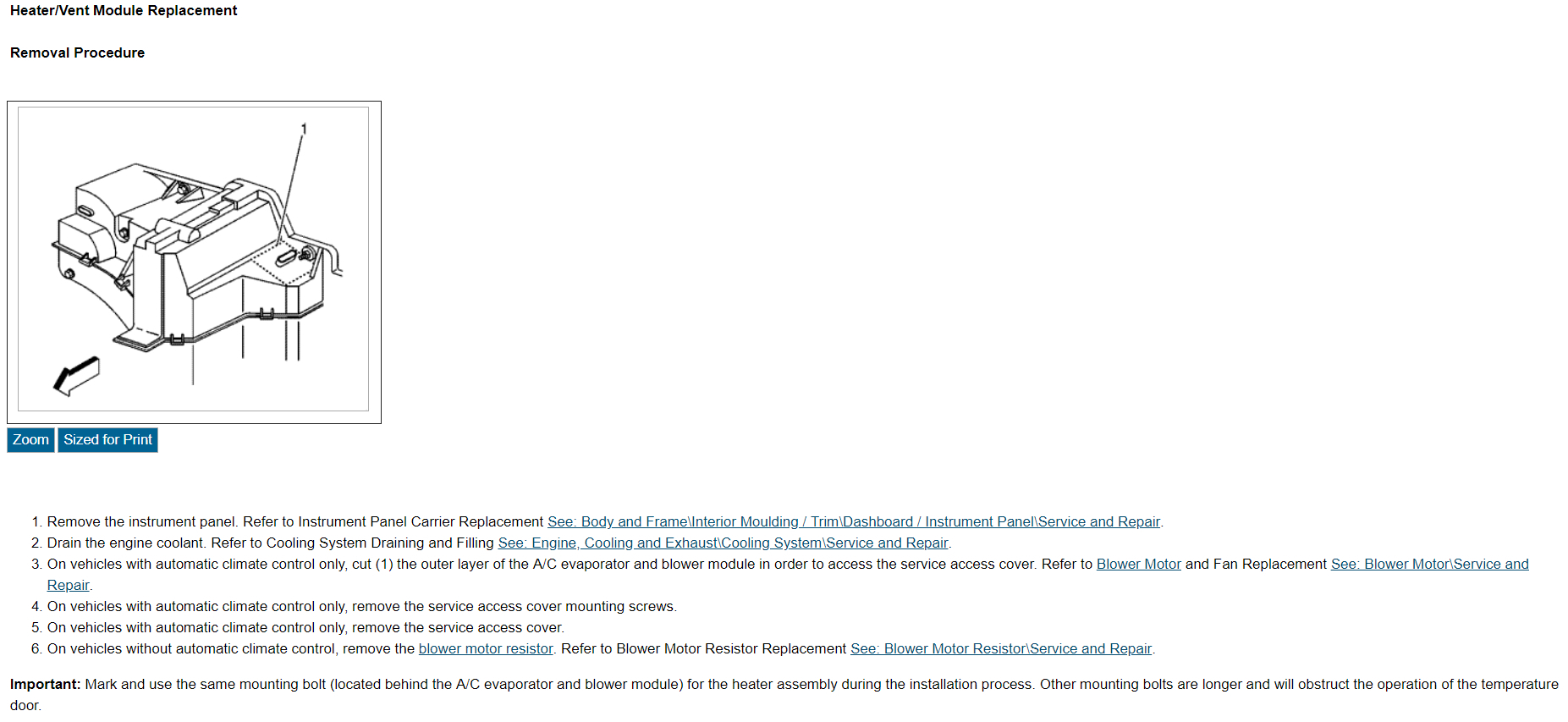

2CARPRO JACK
  • 11,533 POSTS
My labor guide calls for 8 hrs with a/c. That means the entire dash has to come out of the truck far enough to get the entire HVAC plenum out from under the dsh. Not a DIY project fo the weak of heart. Need to have the a/c evacuated and then vacuumed down and recharged when done

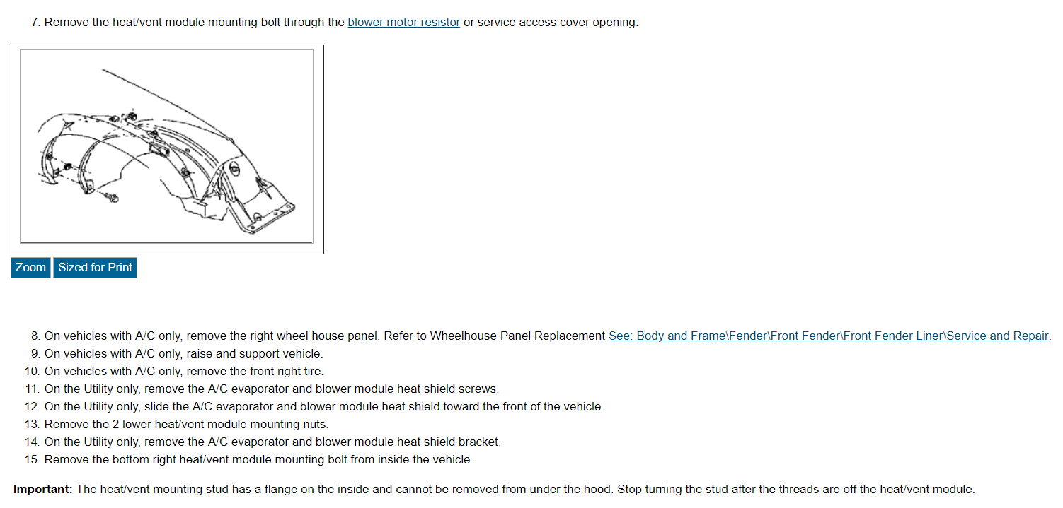

BOBBEERS
I need detailed step-by-step instructions on how to replace the heater core.
Oct 3, 2020 at 4:51 AM (Merged)

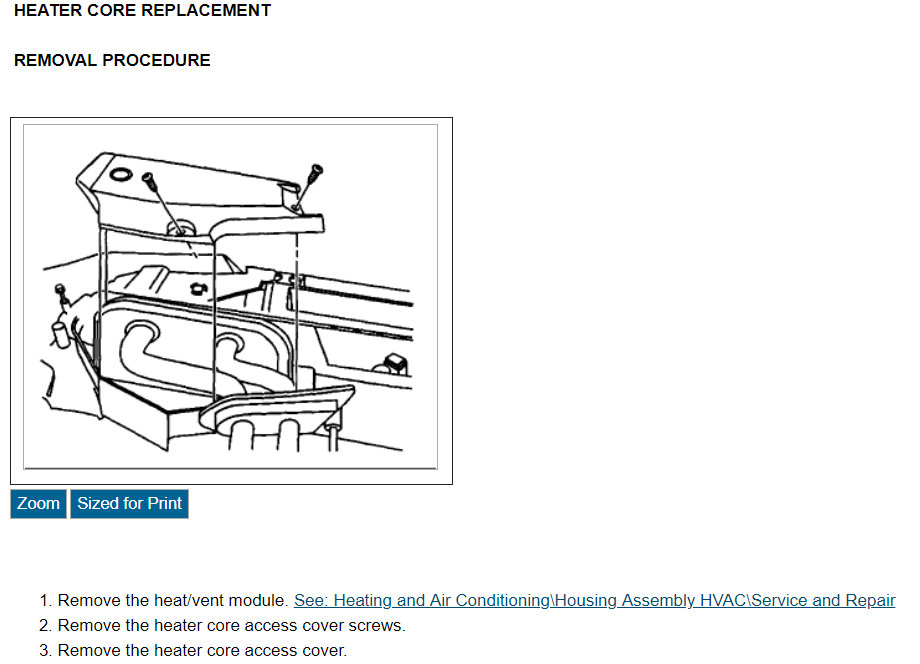

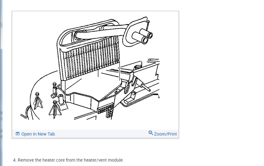

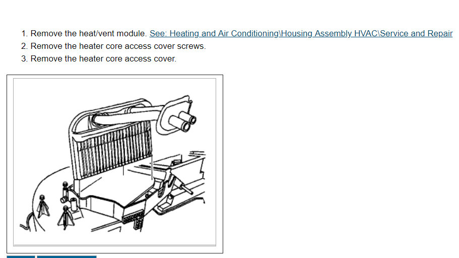

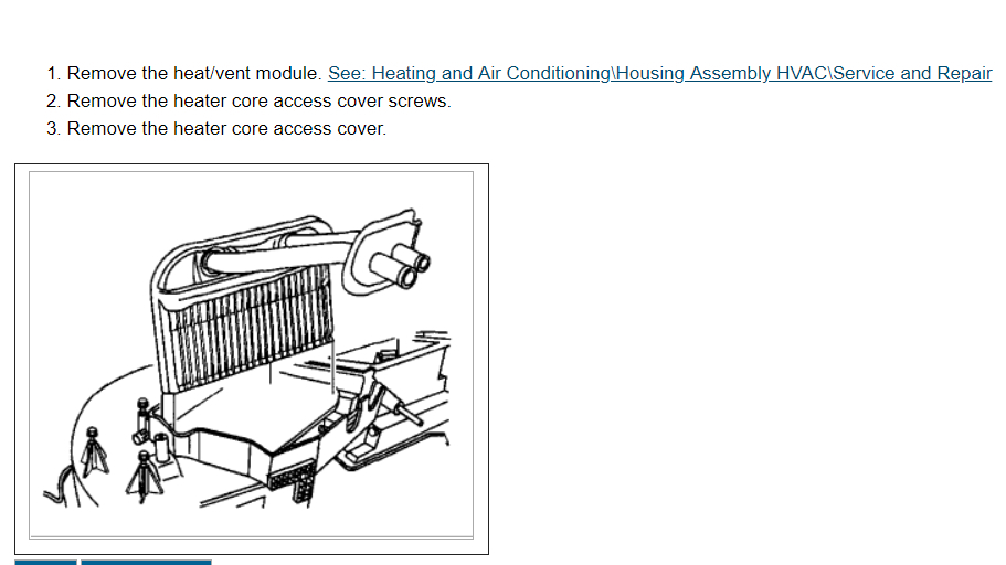

TOOOMANYTOYS
  • 513 POSTS
Remove the HVAC module. See: Heating and Air Conditioning\Housing Assembly HVAC\Service and Repair
Remove the heater core access cover screws.
Remove the heater core access cover.
Remove the heater core from the HVAC module.
INSTALLATION PROCEDURE
Install the heater core to the HVAC module. NOTE: Refer to Fastener Notice in Service Precautions.
Install the heater core access cover. Tighten Tighten the heater core access cover screws to 1.9 N.m (17 lb in) .
Install the HVAC module. Refer to Heater/Vent Module Replacement.

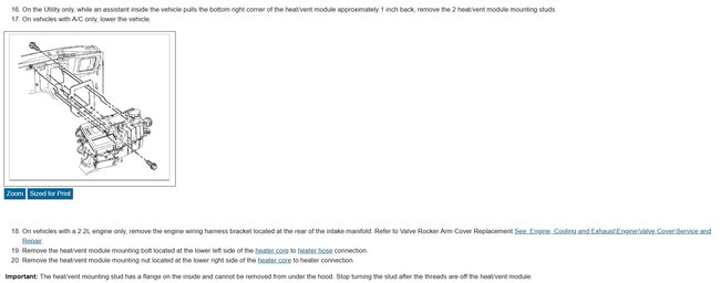

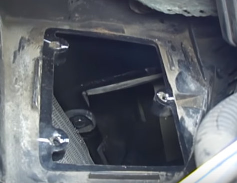

What size bolt that goes in the heater box outside under the hood and where when you replace the heater?
Unfortunately, we don't have that level of detail on any of the procedures or guides. However, from memory they are normally 5/16 socket.

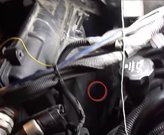

https://www.2carpros.com/articles/replace-heater-core
If you can, get a picture of what you are dealing with and we may be able to identify the size just by looking at it. However, if the ones you are talking about are those "hidden" bolts, unfortunately you may have to do it by feel because hopefully if this was ever done before the correct size bolts were put back in. Thanks
Just following up on this. Is this the bolt that you are talking about? See the attached.
If it is, then I believe these are 8 or 10mm. However, most people drill a hole in the plastic housing in front of the bolt and then they can get an extension in a more direct line. I circled the location people do this and then they will need to use a sealant of some sort to seal the hole.
HARRY P
  • 2,292 POSTS
Adding to what Kenny said about that particular bolt, ice done that job a couple of times. It's a 10mm bolt. I never bothered putting it back in when reassembling because there are plenty of other bolts to hold it all together. But if you really do want to put it back in there, then do as he says with drilling and using a ratchet with a long extension.

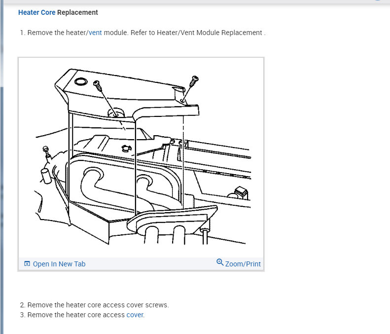

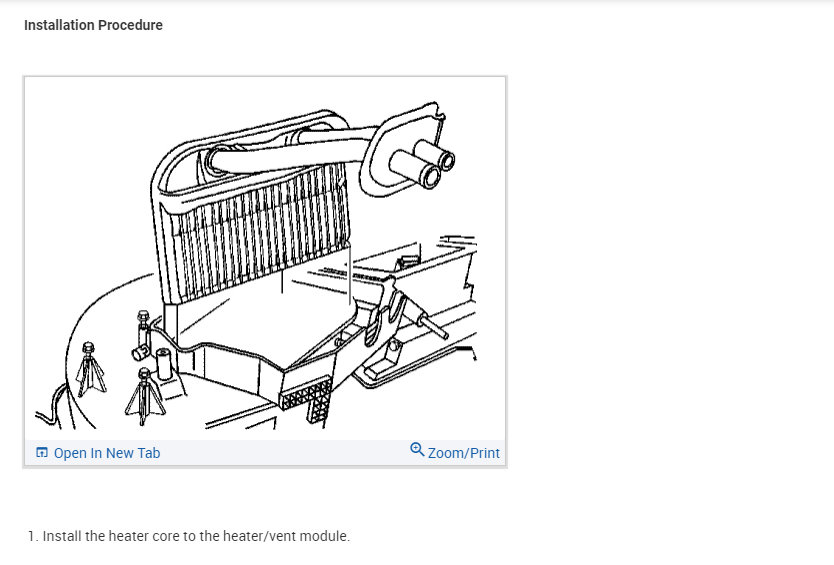

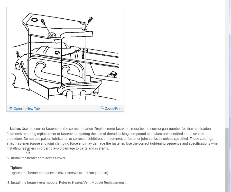

DR LOOT
  • 2,311 POSTS

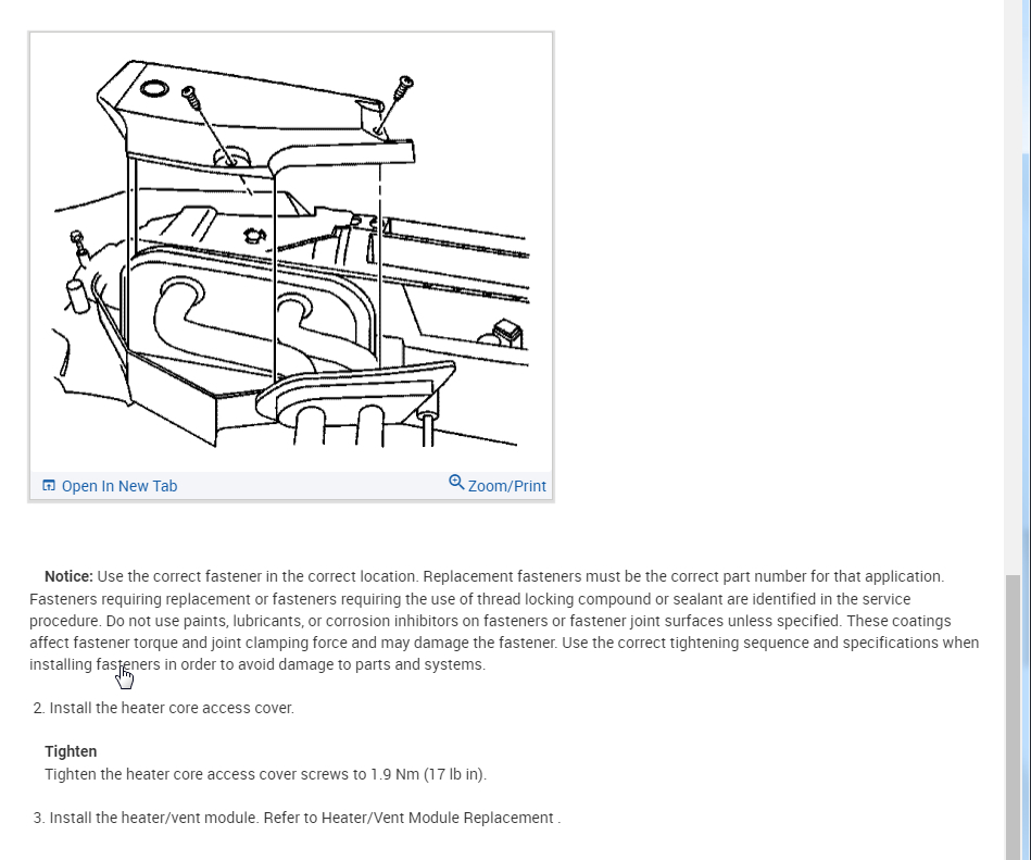

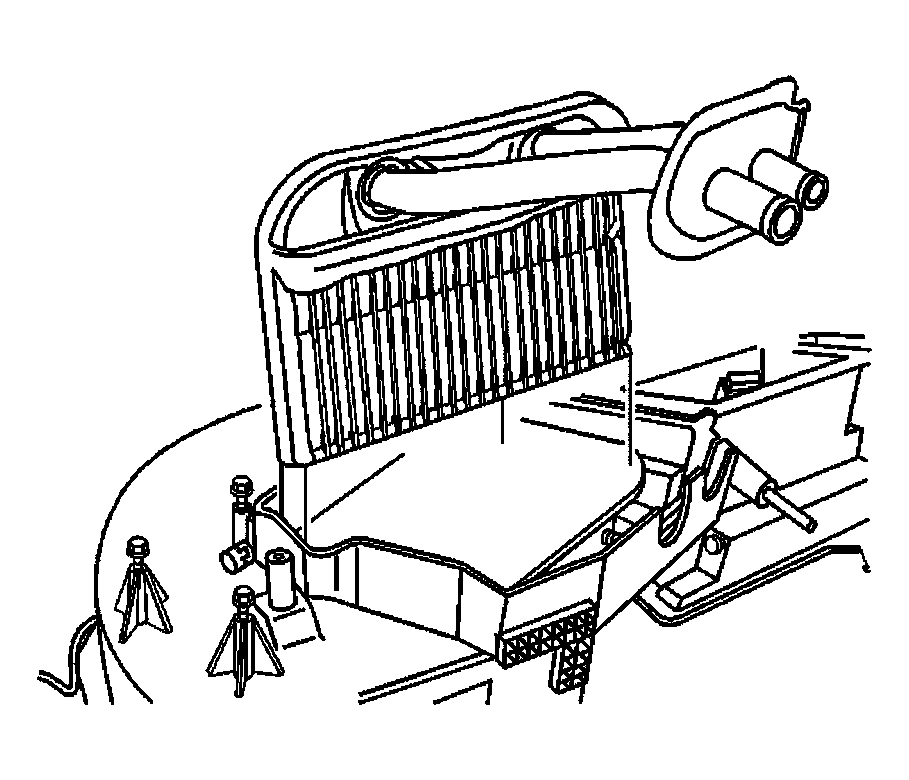

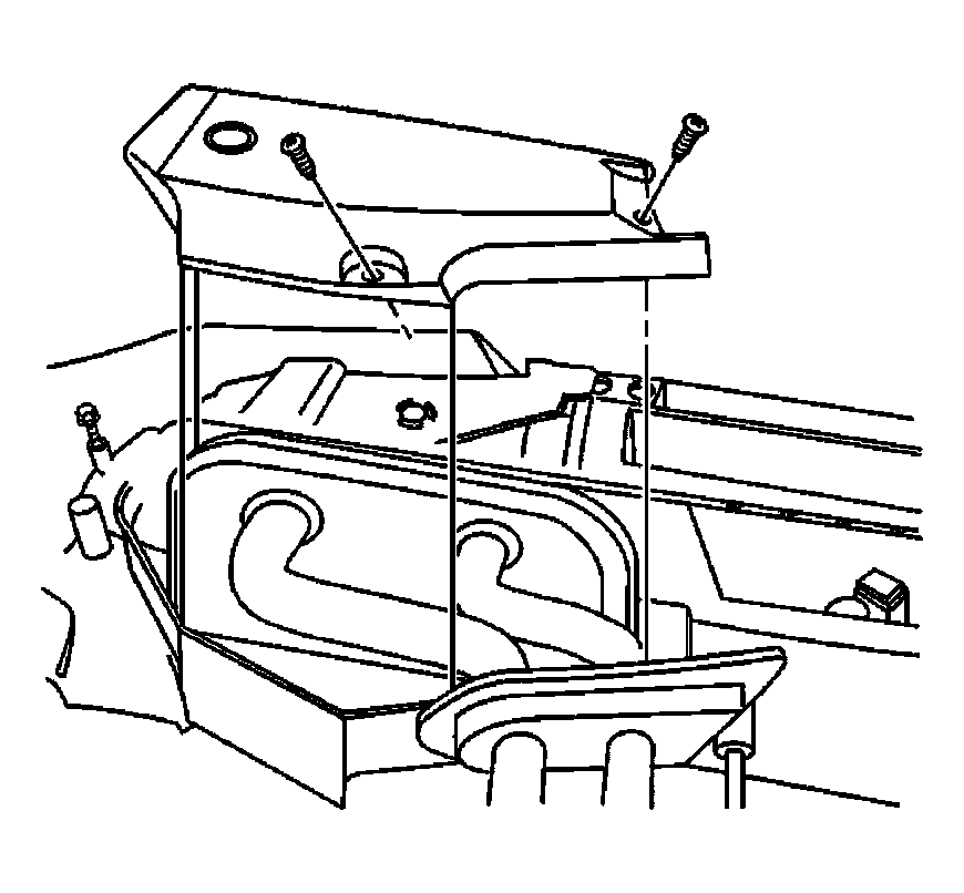

Removal Procedure
Remove the heater/vent module. Refer to HEATER/VENT MODULE .
Fig. 14: Identifying Heater Core Access Cover & Screws
Courtesy of GENERAL MOTORS CORP.
Remove the heater core from the heater/vent module.
Fig. 15: Identifying Heater Core
Installation Procedure
Install the heater core to the heater/vent module.
Fig. 16: Identifying Heater Core
NOTE:Use the correct fastener in the correct location. Replacement fasteners must be the correct part number for that application. Fasteners requiring replacement or fasteners requiring the use of thread locking compound or sealant are identified in the service procedure. Do not use paints, lubricants, or corrosion inhibitors on fasteners or fastener joint surfaces unless specified. These coatings affect fastener torque and joint clamping force and may damage the fastener. Use the correct tightening sequence and specifications when installing fasteners in order to avoid damage to parts and systems.
Tighten
Tighten the heater core access cover screws to 1.9 N.m (17 lb in).
Fig. 17: Identifying Heater Core Access Cover & Screws
Install the heater/vent module. Refer to HEATER/VENT MODULE .
