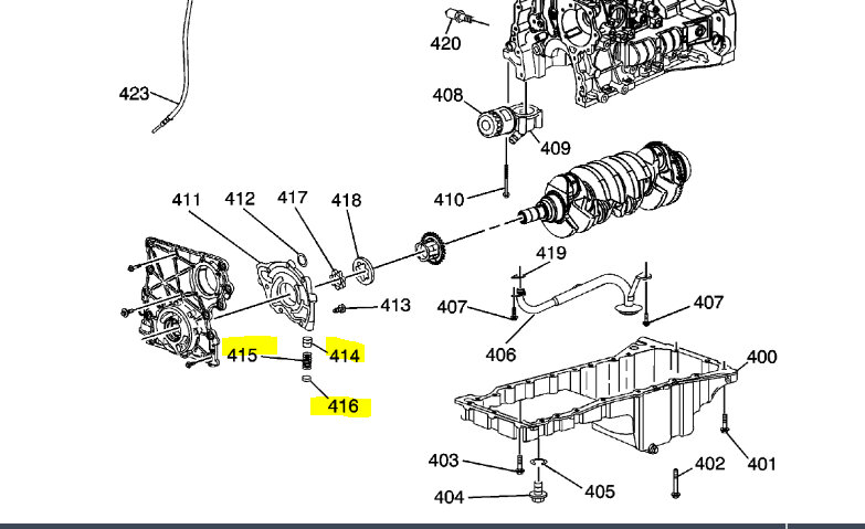

We have talked about my ford f150 truck that heater was blowing cold air and now have a blown engine in it. Well, i drove by the other day and it;s still sitting in the same spot. Im afraid im not going to get it back for a long time. or if at all.
There is a question i would like to ask if you could help me with....Is there a oil pressure release on an oil filter on a 2006 chevy Colorado crew cab 4 by 4 or something that would prevent it from coming off and pumping out all the oil? If put on correctly and installed right wouldnt they put the oil filter on and pressure guage it which would make it almost impossible to just fall off?
Dec 13, 2022 at 12:12 PM
  • 110,251 POSTS
That is upsetting. As far as the oil filter is concerned, it won't fall off if it is tightened. Actually, if the oil pressure was extreme, it would have ruptured before coming off.
I'm not sure if you have the 4 or 6-cylinder, but I attached a picture below and highlighted the oil pressure relief valve on the 4 cylinder. There isn't one in the oil filter itself.
Let me know if this helps.
See pic below.

Mine is 6 CYL.I knew there wasnt one on the oil filter and i agree with you if put on right wouldnt just fall off would rupture. I towed it home in nutural and parked it i thought maybe i could turn the motor over (after i put oil filter back on and new oil in it) took a wrench and put it on front of motor and tried to turn motor over by hand (in nutural) but wouldnt turn. put a breakover bar and still wouldnt turn.so i took out all spark plugs and sprayed PBR down in the cylinders and am letting it soak. Someone told me to pour 2 cycle gas in the cylinders and fill it up and try turning the motor then but not sure i want to do that.
