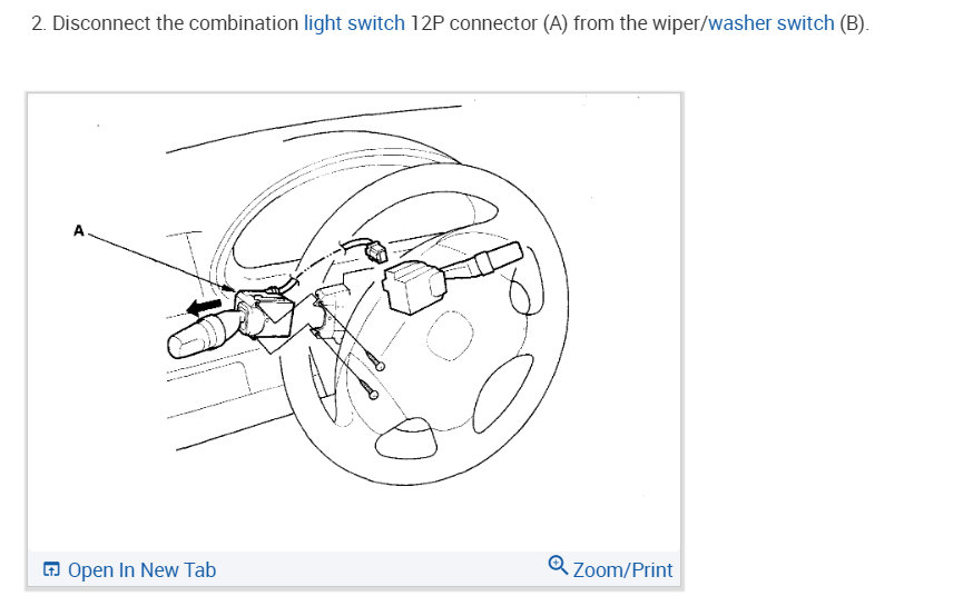

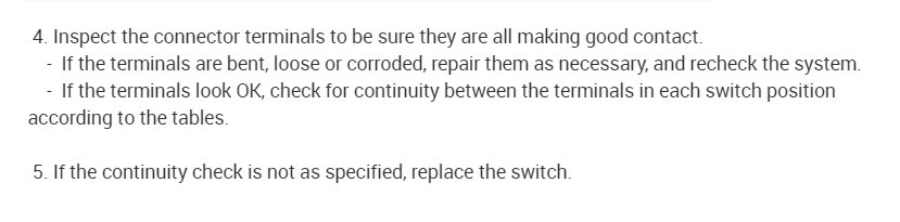

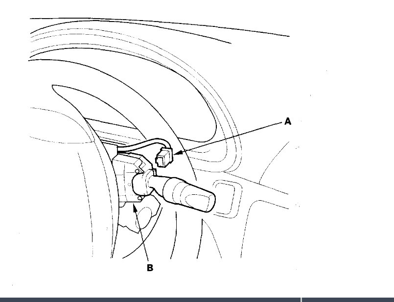

I have included all the information that you requested in the diagrams down below. There I have included directions on how to remove the steering column cover and how to test the combination switch to make sure it is working properly. To do this though you will need to have a multi-meter set in the Ohms setting to test for continuity. If you are unfamiliar with how to use a multi-meter then I have included a link down below for you to go to.
Please go through this guide and do the tests on the combination switch and get back to us with what you find out.

Hi Alex, thanks for the link. I don't see any diagrams or directions attached to your post? Am I looking in the wrong place?

I'm sorry, my bad. I get so busy sometimes I forget to include them. They will be attached to the diagrams down below.

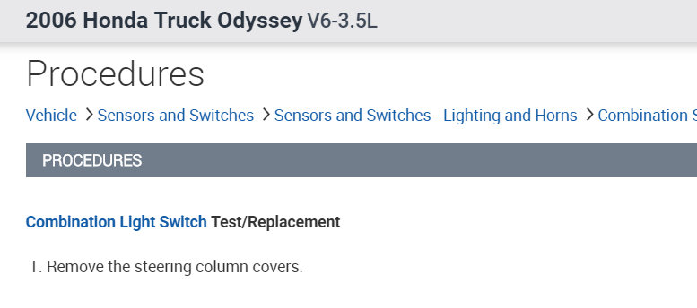

Could you also add the instructions on how to remove the steering column cover?
I seem to get stuck on dumb little things that should be easy to do.
Thanks,
Steven
Apr 2, 2019 at 7:24 PM
SCGRANTURISMO
  • 4,897 POSTS
Hello again,
My reference materials all have what I already included. They really don't give specifics on how to remove it, they just say to remove it.

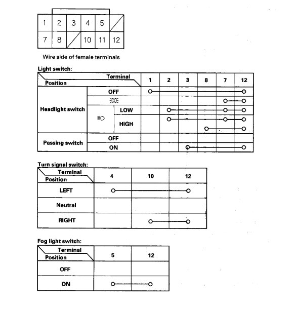

Alright, so I managed to attach a replacement switch and it didn't fix anything, so I reattached the original.
So I went out and bought a multimeter and did some tests.
I had the battery hooked up when I did the tests, so hopefully that's what you're supposed to do (But maybe you don't need it on when testing for continuity?).
I tested each fuse in the primary under-hood fuse box individually, and they all came back as good (a reading of 0.00).
I assumed that you put one of the leads on one fuse and the other on the far end of the loop (or maybe you're supposed to progress through each fuse in order?).
In any case, I went through the diagram and here's what I found:
Headlight Switch
off - open loop
running lights - good
Low - open loop
High - good from 8->12 OL 2->12
passing switch 3->12 (not sure what a passing switch is, but put one lead on 3, the other on 12) - good
Turn Signal Switch:
Left - 4->12 - got a reading of .371 so I'm not sure what that means.
Right - No fuse in 10... according to owner's manual, it's not used.
Don't have fog lights, so didn't test it.
So, should I try replacing fuses 1,2 and 4? Or is there something else going on here?

Hello again,
If you got OL on the low beam headlight continuity test(that is testing by backpinning the cavities of the connector with the multimeter set in Ohm's setting than the switch is bad and needs to be replaced.
