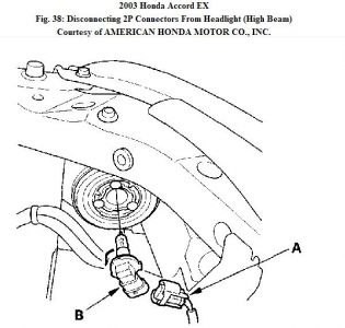

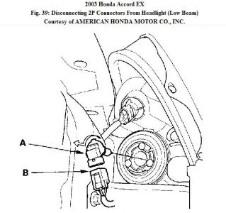

how do I change the front head light? Do I need to buy the whole light panel or just change a bulb?

Hi Todd, If the bulb is fused, it can be replaced. I do not have the diagrams for Odyssey and have here for Accord instead which is similar. BULB REPLACEMENT HEADLIGHT 1. Disconnect the 2P connectors (A) from the headlight. Headlight (high beam) : 60 W Headlight (low beam) : 51 W

2. Turn the bulb socket (B) 45 ° counterclockwise to remove the bulb. 3. Install a new bulb in the reverse order of removal.
