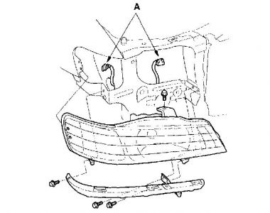

2000 Honda Odyssey I need to change a head light

can i have a picture of how to do it?

Hi jmvida, Hope the following helps. HEADLIGHT REPLACEMENT CAUTION: Headlights become very hot during use; do not touch them or any attaching hardware immediately after they have been turned off. 1. Remove the front bumper. 2. Disconnect the connectors (A) from the headlight.
https://images.2carpros.com/forum/automotive_pictures/192750_Headlamp00Odyssey01_1.jpg
Fig. 26: Disconnecting Connectors From Headlight Courtesy of AMERICAN HONDA MOTOR CO., INC. 3. Remove the four mounting bolts, then remove the headlight assembly. 4. Install the headlight in the reverse order of removal. 5. After replacement, adjust the headlights to local requirements (see HEADLIGHT ADJUSTMENT ).
