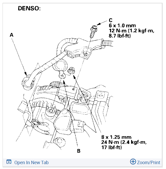

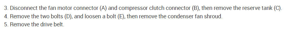

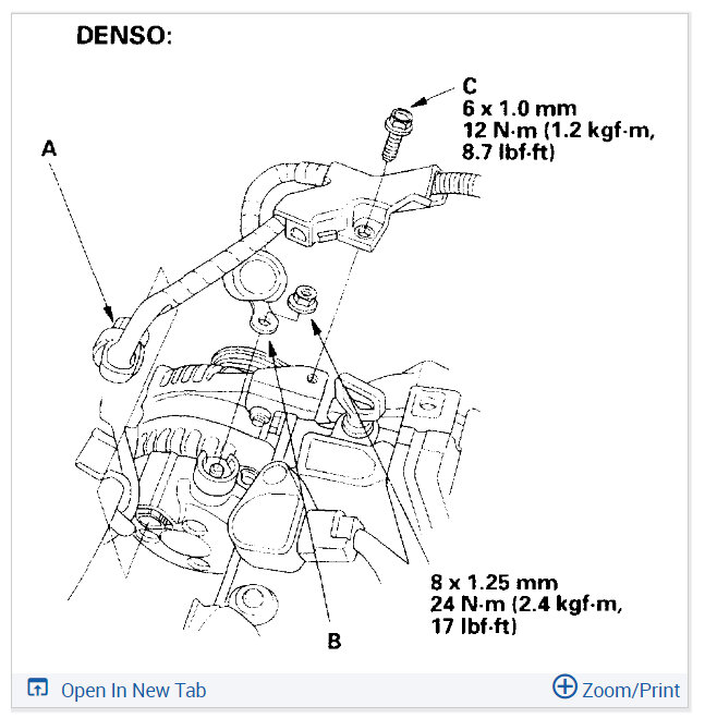

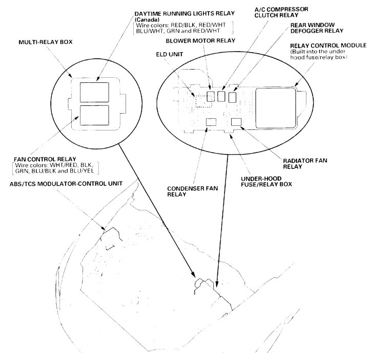

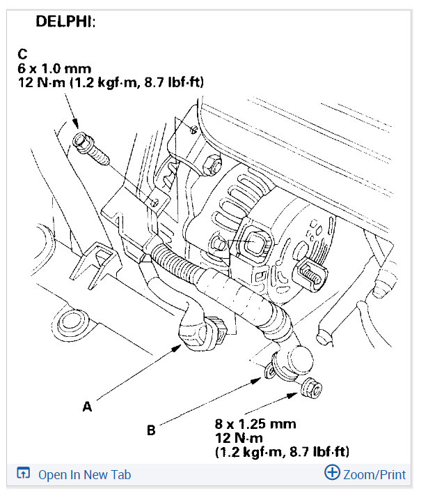

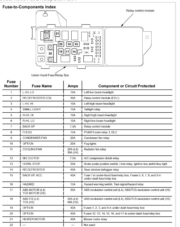

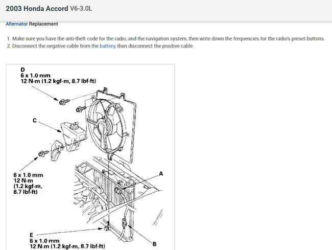

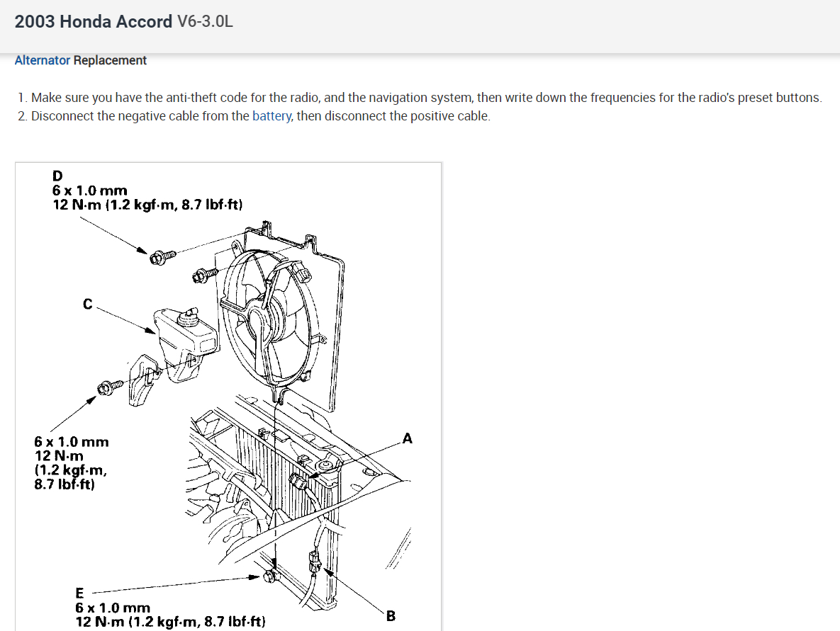

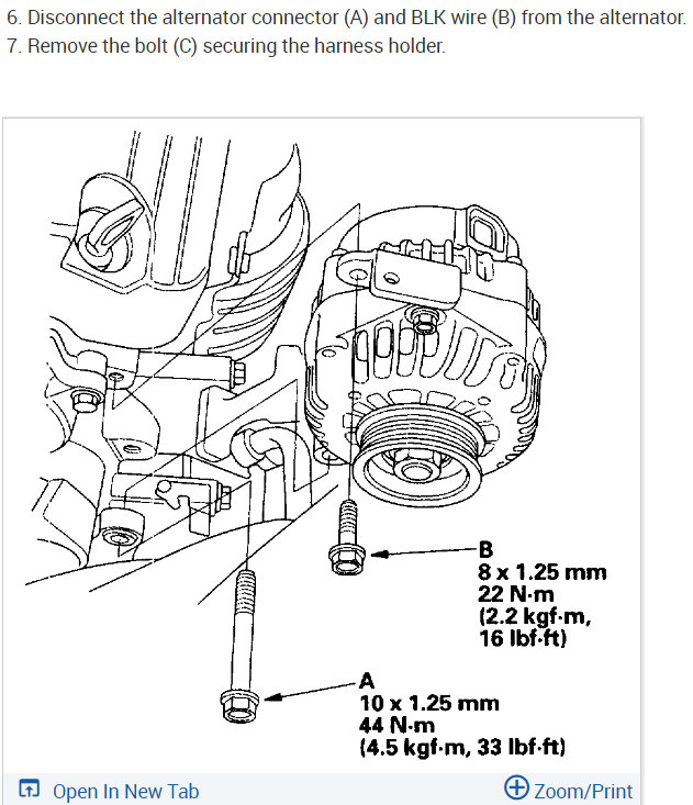

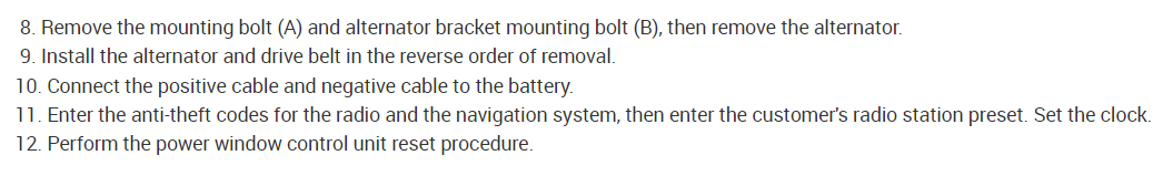

Here is how to change the alternator out in case it is not charging. If the alternator is okay, (battery warning light off) then I would replace the headlight control relay under the hood in the main fuse panel. Here is the location as well, it should say on the fuse panel lid which one is for the headlamps. Check out the images (below). Please let us know what happens.
