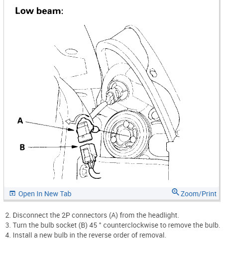

Hi there! i have recent purchase a used Honda Accord 2003 to use as a commuting car from work and back home.The last owner did most of his driving in the night time, and now the vehicle has 72k miles with the majority of the miles being driven with the lights on.I need to changed my front low beams (9006) but it also seems like i gota remove the battery to reach the driver BULB and a few other things to remove the passenger BULB.Does Anyone Know A Easier Way.. Or The Correct Way To Replace The Low Beams?Thanks a bunch, Will definitely leave good feedbackJL

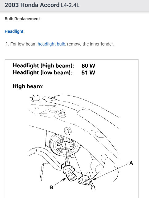

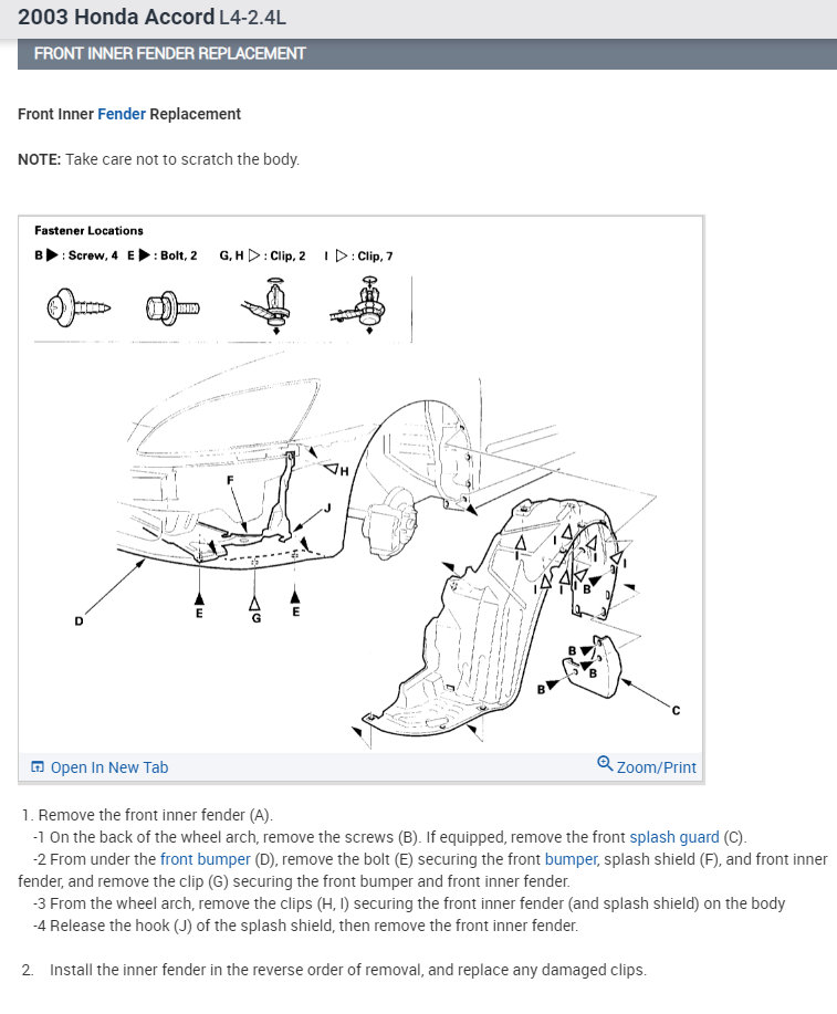

The best way to replace the low beam headlight bulbs is by removing the inner fender liner inside the wheel well.

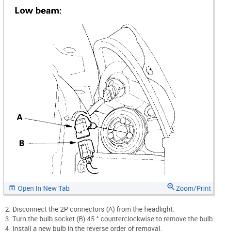

You do not have to remove the complete liner, just enough to provide you access to the back of the headlight housing. Simply twist off (counterclockwise) to remove the bulb and replace.
Careful not to touch the glass part of the light bulb as the oil/grease from the skin will reduce lifespan of the bulb.
