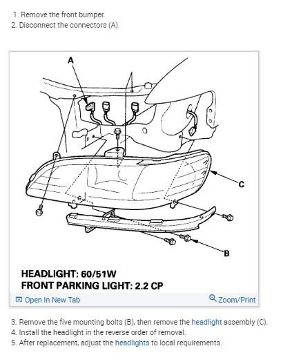

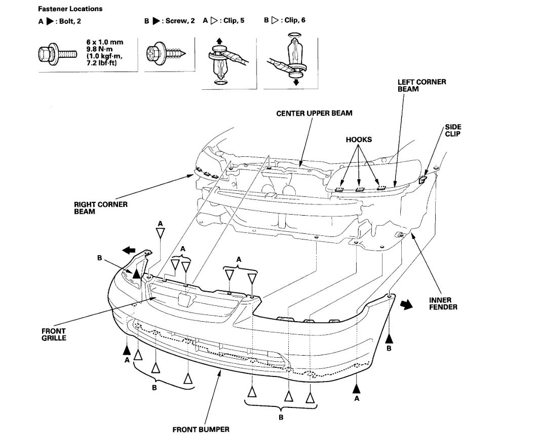

Does anyone know of a place online that shows you how to replace the Whole Headlight Unit for a 99 Honda Accord? I got the over the counter manual at Murruy's Auto Discount and it's not specific enough to even do the job. I even had Honda fax me over something from there interactive network but it is also not very specific. Just shows where the screws come off and just says...Remove bumper. It's a complicated task and I don't want to mess it up.
May 25, 2007 at 6:32 AM
IMPALASS
  • 3,112 POSTS
The front bumper cover has to be removed to get the headlight assembly out. Don't forget to have the headlights readjusted after you're done.
See the diagrams below for instructions on bumper and headlight removal:
