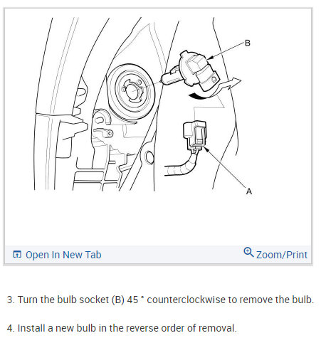

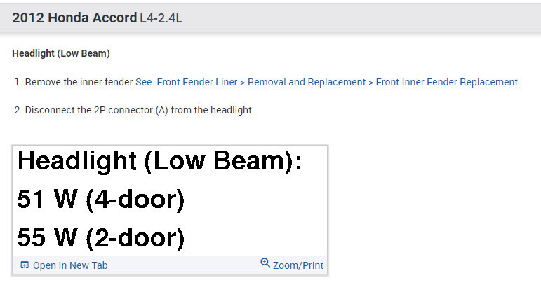

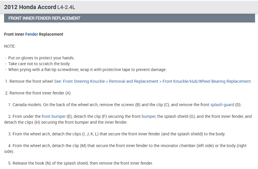

My driver side low beam on my car does not work the high beam does?
Mar 30, 2017 at 10:54 PM
DANNY L
  • 5,648 POSTS

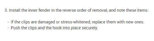

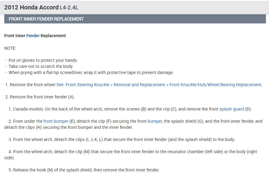

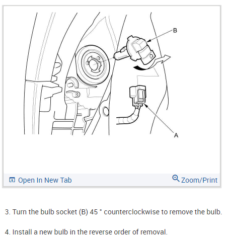

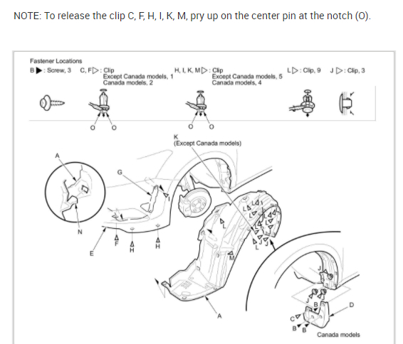

It sounds like your low beam bulb has failed and needs replacement. Here is a guide to help you step by step with instructions in the diagrams below to show you how on your car. This video shows the job being done on a similar car but the process is the same
https://youtu.be/T9zoLXkaRQg
https://www.2carpros.com/articles/how-to-replace-a-headlight-bulb

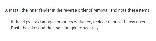

I've attached picture steps below on how to remove the inner fender liner to gain access to the headlamp bulb as well as how to replace the bulb itself on your car. Hope this helps and thanks for using 2CarPros. Check out the diagrams (Below). Please let us know if you need anything else to get the problem fixed.
