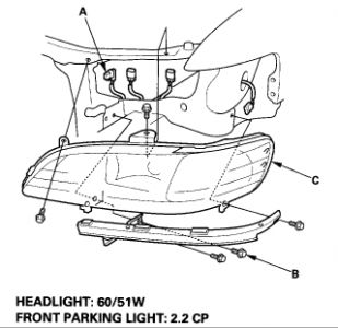

Do I only need to take out the battery to change the headlight , or does the complete front shroud and bumper cover need to come off?

Hello It doesn't look like the battery needs to be removed according to the instructions. Comes out as one piece. I have attached what we have. Remove the front bumper. Disconnect the connectors (A).

Remove the five mounting bolts (B), then remove the headlight assembly (C). Install the headlight in the reverse order of removal. After replacement, adjust the headlights to local requirements.
