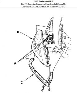

How do I remove the headlight lens on the engine passenger side. There is rust just at the edge and I need to Dremel it out and paint.

The headlight lens are sealed onto the assy. This video shows the job being done on a similar car but the process is the same. https://youtu.be/7_EmrvzT9HI Here is a guide to help you step by step with instructions in the diagrams below to show you how on your car. https://www.2carpros.com/articles/headlight-lens-replacement To remove the headlight assy, you need to remove the front bumper to gain access to the holding bolts of the headlight assy.
