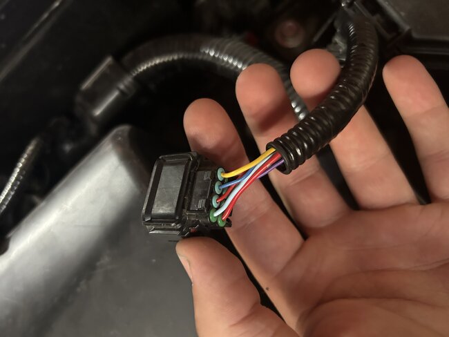

I had damage to the front left of my car listed above, so I changed the left headlight, but it’s turn signal doesn’t want to work, the signal works though when you have the hazards on. I plugged in the headlight into the right-side connector, and it works perfectly on that side. What could be the issue, any ideas?

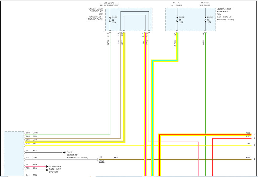

If the headlamp is working and the DRL, it isn't a ground problem. So, we need to check for power at the connector. By chance, does the rear left signal work?

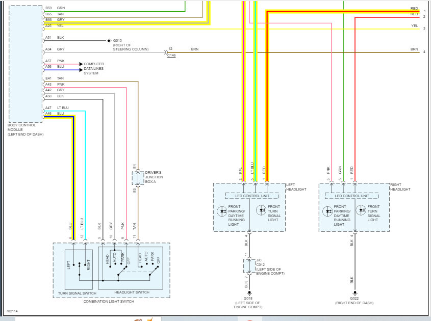

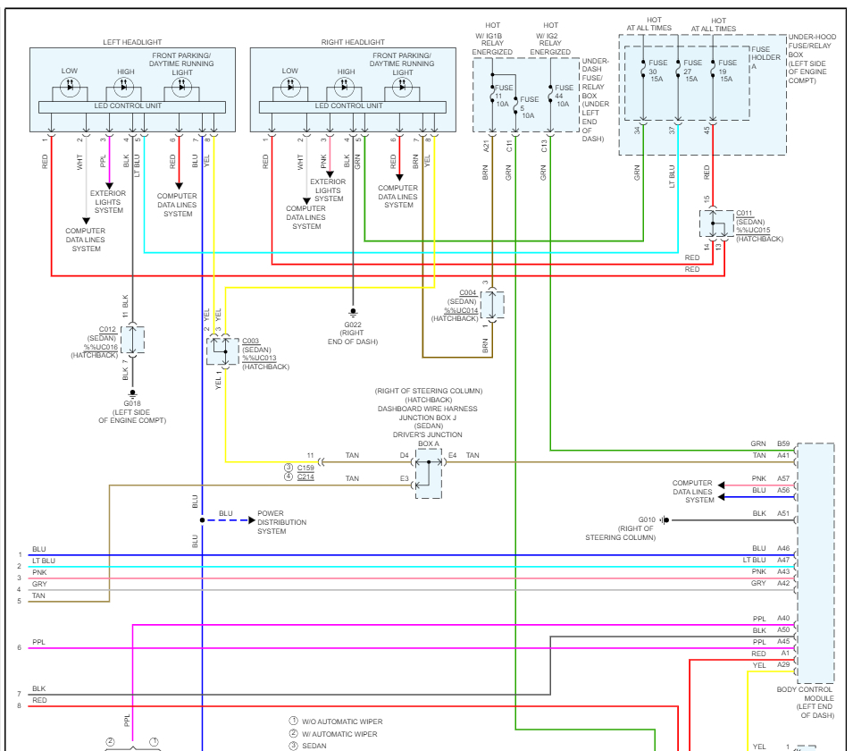

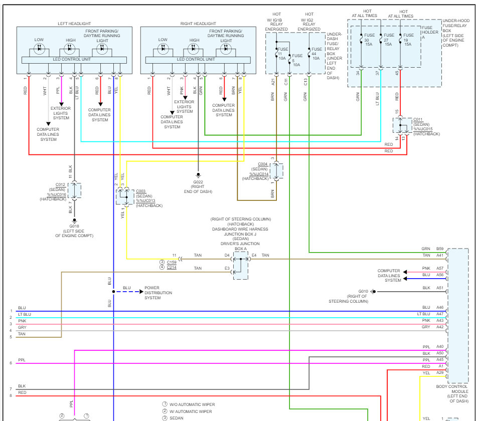

If you look below, I attached the wiring schematic for the light assembly so that you have a reference.

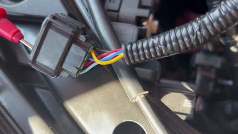

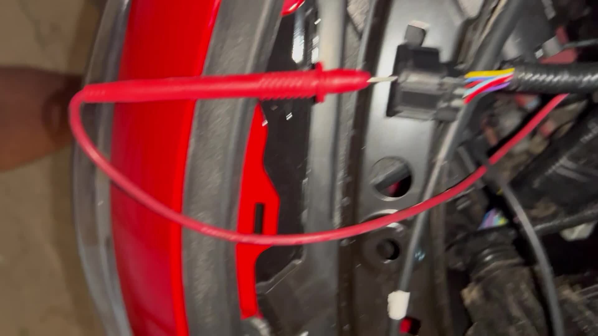

With the connector disconnected at the light assembly, confirm the light blue wire has power at all times. If it does, turn the key on and the left turn signal. Check the purple wire for power.
Let me know what you find or if you have questions.
See pics below. Note: I highlighted the relevant wiring.

Light blue wire has full power, but the purple wire is jumping all over the place. And yes, the rear turn signal does work.

I also checked the right side headlight connector and it was reading the same on every wire?
Aug 21, 2023 at 2:51 PM
  • 110,248 POSTS
All the readings are the same on the right side? What do you get if you check the red wire on the left side? Also, when you check things on the right side, the signal power should strobe. Is that happening?

  • 17 POSTS
The small red wire gets like .24 voltage and the thicker ted wire gets 12v, I’m not sure what strobe means so I couldn’t confirm that on the right side headlight.

I'm only seeing one red wire at the assembly. You have two?

  • 17 POSTS
Yes, I have two red wire a thinner one and a thicker one.

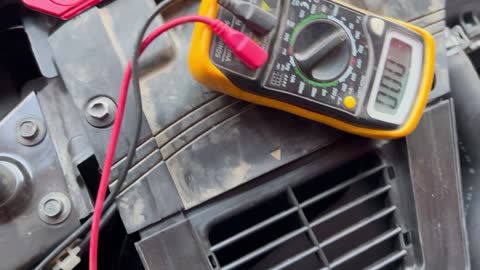

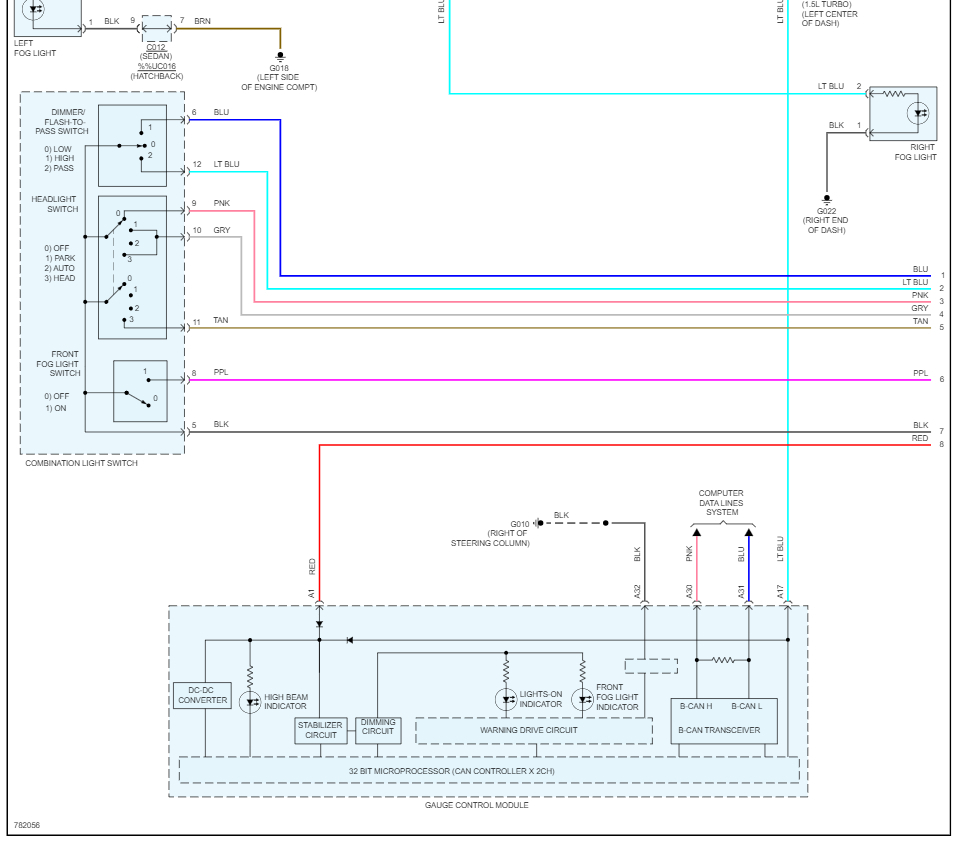

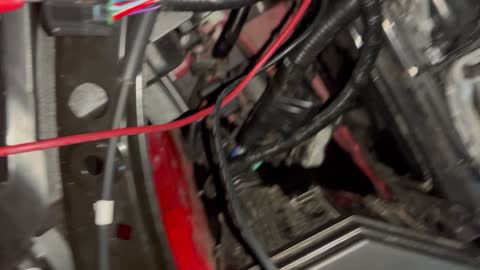

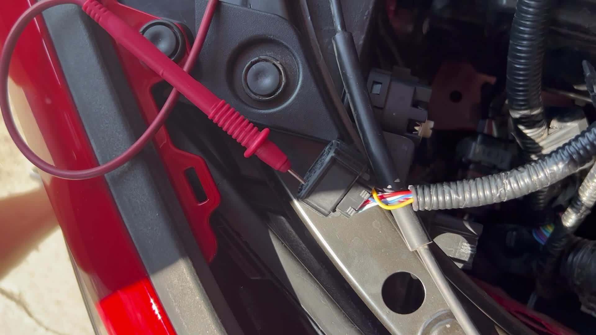

It looks like the aftermarket headlight is not good, the light blue wire goes to the fuse directly so it should have 12 volts all the time. Can you retest the light-blue wire for 12 volts please? The video is great to help us fix it. Please keep uploading. Also let's check the ground #G018 near the left side of the engine compartment. This guide can help, and I have included the headlight wiring diagrams so you can see how the system works.

ELIMAK
  • 17 POSTS
Light blue wire has 12v while car is off and on.

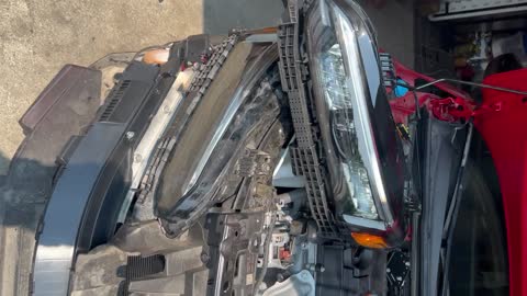

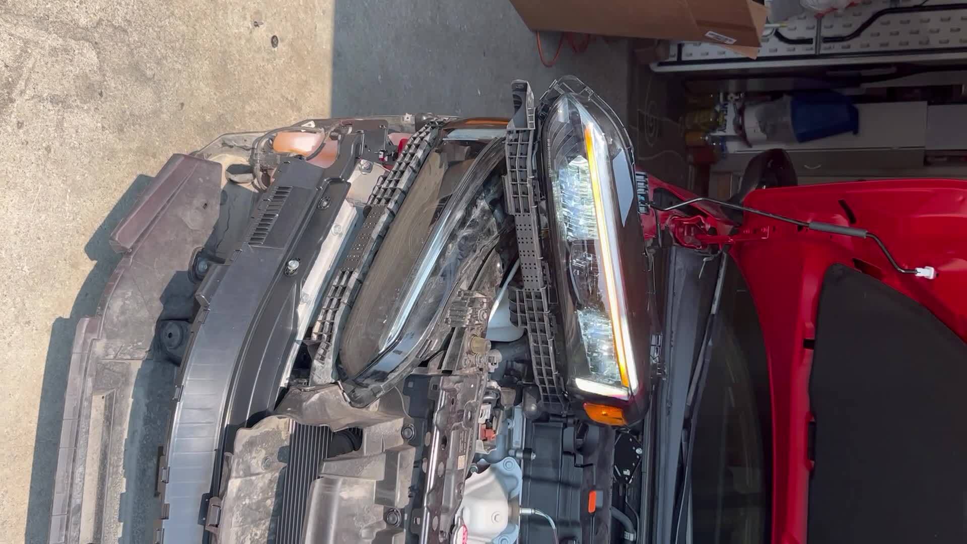

ELIMAK
  • 17 POSTS

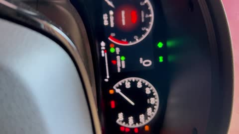

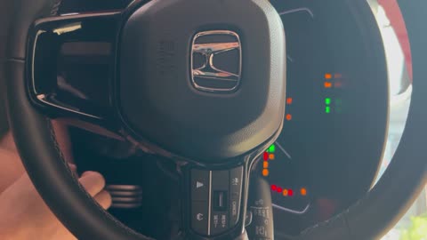

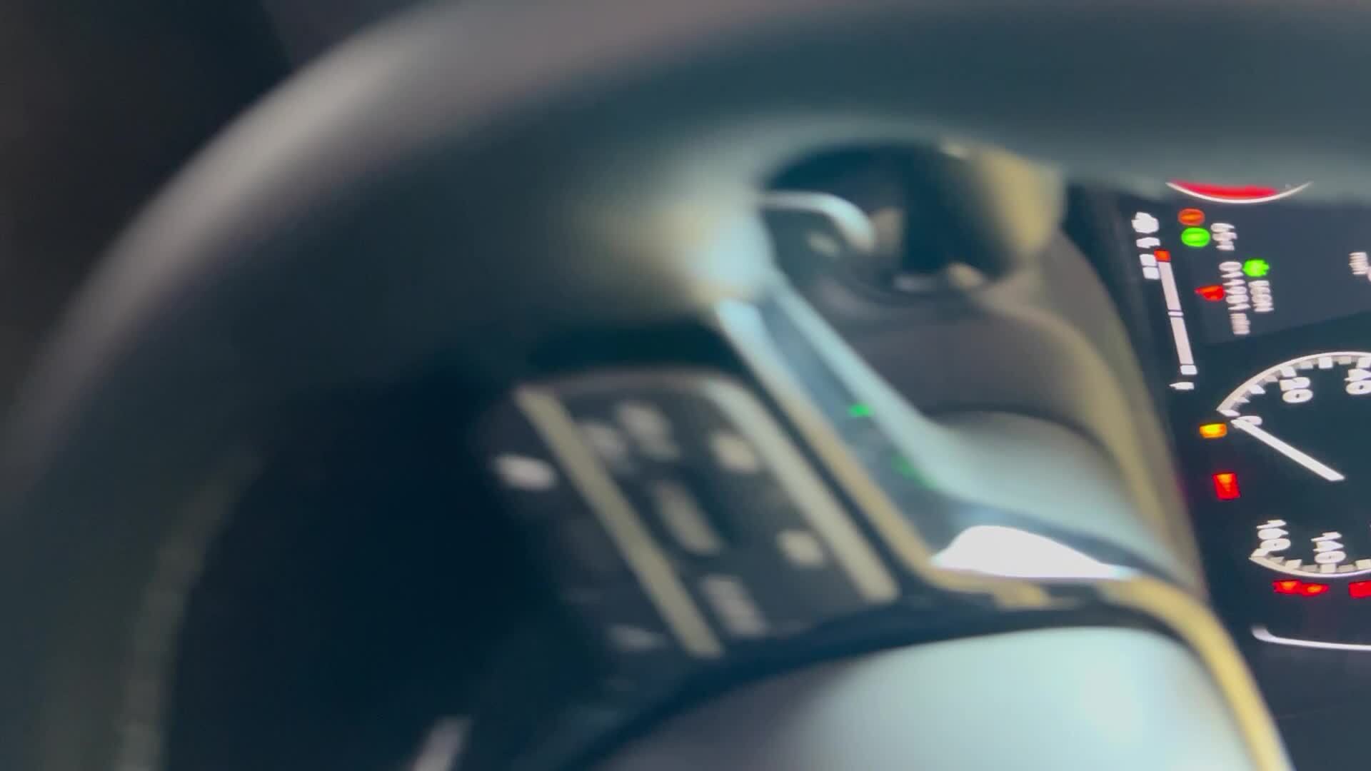

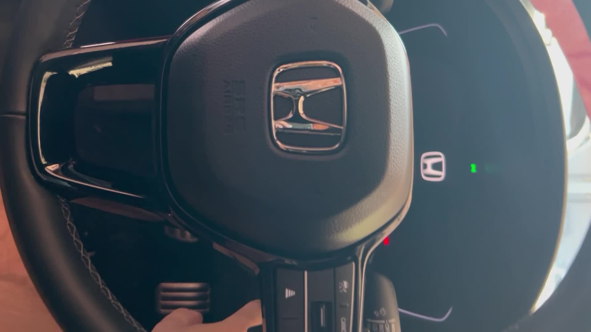

The issue I’m experiencing.

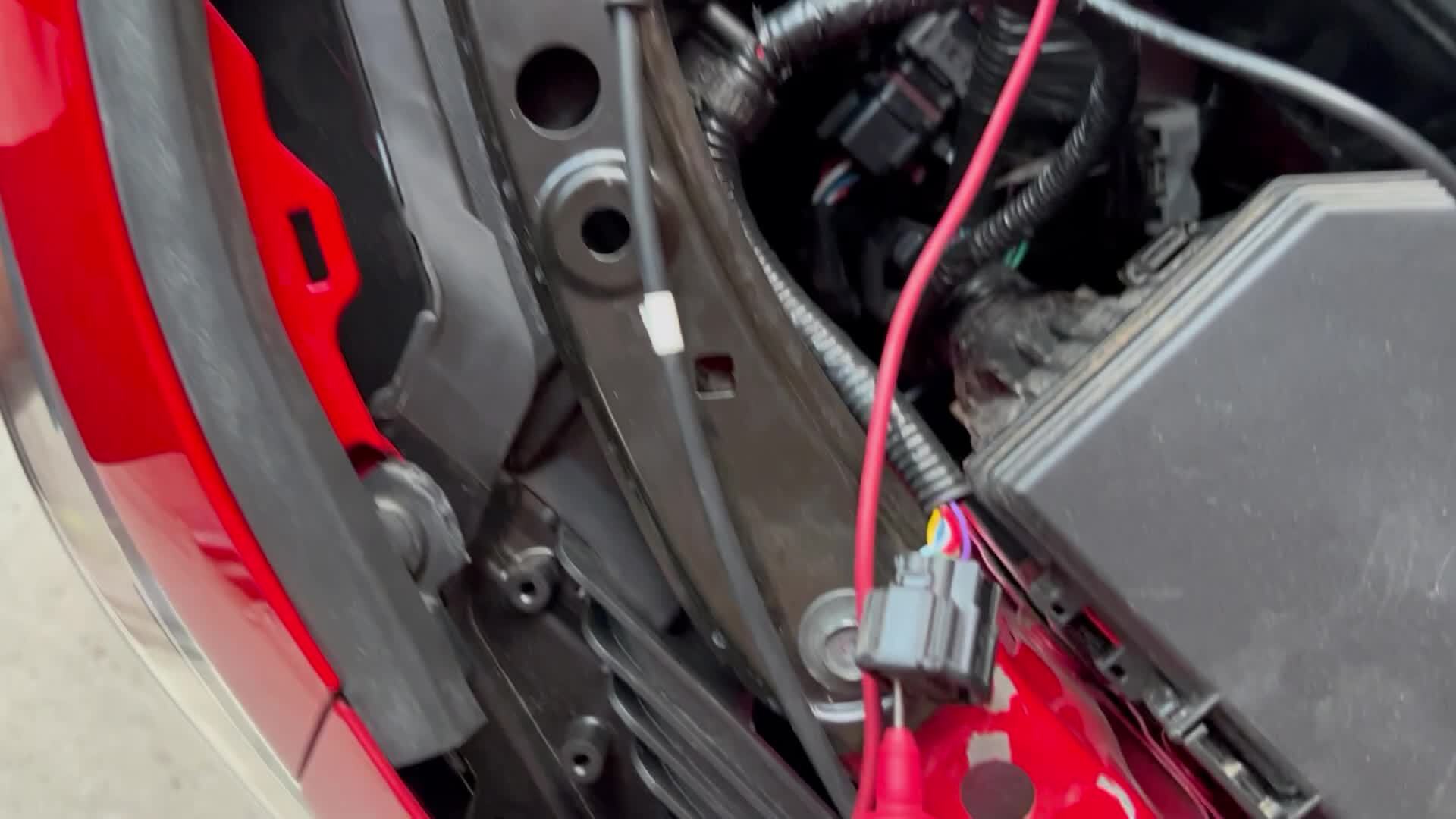

ELIMAK
  • 17 POSTS

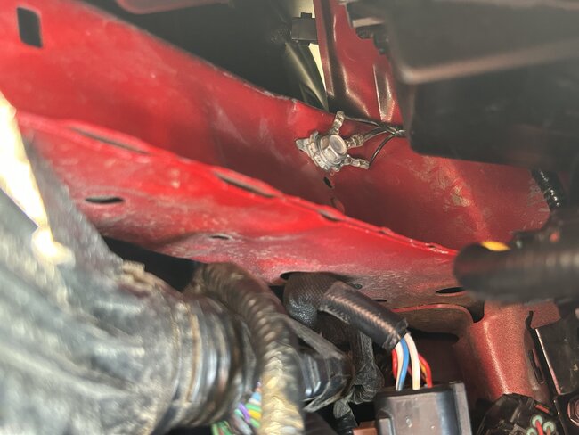

I’m not sure which ground wire you wanted me to check but this one on the left side looks intact.

ELIMAK
  • 17 POSTS
If it is headlight, I would change it out to OEM no problem, but I’m hesitant because when I plug in the right headlight which is OEM to the left side connector it does exactly what the aftermarket headlight does as in the video I just sent. When I plug the aftermarket headlight into the right connector it works as it should.

  • 110,248 POSTS
The grounds appear good, but I noticed there is damage to the sheet metal where they are bolted. Try turning the signal on and move those wires around to see if anything allows the light to work.

ELIMAK
  • 17 POSTS
