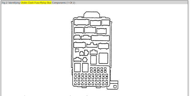

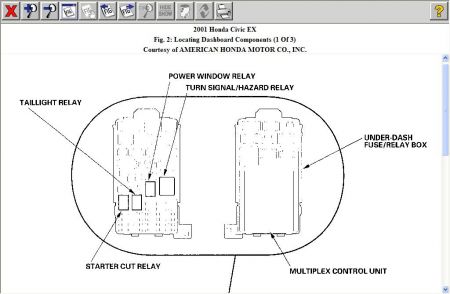

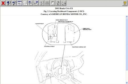

KHLOW2008
  • 41,814 POSTS
Hi acadian, It is the Turn signal/Hazard relay.
https://images.2carpros.com/forum/automotive_pictures/192750_Fusebox01CivicDash02_1.jpg
https://images.2carpros.com/forum/automotive_pictures/192750_Fusebox01CivicDash01_1.jpg

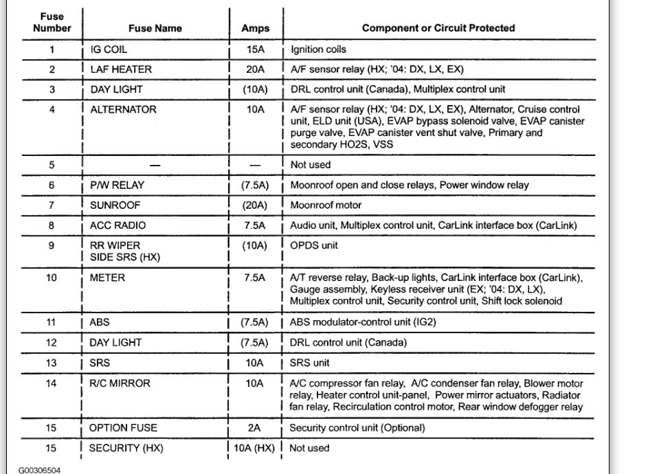

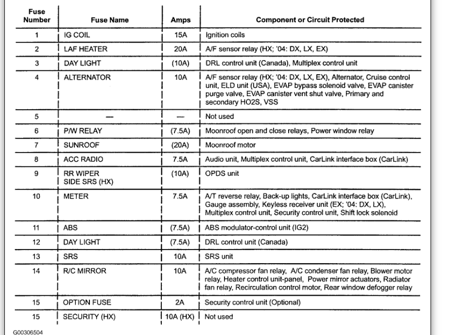

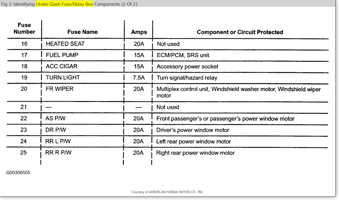

Yes it could be the flasher/hazard relay. Or it could be fuse #2 or #5 in the under hood fuse box. Here is a guide to help test the fuse and the fuse and flasher location below.
Check out the diagrams (Below). Please let us know what you find.

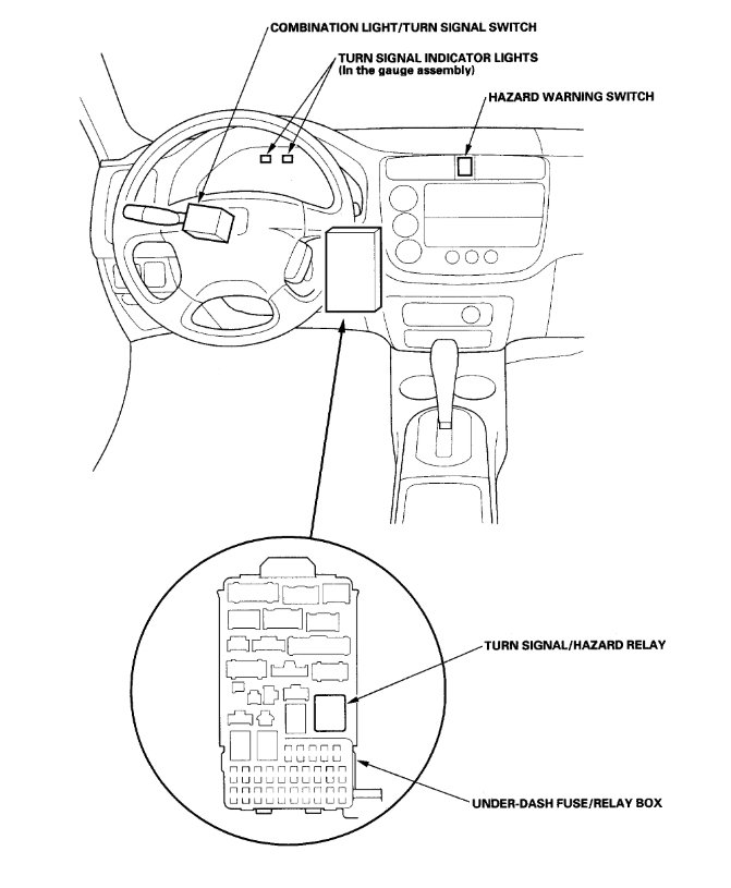

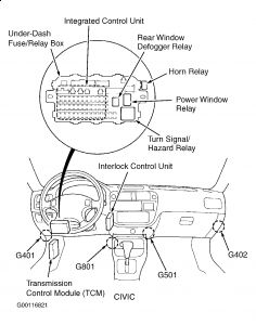

BLUELIGHTNIN6
  • 16,542 POSTS
I would suspect a faulty turn signal / hazard relay. The hazards and turn signals both run off of the same relay. It is located behind the left side of the dash, on front of the underdash fuse/relay box.
