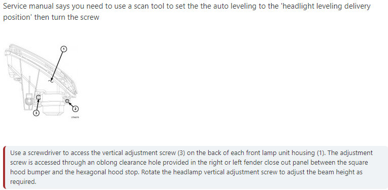

Hi qv238300,
They are correct, and not. Check the pic below on what I found. I have no idea what happens if you don't use a scan tool for adjustments, but likely the 'auto adjusting' will try to fix any adjustments made. But, short story is, they can be adjusted.

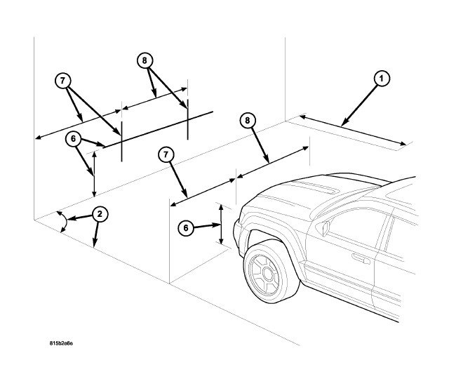

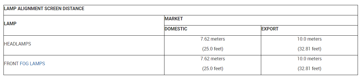

LAMP ALIGNMENT SCREEN PREPARATION
pic 1
The procedure that follows will prepare a suitable front lamp alignment screen.

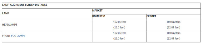

Tape a line on a level floor at the appropriate distance away from and parallel to the flat wall that will be used as the lamp alignment screen. Refer to the Lamp Alignment Screen Distance table for the appropriate measurement. The level floor will be used as the horizontal zero reference.
An adjacent wall or floor member that is perpendicular to the alignment screen can be used as the vertical zero reference. If there is no adjacent wall or floor member that is perpendicular to the screen, tape a second line on the floor perpendicular to both the alignment screen and the first line, and outboard of either side of where the vehicle will be positioned. This will be used as the vertical zero reference.
Position the vehicle so that the side of the vehicle is parallel to the vertical zero reference, and so that the front of the lamp lenses are in the vertical plane of the parallel line taped on the floor in Step 1.
Rock the vehicle side-to-side three times to allow the suspension to stabilize.
Jounce the front suspension three times by pushing downward on the front bumper and releasing.
Measure the distance between the optical center of one of the lamps being aimed (head or fog) and the floor (horizontal zero reference). Transfer this measurement to the alignment screen with a piece of tape placed horizontally to the floor. This line will be used as the lamp horizontal reference.
Measure the distance between the vertical zero reference and the optical center of the nearest lamp being aimed (head or fog). Transfer this measurement to the alignment screen with a piece of tape placed vertically across the appropriate (head or fog) lamp horizontal reference. This is the centerline reference for the first lamp.
Measure the distance on center between the first and the second lamp being aimed. Transfer this measurement to the alignment screen with a second piece of tape placed vertically across the appropriate (head or fog) lamp horizontal reference. This is the centerline reference for the second lamp.
Pic 2
HEADLAMP ALIGNMENT
NOTE:
Vehicles equipped with the optional High Intensity Discharge (HID) headlamps include an automatic headlamp leveling feature, which uses axle sensor inputs to the Automatic Headlamp Leveling Module (AHLM) to automatically adjust the headlamp level to compensate for changes in vehicle cargo or passenger load. This feature must be disabled in order to successfully perform a manual headlamp alignment. Follow the steps outlined in the diagnostic scan tool under the AHLM Electronic Control Unit (ECU) Actuator menu item for HEADLIGHT LEVELING POSITION. The Actuator must be set to the DELIVERY POSITION during manual headlamp alignment, then remain in DELIVERY POSITION once adjustment is completed.

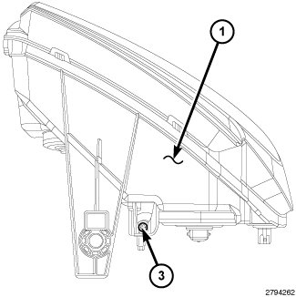

pic 3
Halogen

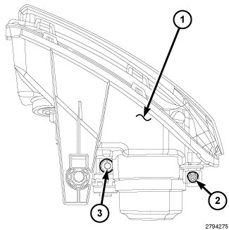

pic 4
NOTE:
Due to the linear nature of the headlamp cutoff, a properly aimed low beam headlamp will project the top edge of the high intensity pattern on the alignment screen from the horizontal line to 50 millimeters (2 inches) below the horizontal line for domestic market vehicles, or to 104 millimeters (4.125 inches) below the horizontal line for export market vehicles. No horizontal (right/left) adjustment is required for this headlamp beam pattern in domestic market vehicles. Export market vehicles have a second horizontal (right/left) adjustment screw (2) provided. The high beam pattern will be correct when the low beams are properly aimed.
Turn the headlamps ON and select the LOW beams for vehicles in all markets except Japan. Vehicles for the Japanese market should have the headlamp HIGH beams selected.
Use a screwdriver to access the vertical adjustment screw (3) on the back of each front lamp unit housing (1). The adjustment screw is accessed through an oblong clearance hole provided in the right or left fender close out panel between the square hood bumper and the hexagonal hood stop. Rotate the headlamp vertical adjustment screw to adjust the beam height as required.
For export markets only, use a screwdriver to rotate the headlamp horizontal adjustment screw (2) on the back of each front lamp unit housing to adjust the beam horizontally to the right or left as required.

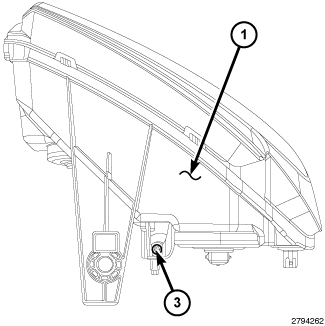

Thank you for your response. I have two more questions. First, it sounds like my vehicle needs to be connected to a diagnostic scan tool so the automatic headlight leveling function can be turned off prior to any manual headlight adjustment. Does this mean I need to go to a dealer to have this service performed? Second, the adjustment screw located down in the oblong access hole, my vehicle has no such adjustment screw. On my vehicle there is nothing down in that hole. The dealer says there is no adjustment screw because vehicles with the automatic headlight leveling system are not adjustable. If the adjustment screw is not down inside the access hole, where might it be located?
Mar 12, 2021 at 3:23 AM
  • 110,248 POSTS
According to the manual, that is where it should be located. No other location is indicated. As far as the scan tool, you will need to find someone that has a scanner that can perform this function.
