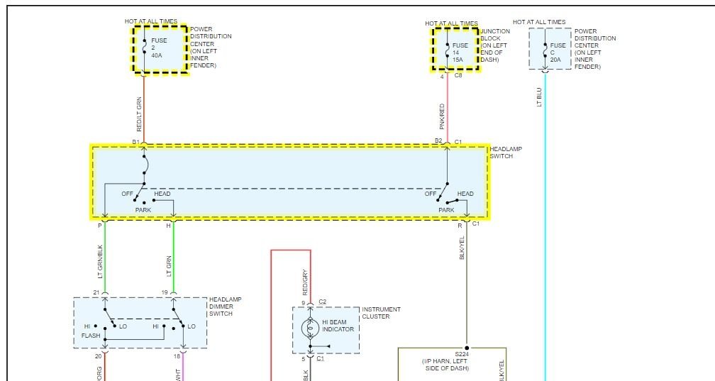

The headlights on my vehicle do not work. I have changed the turn signal/wiper/brights switch and that didn't work. what else can I do or check to get them to work?
Jan 10, 2010 at 5:50 AM
JDL
  • 16,098 POSTS
Welcome, when you changed out the multi function switch, did you happen to check any wiring circuits? Check fuse 2-- 40 amp, under hood power distribution center, use a test-lite, the circuit should be hot all the time.
https://images.2carpros.com/forum/automotive_pictures/170934_durango_headlamps_1.jpg
The violet wire is low beam voltage, the other is high beam, and black is ground.

Did you replace or check the headlight switch itself?
Feb 24, 2020 at 5:26 PM

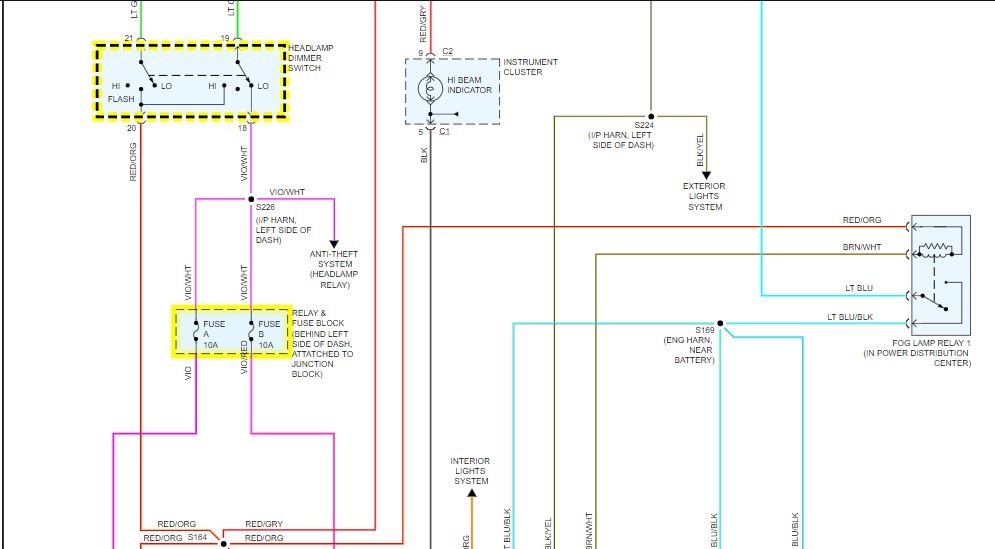

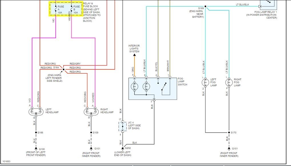

Good morning,
I also attached a diagram for you to view. There are individual fuses for each headlight under the dash in the fuse panel. Check those fuses for power with a test light.
